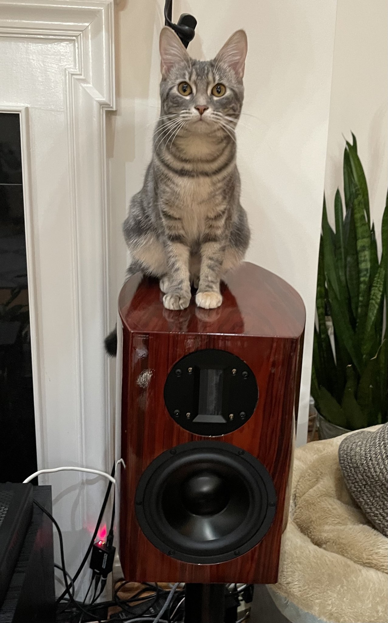

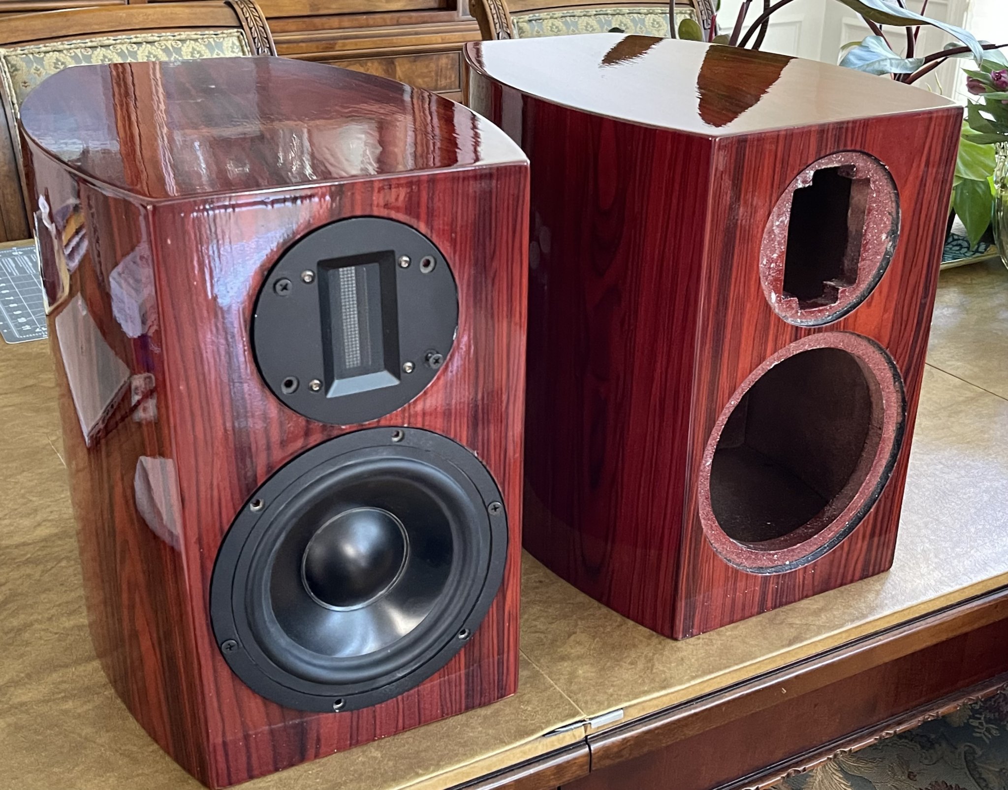

My lab assistant has doubled in size since this photo was taken. 🙂No, I did not design the Signature 10. However, I am working on the Signature 100. It will have a ribbon tweeter and a 6.5in XBL licensed aluminum woofer. There is a racetrack shaped passive radiator on the back. The theoretical crossover work is coming along and is starting to take shape.

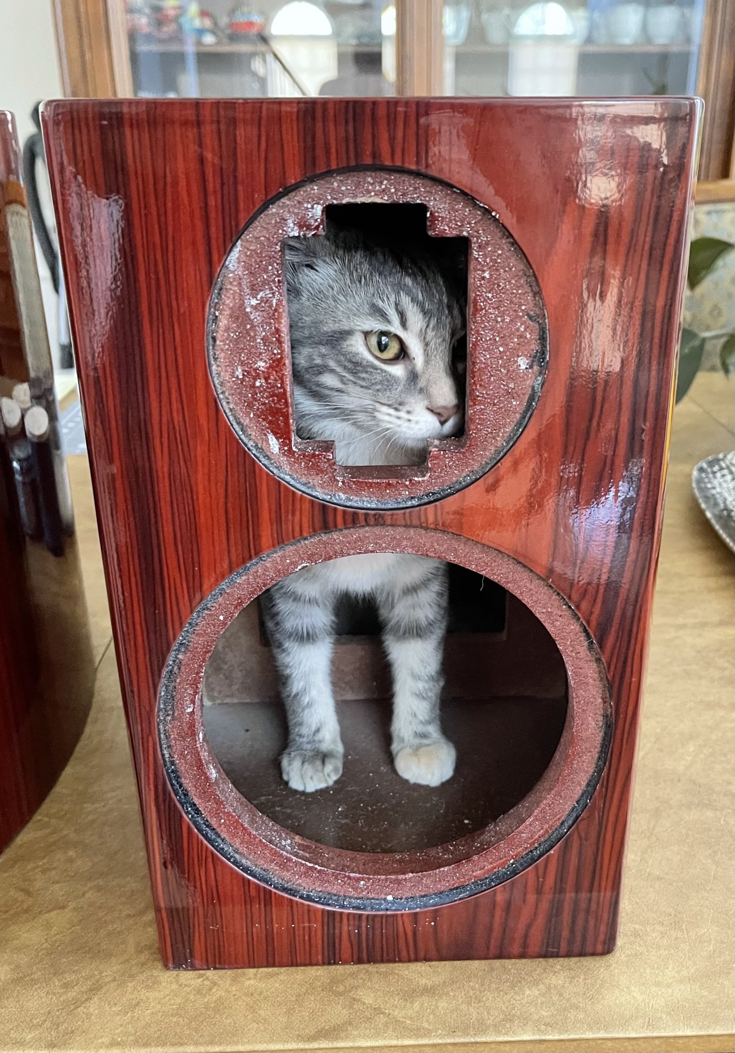

My lab assistant, is busy inspecting the cabinet and suggests we replace the ribbon with the Cat’s Meow tweeter which sounds much more organic and natural. 🙂

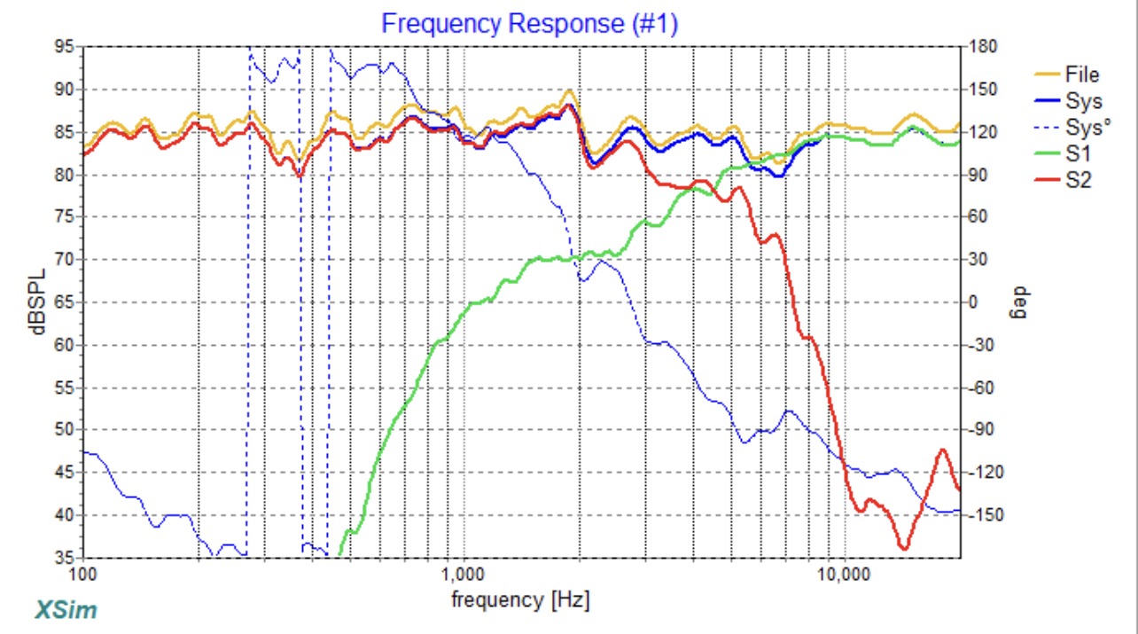

Danny also doesn’t have it right in saying that the predicted response was from an infinite baffle measurement that doesn’t account for the cabinet. The predicted response was from the measured raw response in the cabinet which includes baffle step and diffraction effects and driver offset. You can’t design a good crossover without actually measuring the in-cabinet response. Below is the measured response (yellow) overlaid with the predicted response (blue) and they match almost perfectly except for a slight offset. I probably should have done that from the start but generally, my predicted response and measured responses are identical.

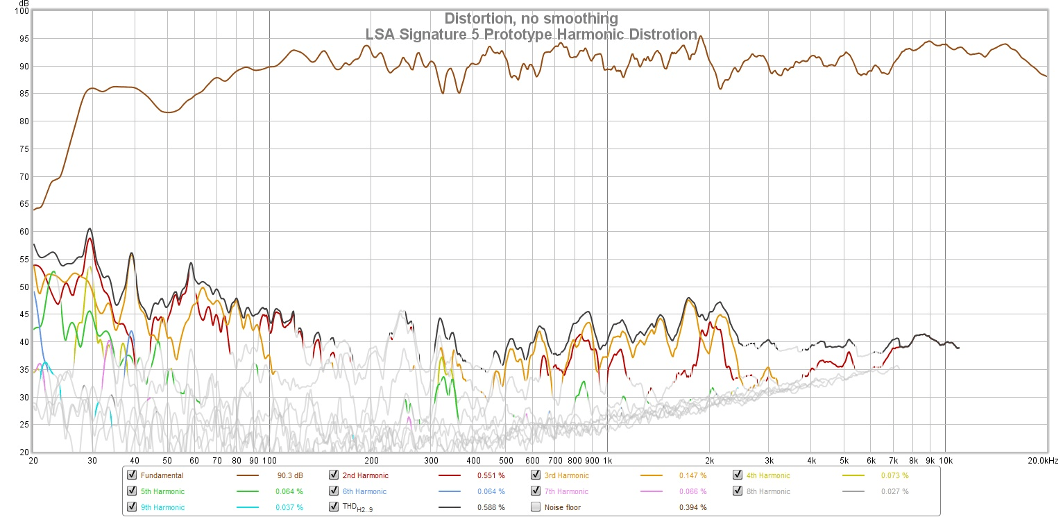

And here is the measured distortion. If there was a bad resonance at 1.9kHz like Danny saw, it was not on the speaker I worked with. Sometimes, this can be caused by a rattle in the driver basket or loose screw.
