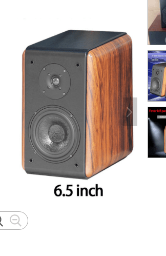

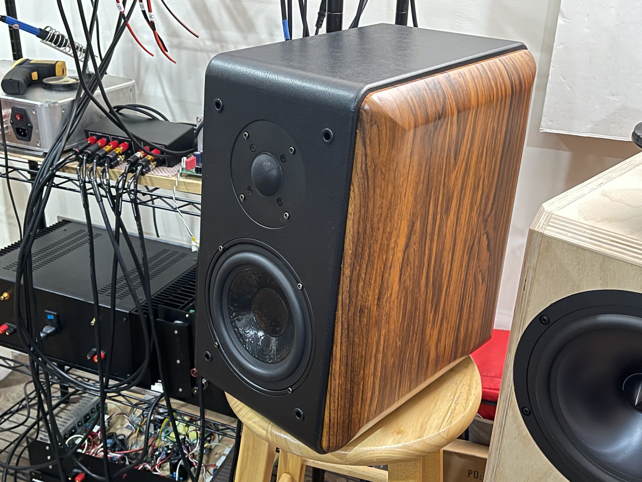

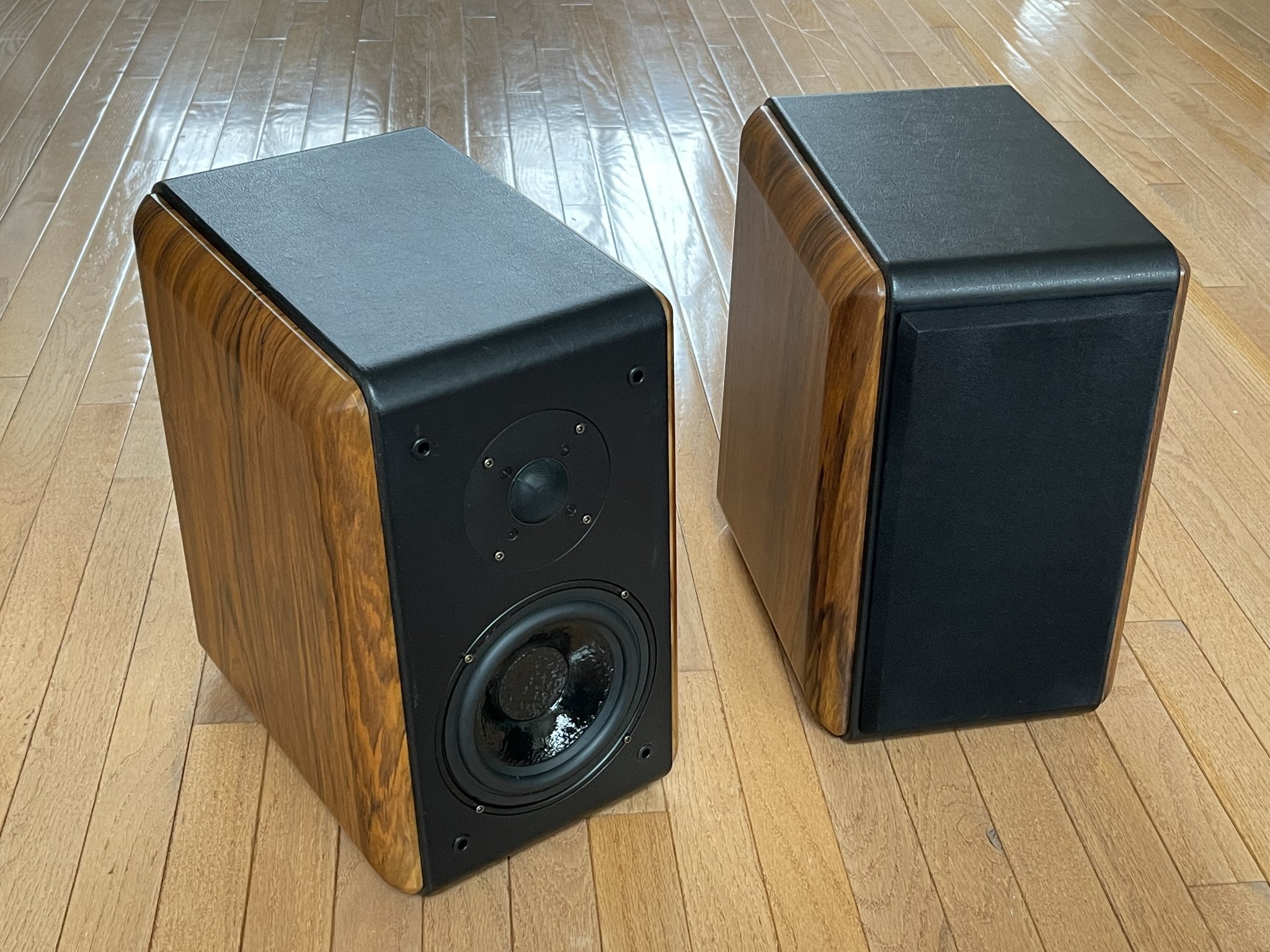

Are these cabinets the same as thrones found on Aliexpress etc?I designed the Signature 50 speaker for LSA quite a few months back but it’s finally starting to roll off the assembly line and will be shipping soon.
It’s a 6.5in 2-way bass reflex that uses a premium 28mm silk dome tweeter, and I gave details of some of the measurements earlier in the What’s on the Bench Tonight thread.

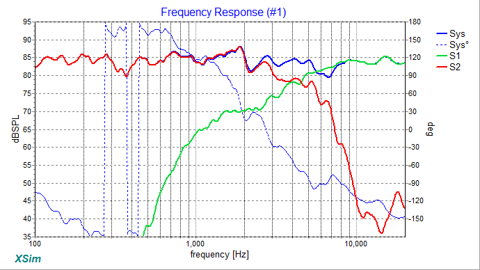

Predicted response of crossover:

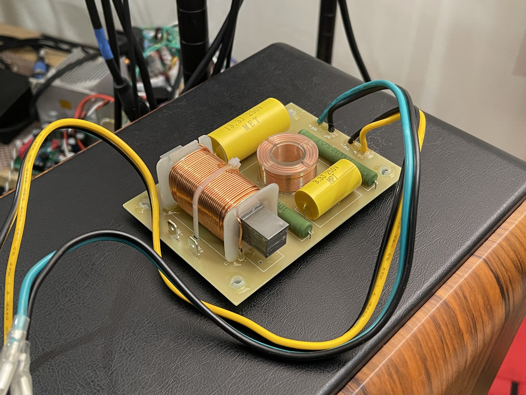

Custom crossover uses inverted passive Harsch topology of my design. All high quality parts like pure copper wire inductors, and custom made film caps and non inductive wire wound resistors:

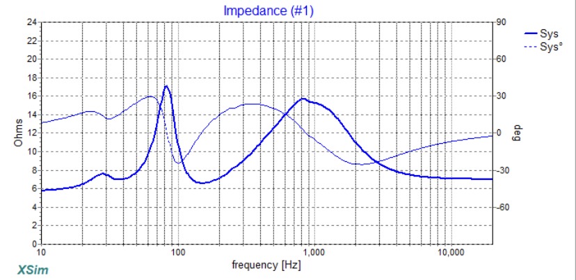

Impedance as function of frequency shows a true 8ohm speaker with lowest dip at 6.5 ohms above 20Hz:

Hi, mine were nice, not a high end leather but a nice grained, look great with the grills off - same size room, with them close to wall and one in a corner. The bass is awesome, I listed to music without a lot of bass so I really like the sound as it kinda "eq ed" my sound to exactly what I wanted, much better than expected.
I do recommend a long burn in, I let mine play for a few weeks before really sitting to listen. The treble was the only issue based on my system, music. When A/B'd with others the 50's had a rolled back high but that was less fatiguing and I tend to like detailed highs but this really hit a sweet spot for me. I run them with mono block Schiit Aegirs, Schiit Freya + preamp. CD through Denafrips Ares II dac....I have a ton of speakers ( my weakness) I found them so good that If my only pair I'd be happy, I do have the new 80s which I haven't tried yet but bought on the recommendation that they are a step up, same designer ( thank you) and I also have a LSA Warp one class D amp that I A/B'd at length against the Aegirs mono blocked and surprise it was very difficult to hear a difference. Again the same designer and I'm very happy. Stopped my endless gear quest...If I had a wish it would be for the warp ones to able to Monoblock and a way to disable the led when on as I leave them on all the time. Perfect match for the speakers, most any speaker really.

Never heard of thrones? But these cabs were made for LSA.Are these cabinets the same as thrones found on Aliexpress etc?

Sorry thrones 🙂 the ones I saw on Ali and Newbecca looked similar. I assume the sides are real wood..Never heard of thrones? But these cabs were made for LSA.
That does look similar. The cabinet is MDF based and finished with a covering. Tough to have real solid wood for $499.
Is it a vinyl type wood grain or a thin wood veneer. I assume the black surface is a nice grade vinyl? Saw they went up $100 on their website.That does look similar. The cabinet is MDF based and finished with a covering. Tough to have real solid wood for $499.
The cost is so reasonable buying direct from Walter, I would go to him rather than taking a chance that it's the same.
Only the LSA Signature 50 from Underwood HiFi will have been designed by me with my crossover and driver selections. A speaker from another company may have a similar looking cabinet and finish, but will not not be the same speaker with an inverted Harsch transient perfect passive crossover and optimized components.
Agreed the knock off will be just that. I assume that is where the cabinets were sourced are they assembled there as well. Did you have any input into the Signature 10 line?

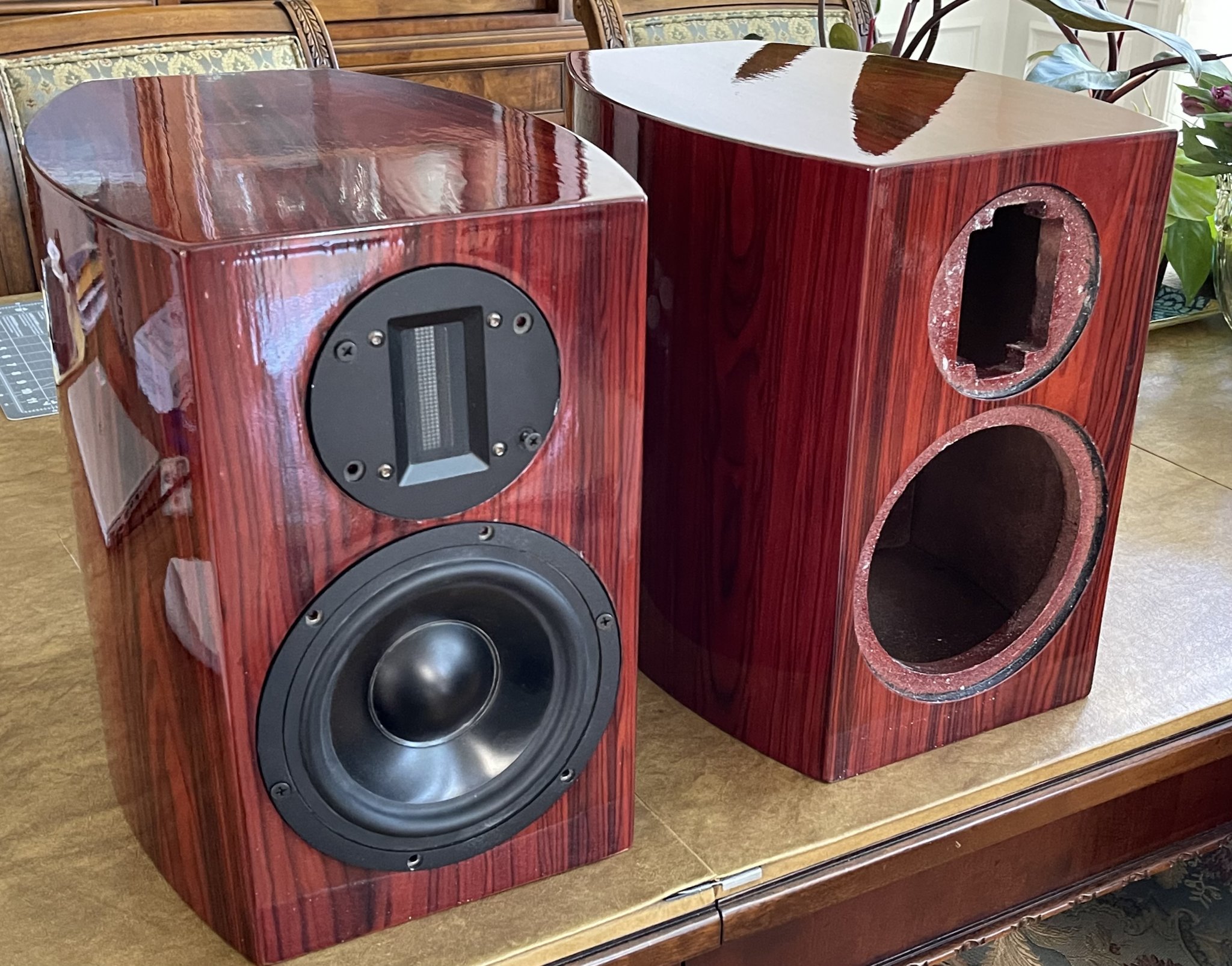

No, I did not design the Signature 10. However, I am working on the Signature 100. It will have a ribbon tweeter and a 6.5in XBL licensed aluminum woofer. There is a racetrack shaped passive radiator on the back. The theoretical crossover work is coming along and is starting to take shape.
My lab assistant, is busy inspecting the cabinet and suggests we replace the ribbon with the Cat’s Meow tweeter which sounds much more organic and natural. 🙂
