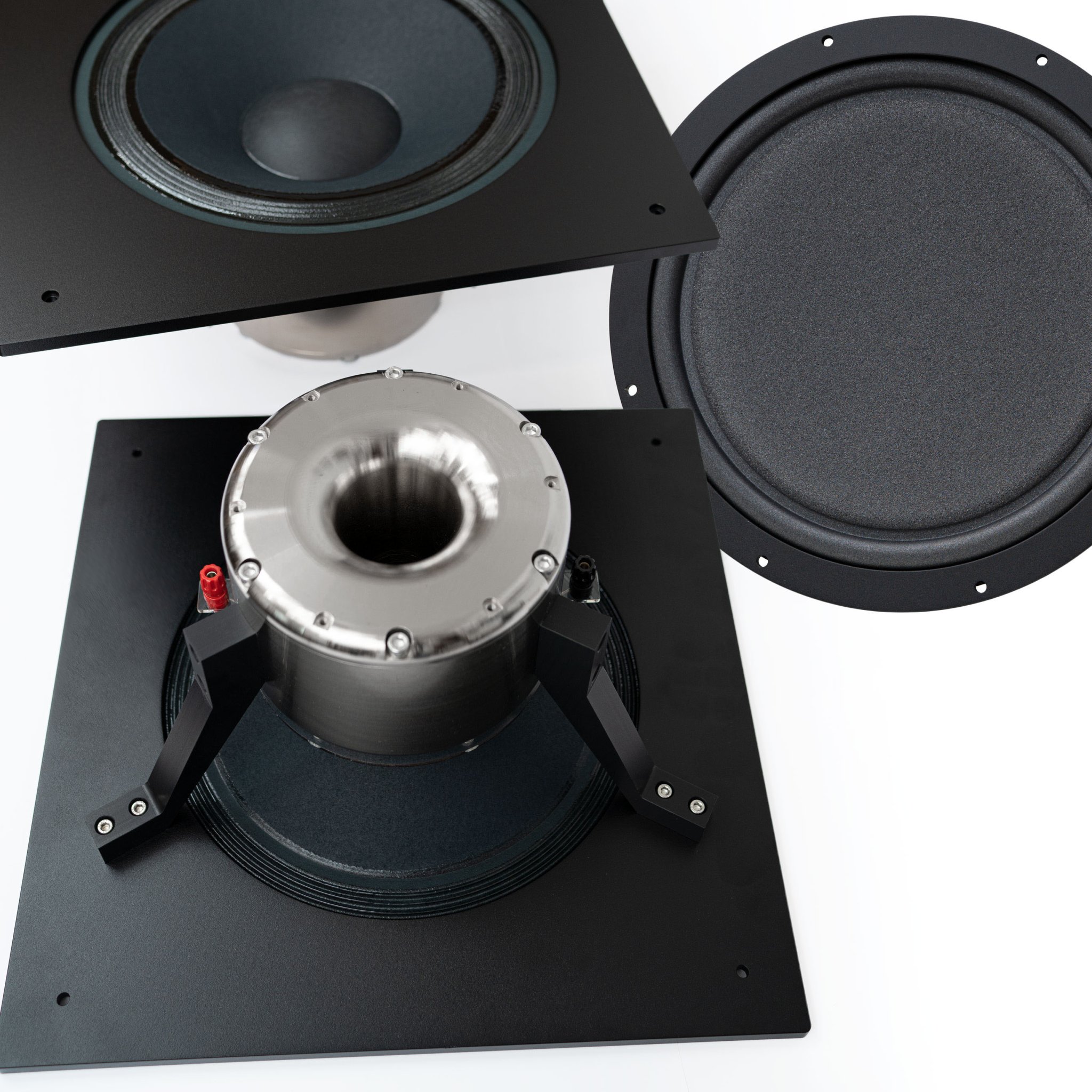

George, I am working with a friend to produce an article for AudioXpress.Jan, I would love to see your measurements on a dedicated thread.
Field coil allows the adjustment of load line on the (de)magnetisation curve and this topic has not seen a lot of analysis and measurements (at least not published).
George
We haven't looked at a loadline yet, not sure how we would do that?
One other thing we see (expected) is that with increasing field power input, efficiency goes up and the T/S parameters also change.
Qts and Qes and Bl (of course) increase with field power.
Going from 10W to 20W changes efficiency from 1.8% to 2.5%.
Jan

Interesting stuff, looking forward to your findings.Coincidently, I am on a project doing measurements on a field coil driver.
The most outstanding parameter is the very low distortion, on a par with an ESL.
I wonder whether the mere replacement of the permanent magnet with an electromagnet could have that effect, or whether there are other mechanisms at work?
I would think with a well-designed magnetic circuit and the field coil driven with constant current and the gap saturated even at high VC currents the motor distortion, notably BL(i), should be excellent.
But even with a non-saturated gap the magnetic circuit might be stiffer than with a pre-polarized magnet.
To check whether the gap is saturated you could plot mid-band SPL vs. FC current at constant VC voltage. When SPL stops to rise BL his maxing out, indicating saturation.

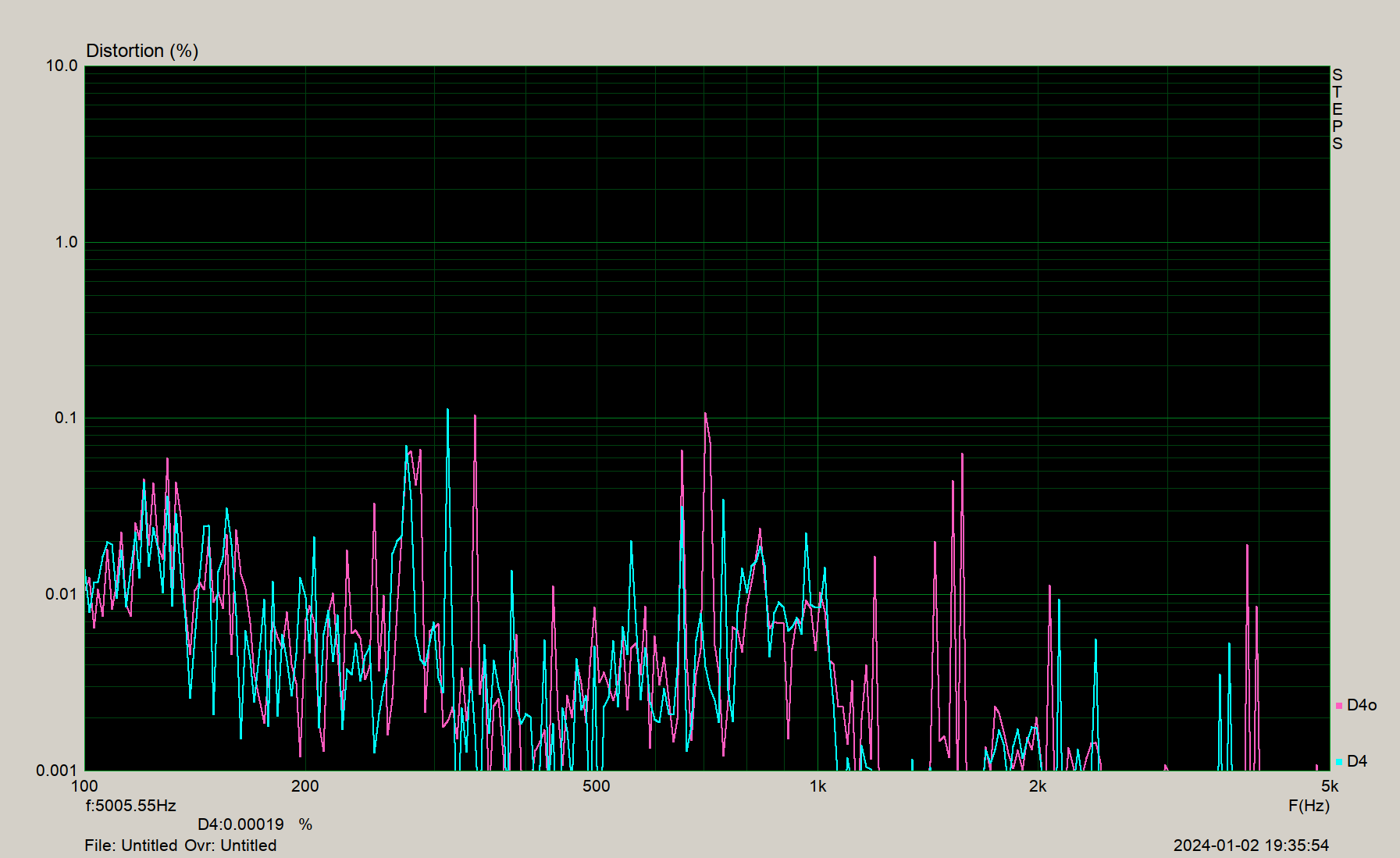

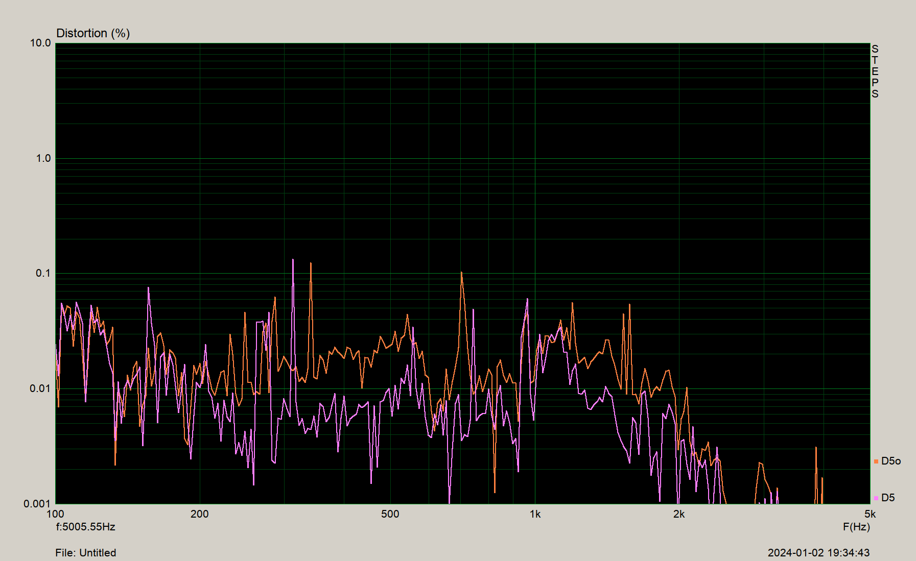

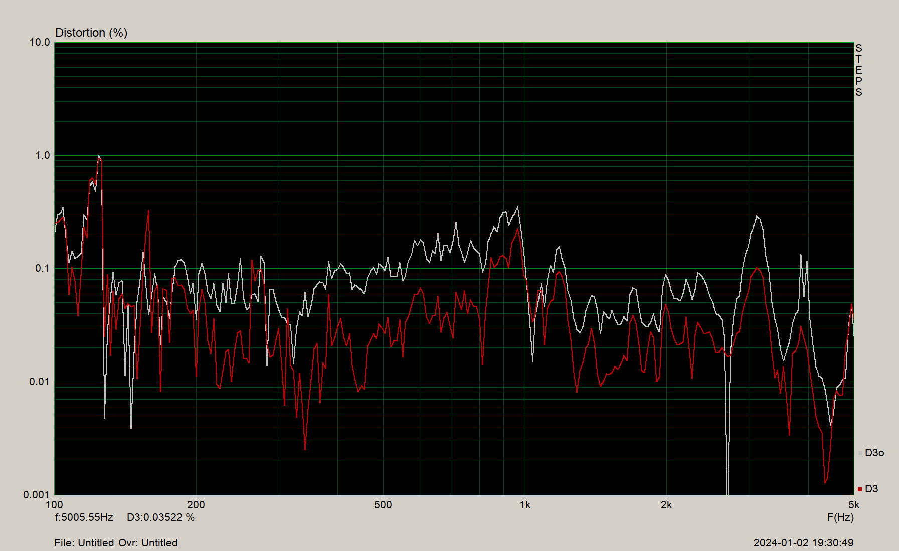

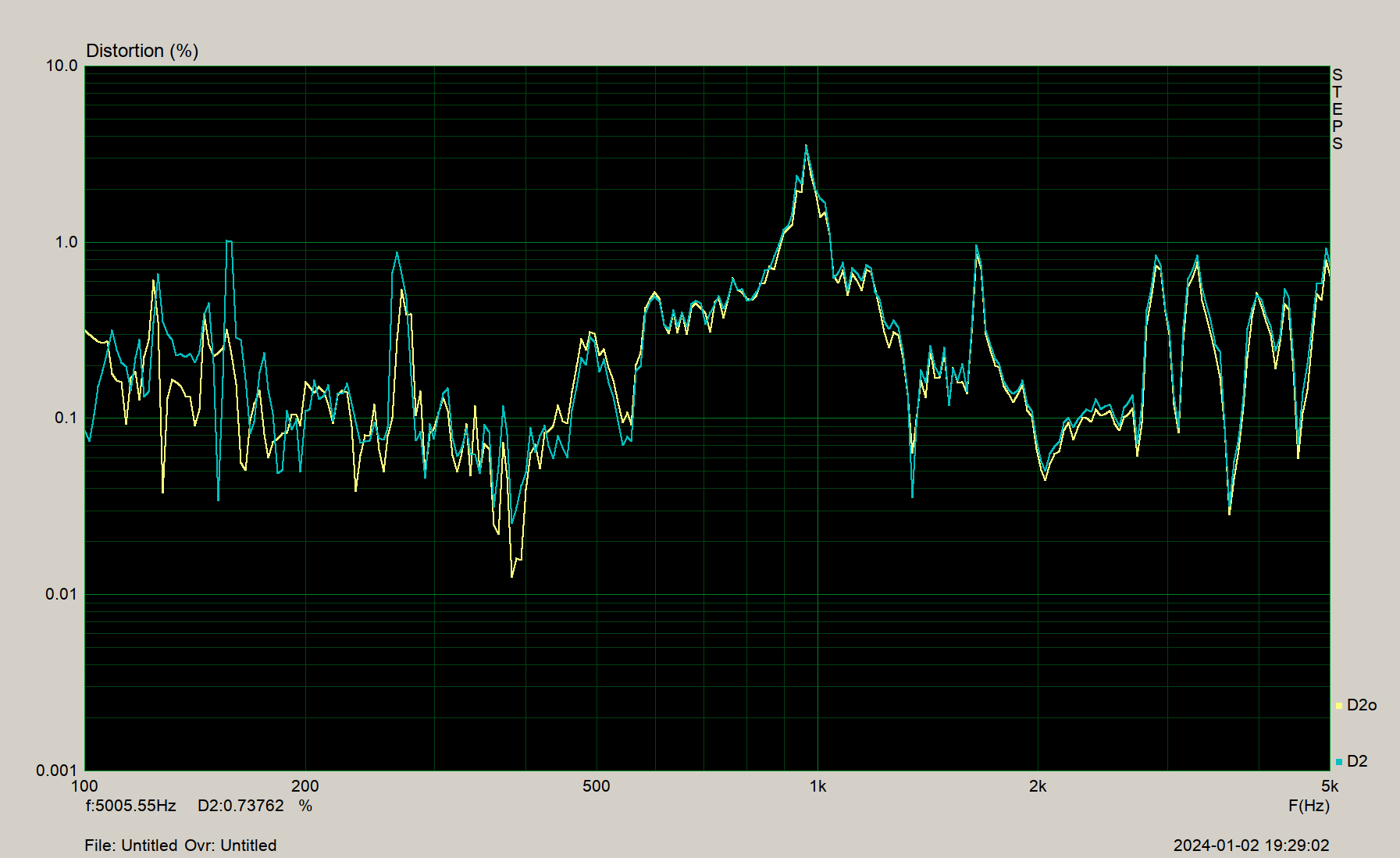

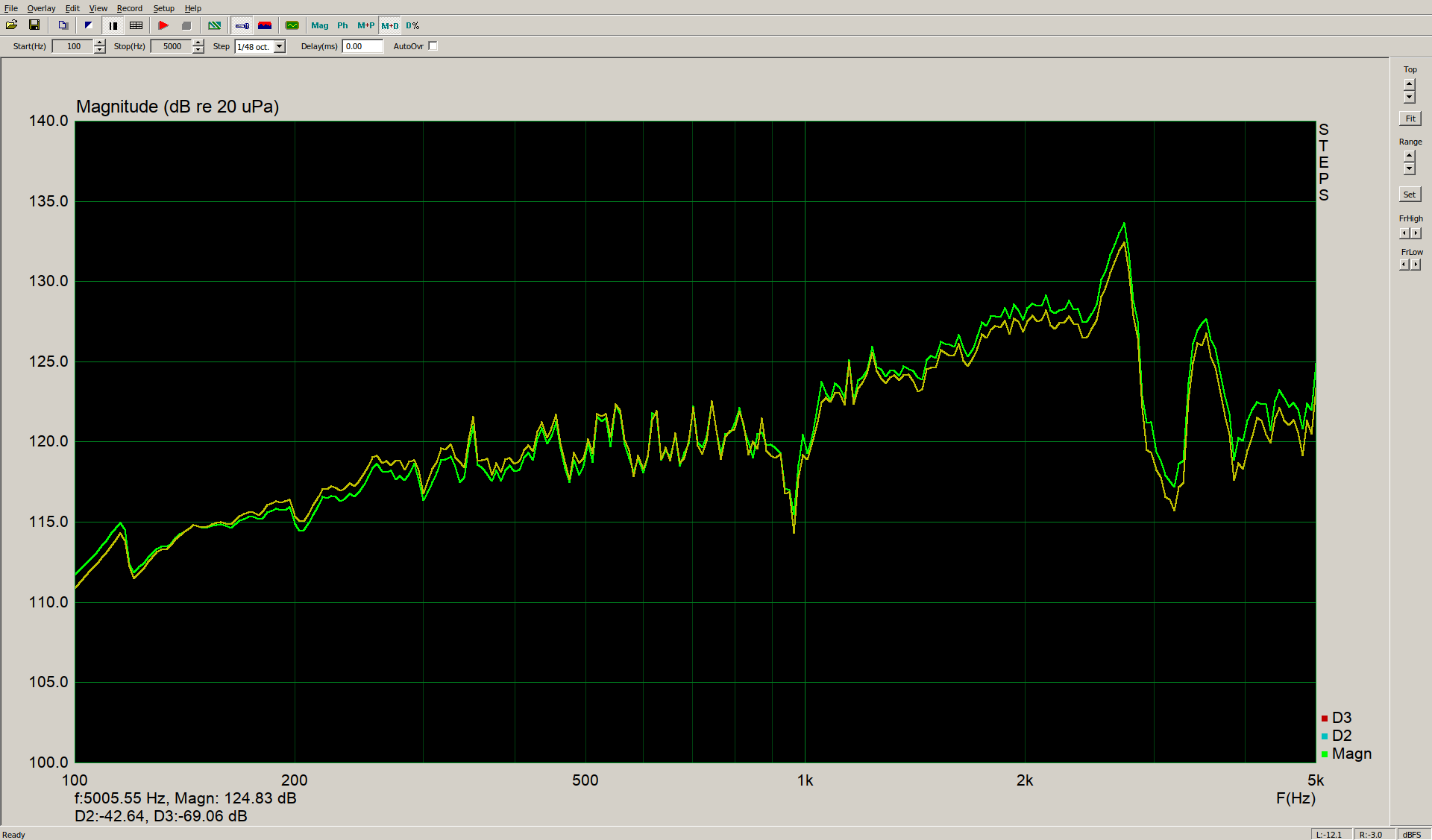

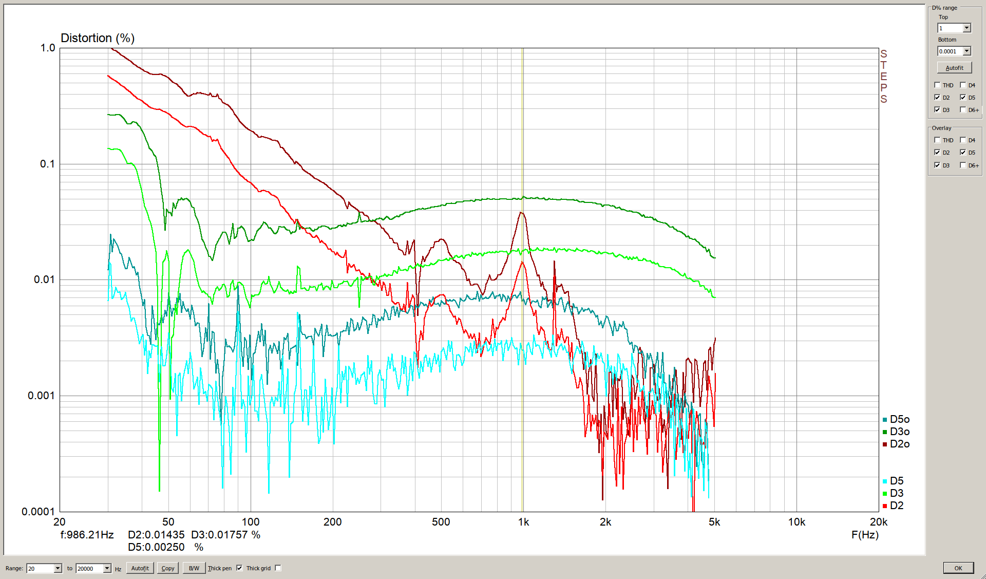

yellow: without series resistance at 2.8V (measured at 50hz)
green: with 20R in series. Level adjusted according to SPL. No EQ - just volume.
orange: D5 without series resistance
pink: D5 with 20R
magenta: D4 without series resistor
cyan: D4 with 20R
light gray: D3 without series resistor
red: D3 with 20R
yellow: D2 without series resistance
light blue: D2 with 20R
dark red: D2 - in the current - without series resistance
red: D2 - in the current - with 20R
Best regards
Bernd
- LRDDMC Loudspeaker Resistor Drive Distortion Measurement Challenge
