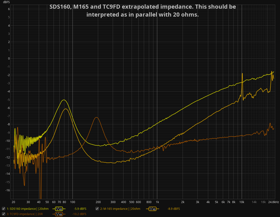

Could you post the impedance curves of both drivers, preferably in the form of an overlay?
This is as close as I can get. Clearly the TC9FD has a shorting ring.

Yes, and with an active amp emulating an inductor you can shape the response without needing to greatly increase headroom. But transitioning from voltage drive (>1ohm) at 100Hz to current drive (>20ohm) at 200Hz with a flat response is a bear of a problem to solve, and you don't get much benefit from inductance except well above Fs, at least for typical woofers like in my measurements.
You should emulate an inductor that is at least as large as Lvc. The greater the better. This would also mean that the reponse starts to drop off earlier than caused by Lvc and Re alone.. But because this is not caused by a physical series inductor it should be easy to equalise this out before the amp.

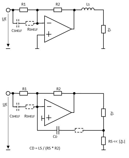

I did some tinkering and came to the conclusion that a differentiating current feedback path emulates the effect of an additional series output inductor (LS).
Here you can see how it can be used around an inverting amp:
Cshelf and Rshelf are there to compensate for the premature HF rolloff due to the inductor. Because the mutual influence of output inductor and driver impedance dips and peaks can be rather complex this is of course not sufficient by itself.
Differentiators are not per se stable in practice if they are designed to differentiate up to very high frequencies so it is advised to truncate its function up there by the insertion of a reasonably dimensioned resistor (the "dashed one").
