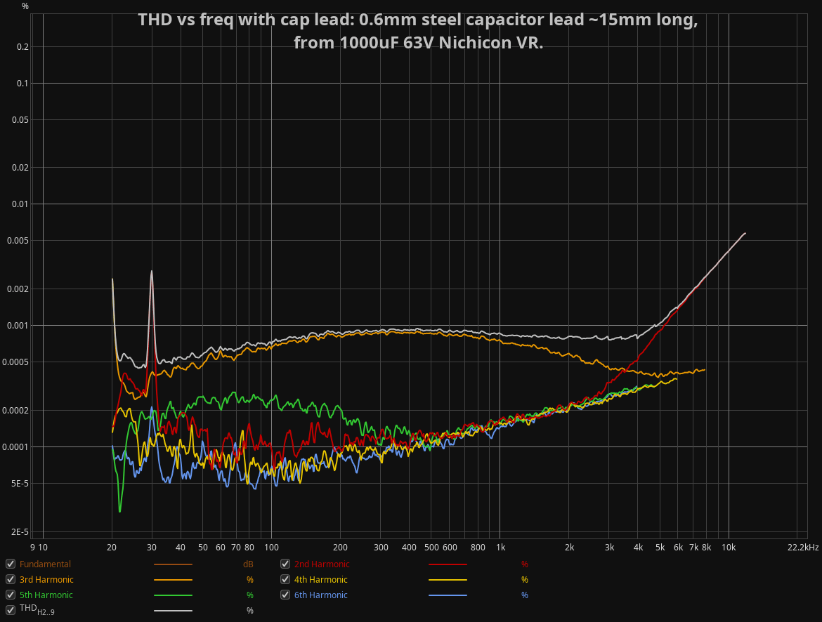

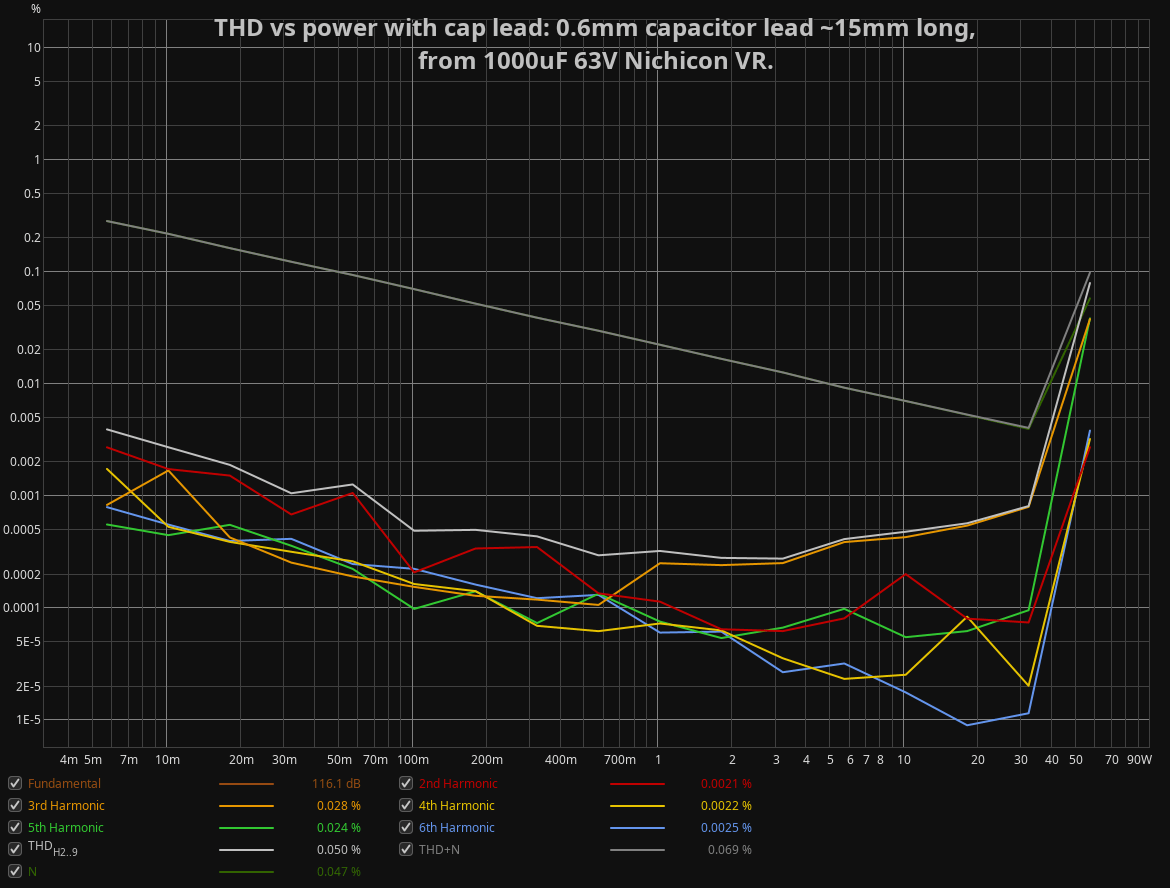

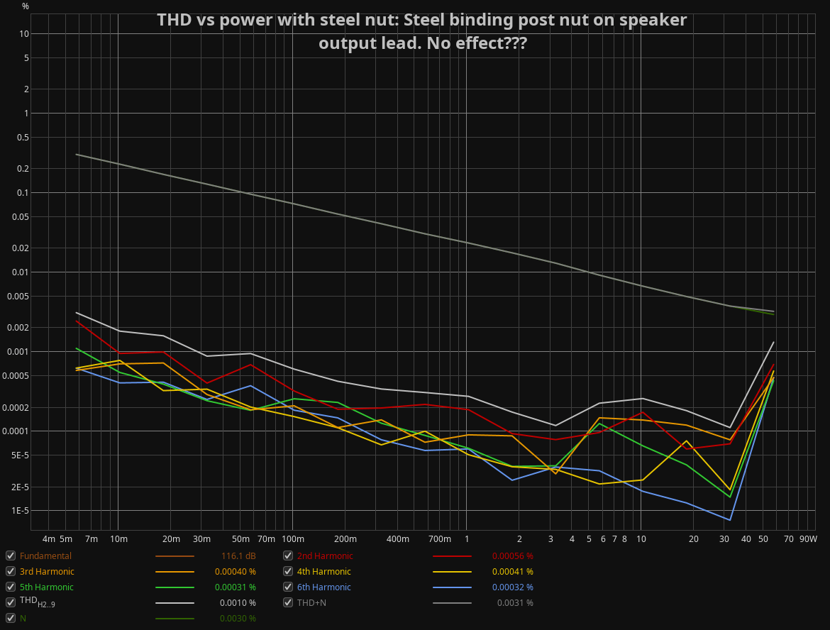

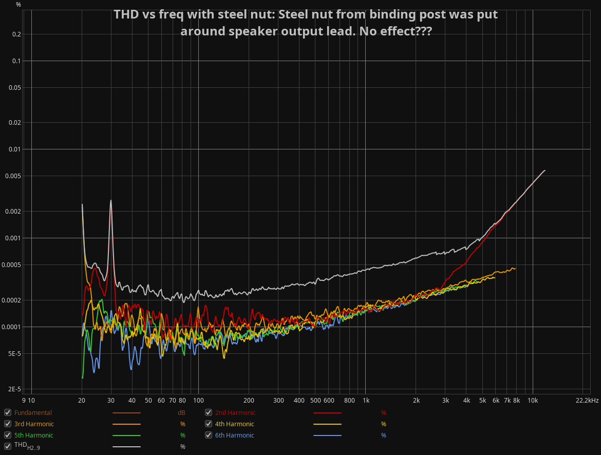

Well, I did some measurements to check on that, and this is uncanny. I was not able to measure ANY distortion from a steel nut, from a binding post, that stuck to a magnet. So to confirm my sanity I found a capacitor with steel leads and tried that again. The capacitor lead causes distortion but the binding post nut does not...

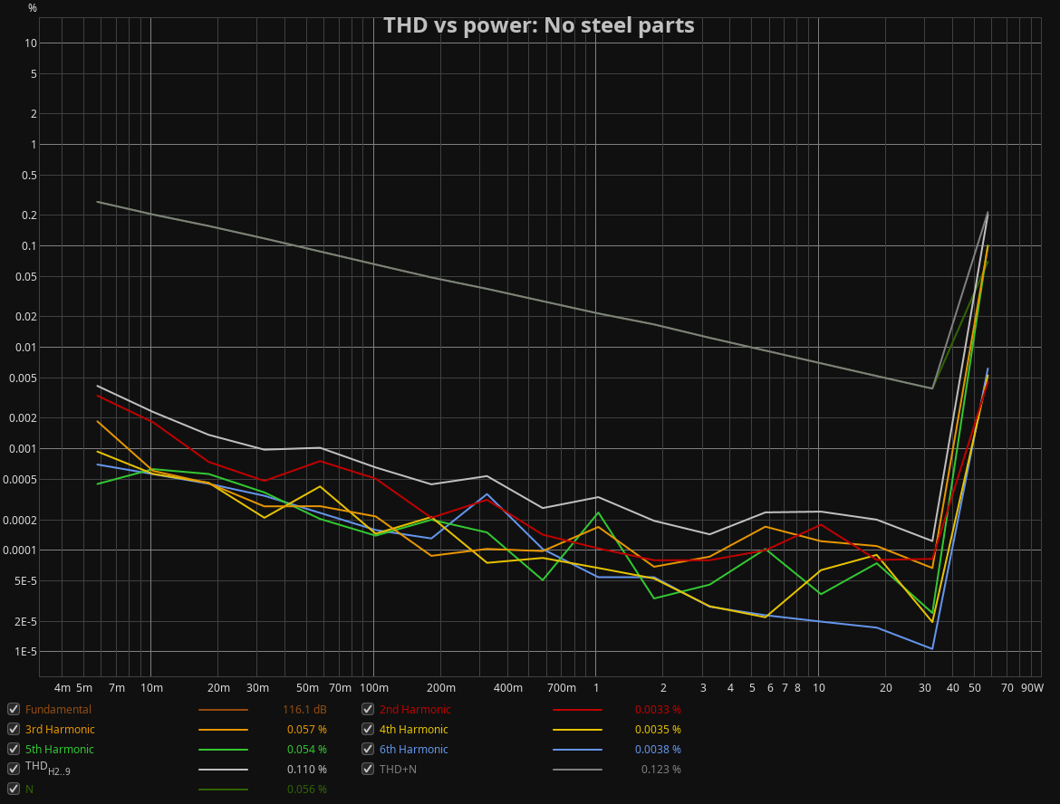

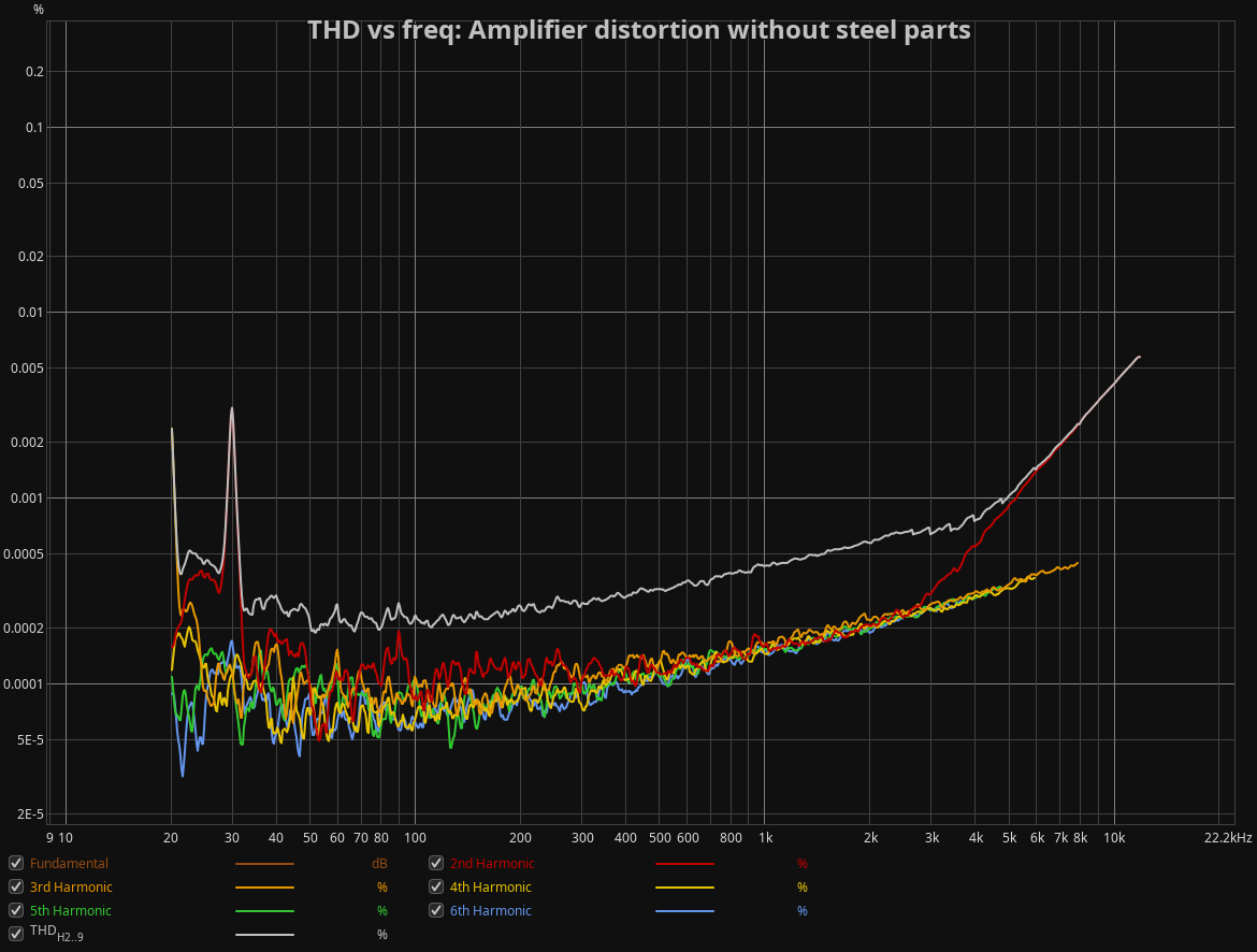

This is the same amp I used for the current drive distortion measurements. X axis is watts into the 8ohm load.
THD 1KHz vs power into 8ohms:
THD vs power no steel.pngTHD vs power with steel nut.png THD vs power with cap lead.png
THD vs frequency at 29W:
THD vs freq no steel.png THD vs freq with steel nut.png THD vs freq with cap lead.png
Notice that the 3rd harmonic for the capacitor lead starts to fall above 400Hz and the 5th harmonic vanishes into nothing. I suspect this is because the harmonic frequencies reach the point where skin effect begins to attenuate them.
All these measurements are far below the levels of distortion from speakers I showed earlier in this thread.
JUST the capacitor lead was tested, no signal was going through the capacitor.
Things seem to get complicated fast when you start passing signal through steel. I was able to measure some distortion (rising with frequency) if I passed the signal into one side of the nut and out the other, but not if I put the nut on a wire. And it was intermittent (one of my measurements had a 2nd harmonic). I could adjust the position of the alligator clips on the nut and it would be gone. I was able to measure a larger 3rd harmonic when passing through a grey steel screwdriver, but constant with frequency so it can't be a magnetic effect.
I think there are nonlinear ohmic effects when you are actually passing current into steel. The current density is high at the contact points and so the flux density will also be high, along with possible thermal effects. There could be oxides with semiconductor like effects, there can be thermal modulation at the contact points along with flux modulation.
What I'm getting from these experiments is that you should never pass current into steel, but otherwise the distortion is unmeasurable for steel nuts (at least up to 30W/8ohm). Personally I just avoid it. I know the RF world is well aware of harmonic generation from steel hardware.
