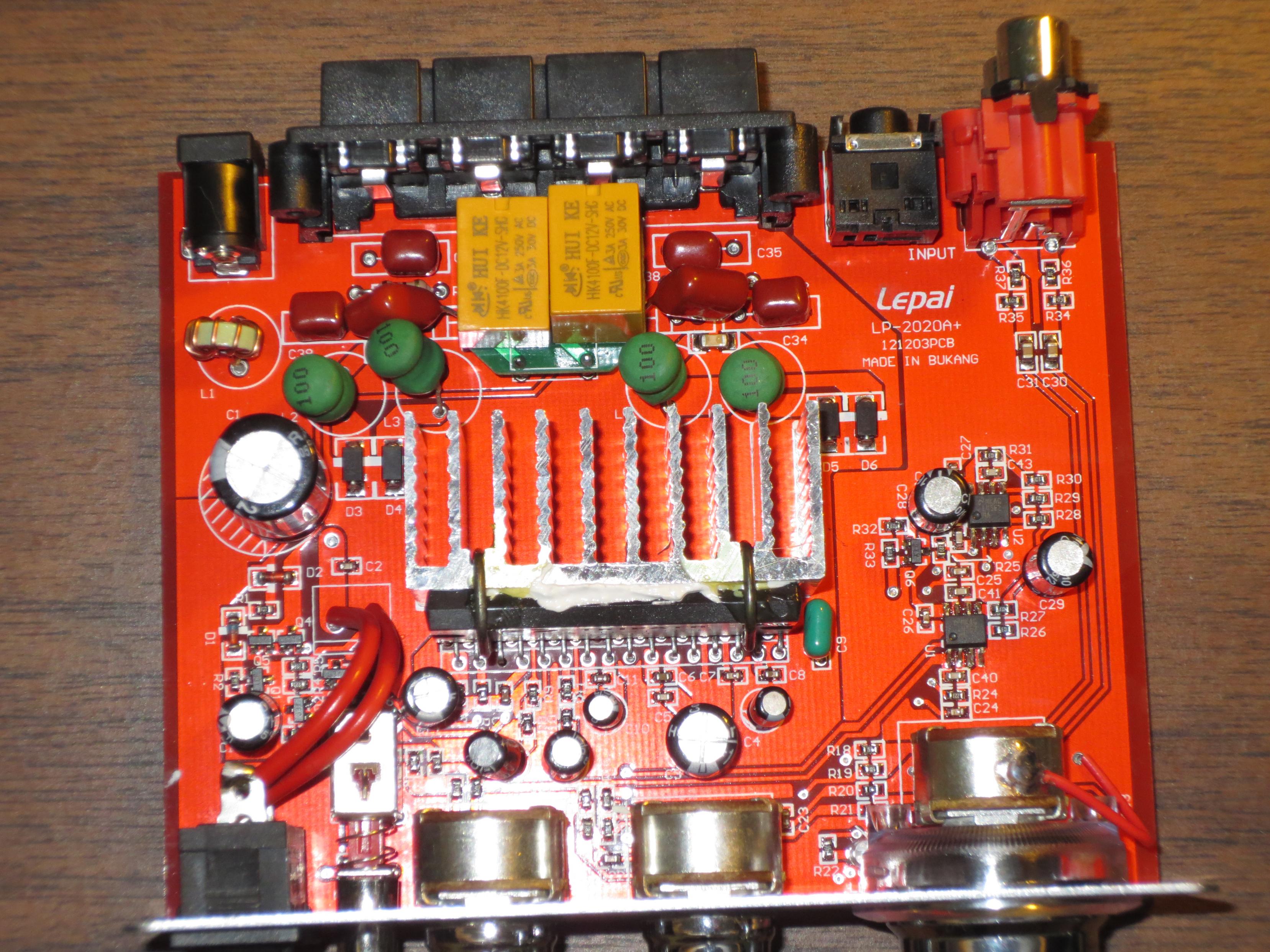

Just got my Lepai 2 days ago.. I only had some lm4562s opamps on hand. So that was my only mod so far.
The sound is MUCH cleaner... so much so... that I'm wondering if I should bypass the opamps at all since the Tone-defeat button seems to bypass the tone controls.. I think my opamps are fine. 😀
I am an expert on ghetto replacement of SMDs with total crap equipment 😛
Does anyone know if I could use REGULAR polarized capacitors for C20 and C21, because I don't have any bi-polars on hand..
Picture of my board attached, It seems they went even more cheapo on components 🙁
Look at the dinky inductors this time around...
And they went for a ghetto dual power relay 😡
--- Not sure if this portion greatly affects sound... maybe some experts could chime in...

I've been messing around with these as well. I found out the hard way that C20 & C21 can not be polarized. I made this mistake on my first mod attempt. Since then, I have learned a great deal about these things. I didn't kill my amp but it took me 3 days to figure out why it sounded like crap.
Now I have 2 lp2020a+ amps. One of them came like yours but with a single relay and the other came witg better components; they both look like salvaged parts. They will both be modded; one with all tone controls wiped, audio grade caps and ferrite core inductors all around. The other will have only upgraded caps. I'll post pics when I finish. Still waiting for parts.

You see those transistors in the Power Path?
I hate "muting" transistors in the signal path,
This irrational hatred also translates to transistors in general, because cheap ones always seem to introduce a great deal of "sssssssss--- noise"
Do you have any idea how to bypass these transistors...
Also are the opamps only necessary for tone and volume?
Hi tp4tissue
Yes the opamps are necessary for tone control and volume, If you bypass you Will loose the volume and tone control.

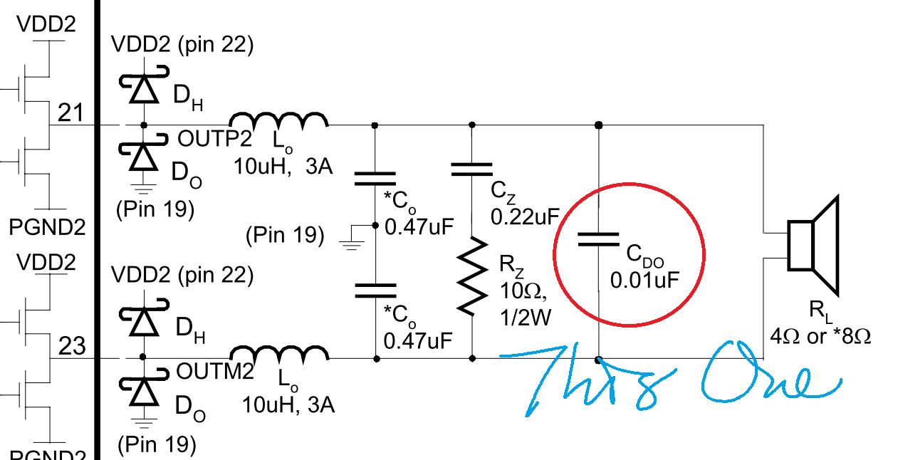

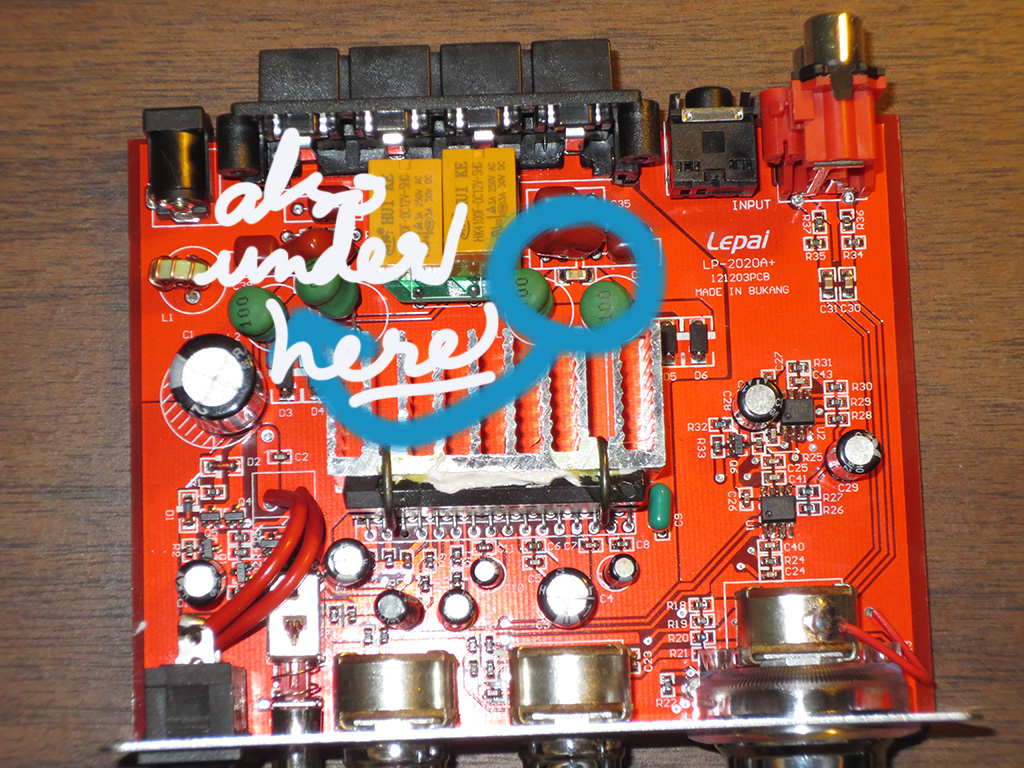

I also chose to replace the 2x .01uf bipolar ceramic Cap in the output circuit with Wimas, LOL they were only 81 cents each, so i figured, F... it
I didn't even see them until I saw the datasheet... I honestly don't trust the SMDs they put in there.. because I have some "hissssss" goin' on, I'd like to put as much good high freq noise filtering in there as possible...
You can see the 0.01uf speced caps on the data sheet.. they are right above the inductors on the lepai board😀
Picture with cap circled below'
