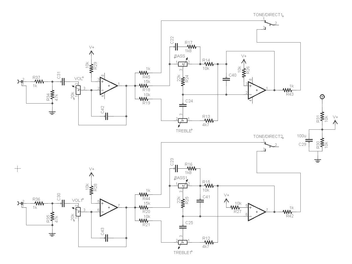

To start with, I reverse engineered the input circuit, and present it here. To follow are the mods I've done so far. In the second photo I have already begun my mods, so don't be alarmed that C20/C21 are empty.
Notice that there is a mistake in the left (lower) channel, C41 is connected to the wrong place. Compare with C40.

My second mod was to remove the volume op-amp and almost all of the components around the op-amps, and wire the volume pot as a regular attenuator.
I removed R42 and R43 (to the right of the tone/direct switch, behind the treble pot) to disconnect the tone circuit from the switch, then wired the pot to the "tone" side of the switch. Now "tone" = on, "direct" = mute. I did it this way because in order to use the "direct" side of the switch, I would have had to remove the resistors under the switch, which were too hard to get to. I grounded the one end of the volume pot to the through-hole where the ground strap for the pot is connected.
This mod also improved clarity, and gave me more useful volume control range.

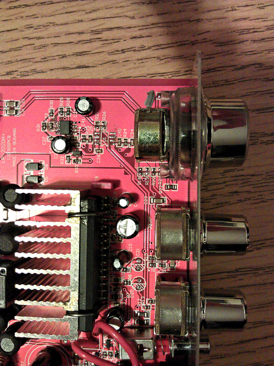

Finished most of my modding on that amp. It's hard to say if it sounds better, but I guess bypassing all that crap could help out in rare situations (high gain, etc.).
The volume pot feels way more useful now.
There is also another nice side-effect of bypassing the op-amps: The slight pop noises when turning the amp on/off are completely gone now!
Still waiting on that PSU though. I measured my old PC PSU and it only delivers 10.8V, down to 10V at high load. I guess the regulator on it doesn't like 12V rail only usage since the 5V and 3V rails look fine.

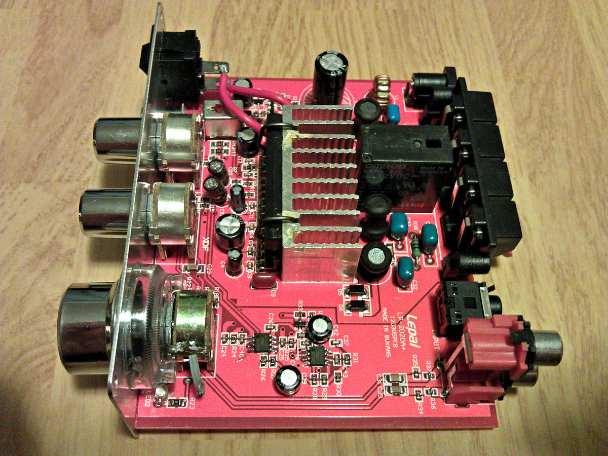

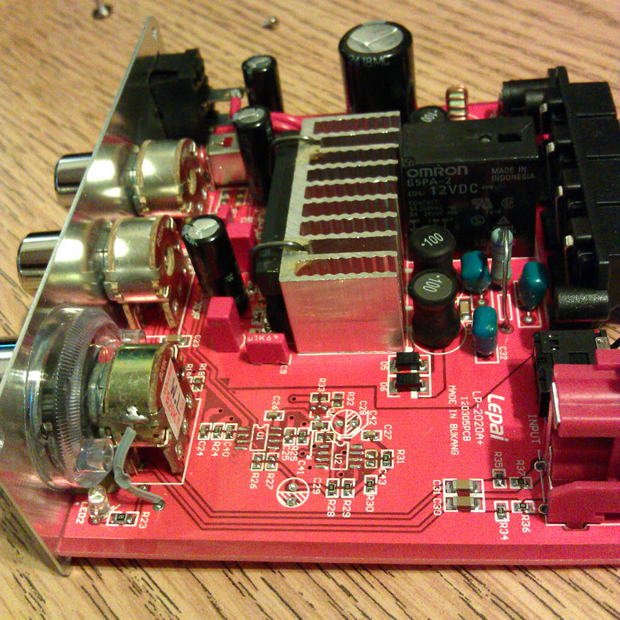

Here are some pictures of it right now:
Added a LED volt-meter so that big hole has some use at least 😉

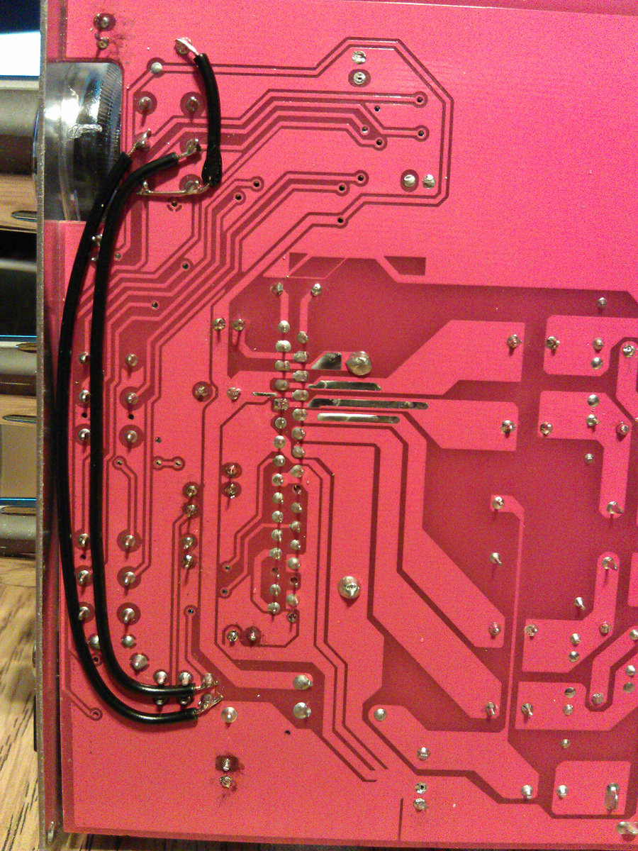

I ended up connecting the input RCA to the default ports, because I wanted to keep that 3.5mm input jack as an easy to access headphone-out. (Only put it in when I intend to use it)
But it goes straight from there over the cables to the pot and into the caps. (R36&R37 wiped off)
As input caps I am using WIMA MKS 2.2µF.
I know some people don't like them, but I am quite resistant to hifi-voodoo.
The output inductors were SMD ones, so i had to solder in 2 legs first on which i soldered the inductors.
Also wanted to replace the output caps, but after one I gave up. They are just such a PITA to replace with little to no gain compared to the inductors which can easily saturate if they can't handle the current.
So far so good 🙂

Well going to remove the op-amps then.
