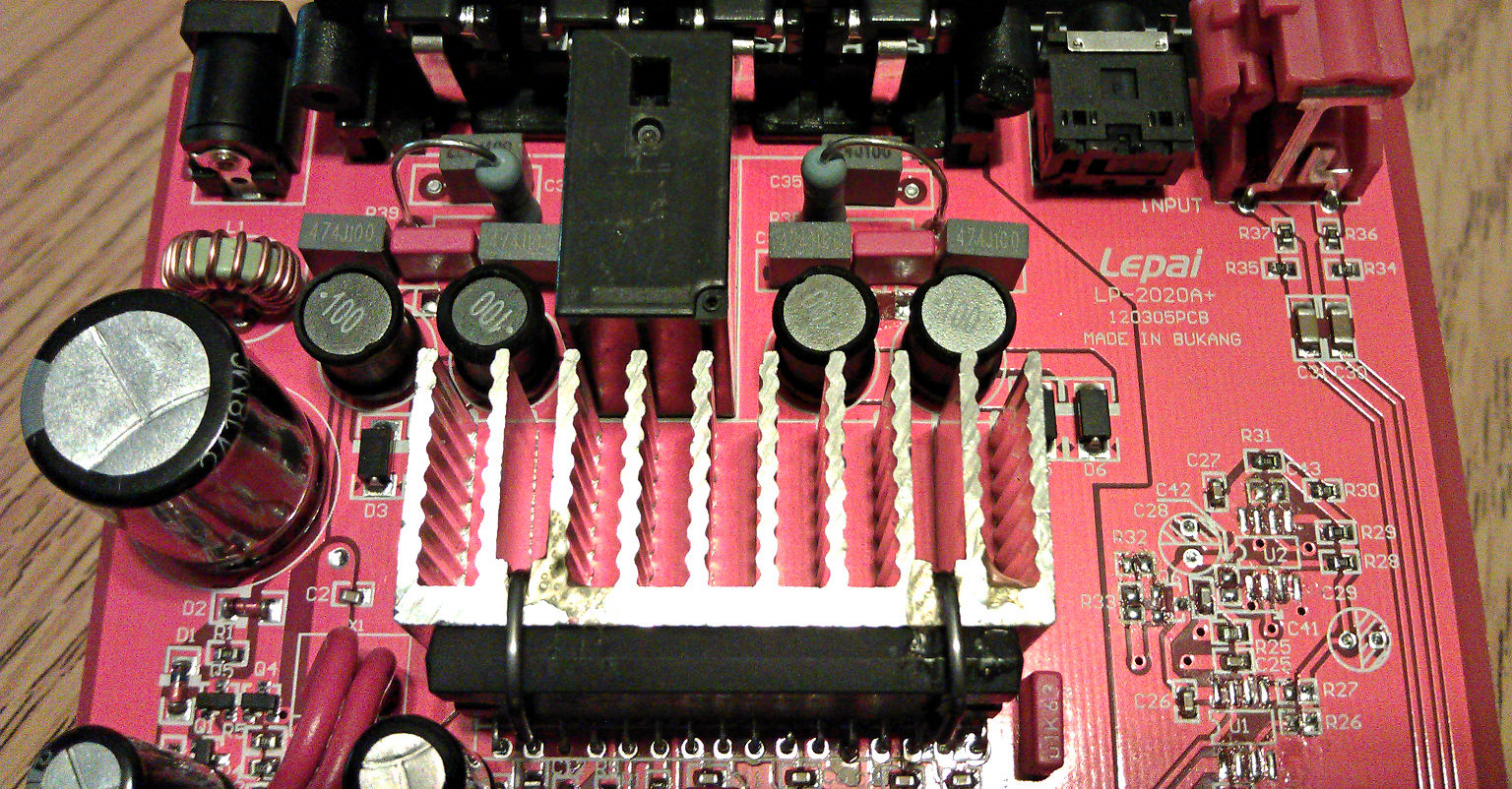

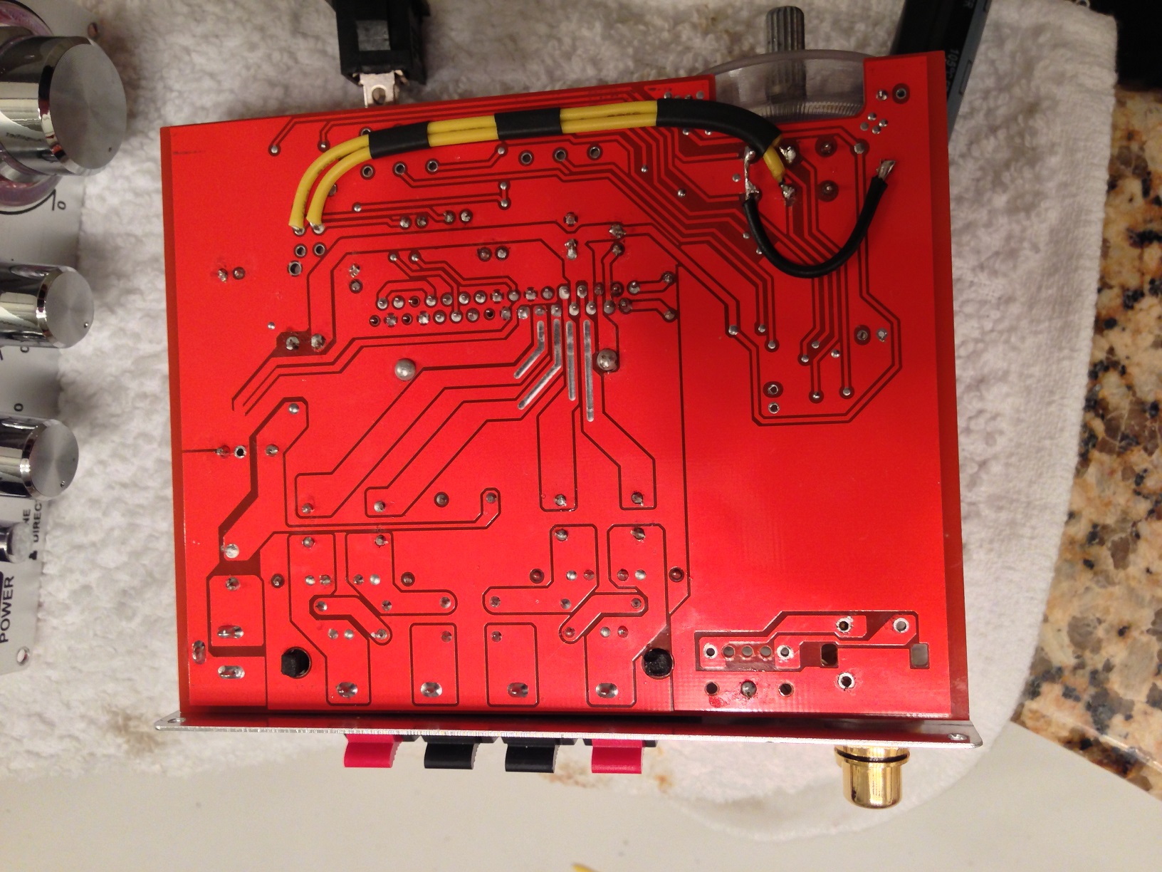

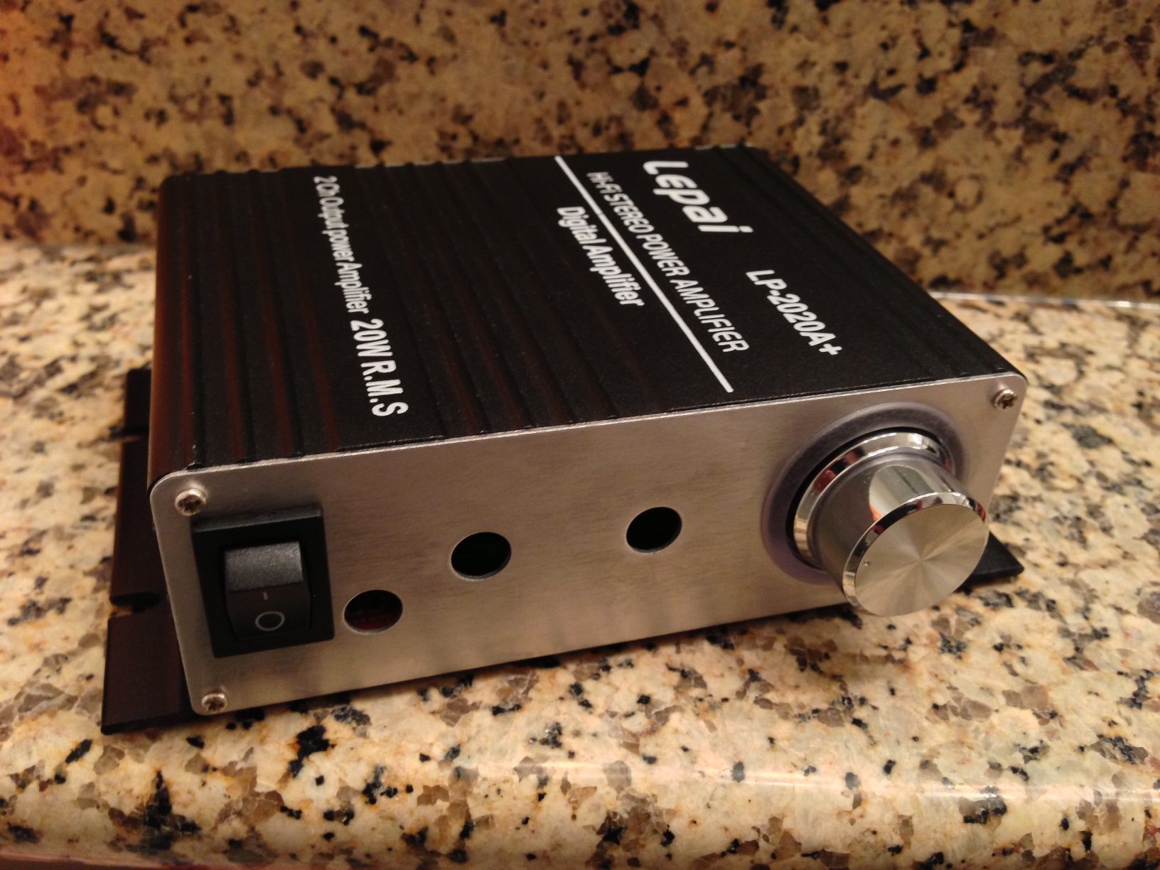

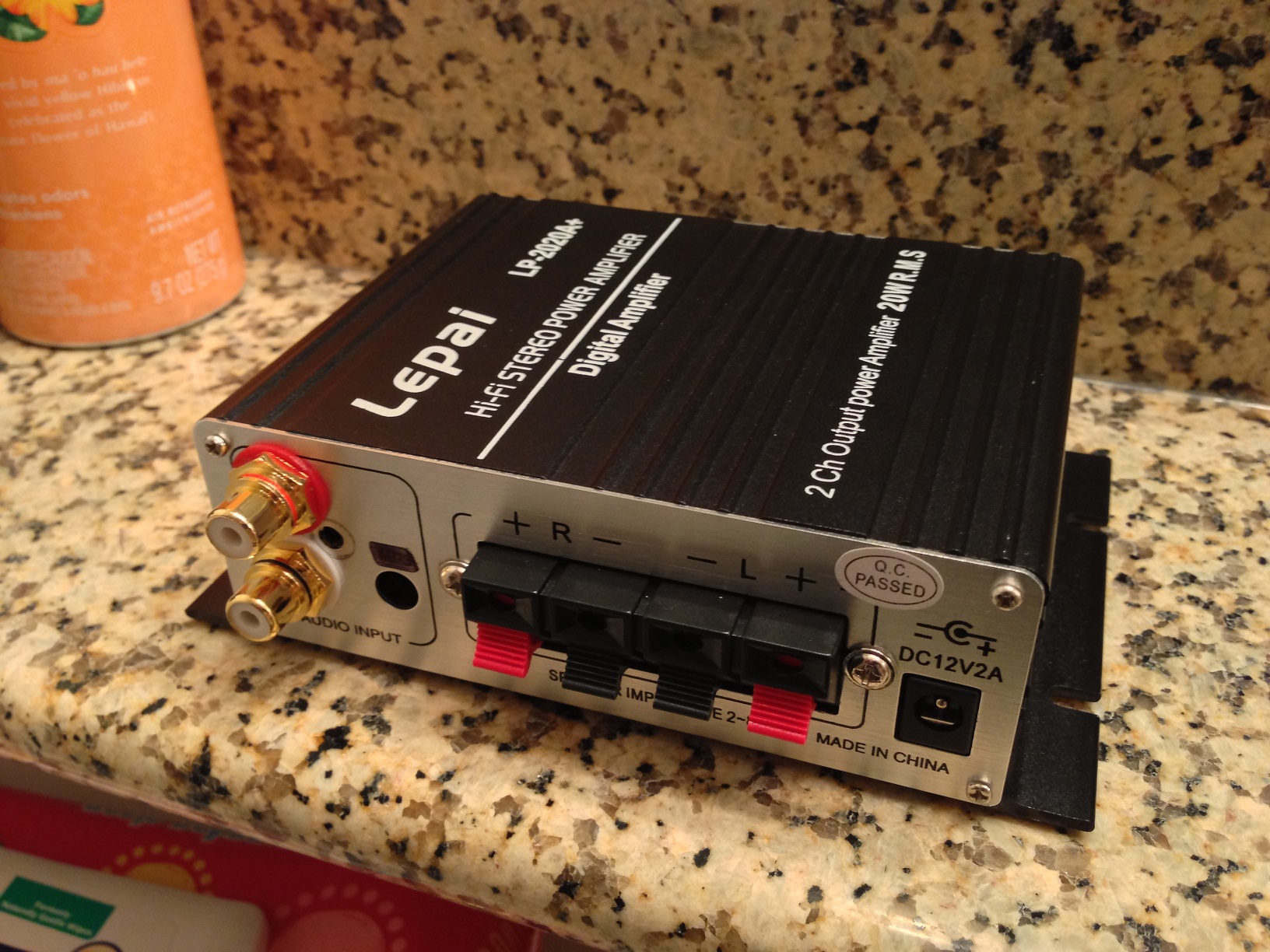

Ok, I finished my mods... With the exception of my MUSE input caps that are in the mail. I have some temp panasonics in there now.
Mods include:
Ferrite core inductors all around.
-Panasonic film caps for output.
-Relocated caps (the big ones, don't know what they are called) & inductor due to space limitations
-All tone controls wiped including bypass switch
-Volume pot rewired
-Install better thermal compound for heatsink
-Install 'better' rca inputs
-Removed annoying LEDs
-Removed 3.5mm input (will not be used)
I think that's about it. The first pics don't have the big caps in them just in case anyone wants to see all the tone control wipes.
If you have any questions, let me know. This thing sounds great. I love it and it was very fun working on it.
Thanks to all the contributors for your help and write-ups.

The output section mods:
I replace the inductors with Wurth 10uH 4.7A inductors (note I put 2 of those in wrong, the dot should be on the side that the amp chip is on - backwards will increase EMI).
The small ceramic SMD cap I replaced with 0.01uF WIMA caps (the two holes are meant for larger filter caps, but was a perfect fit for 5mm lead spacing as long as the other two caps are also 5mm).
The four output filter caps next to the inductors I replaced with 0.47uF film caps as the originals were probably ceramic.
The inductors + 0.47uF caps + 4 ohm speakers should give a cutoff of about 73kHz (I wish I could find the spreadsheet I used for that calculation).
I replaced the zobel components with 6R8 and 0.22uF film caps to give a frequency point of 106kHz (it should be a little higher than the primary filter cutoff so it doesn't have to deal with a lot of energy).

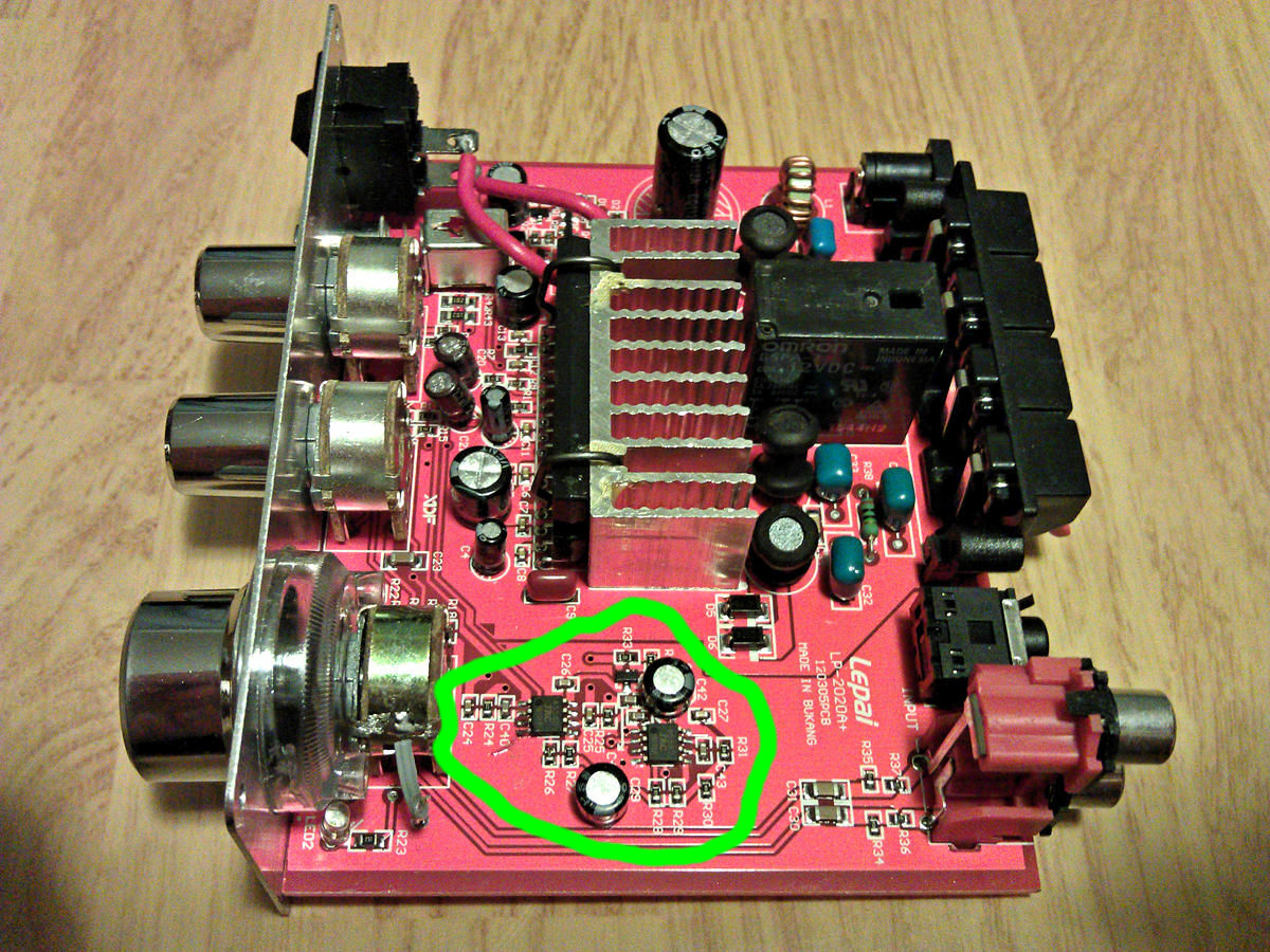

For anyone who is nervous about removing all the op-amp components, don't be. It doesn't matter one bit if you pull those traces off the board, and will give you some experience (removing them is much harder than soldering them in the first place). For the op-amps, I usually try to lie the soldering iron tip along all the pins on one side while gently prying up with a pin or tweezers. Once one side is lifted, hold the board on edge and heat the other side, the op-amp will fall off.
Everything in the green circle is fair game, as well as R18, R19, R20 and R21. Note that you WILL have to do more than that to have a functional amp, some sort of input bypass wiring, with or without the volume control.

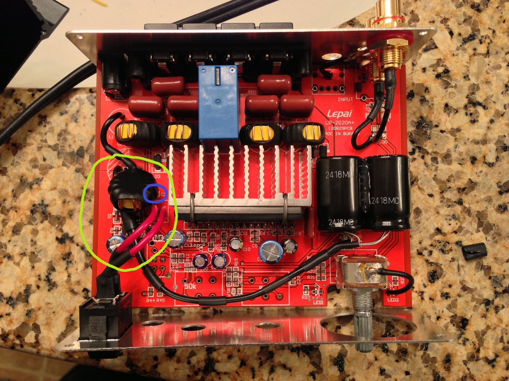

Question:
Did you keep C2, the blue circle..
and Is there any stuff underneath the wires circled in the Green that you removed or replaced? :usd:
I didn't remove that cap. Check out this pic. Sorry the text is small. Oh, also, just to be safe, I isolated the pins on the volume pot with a dremel.

Thank you sir. I used my 15 year old Weller 40W. It's been through a lot but still does the job. After I removed each component, I followed up with a braid to clean it all up. I lifted some traces at the stubborn opamps but I don't plan on reinstalling them again so I don't care.
For the isolate thing. If you zoom into the pic I posted of the underside of the pcb, you can see where the copper traces coming into to the pot suddenly stop before they get to the pins. I still soldered the pot in place but the signal stays where the pins are so that the wires i used take all the signal. Does that make sense? I didn't want any rogue signals since I didn't really know what I was doing at first.
