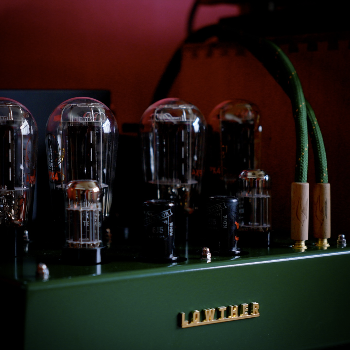

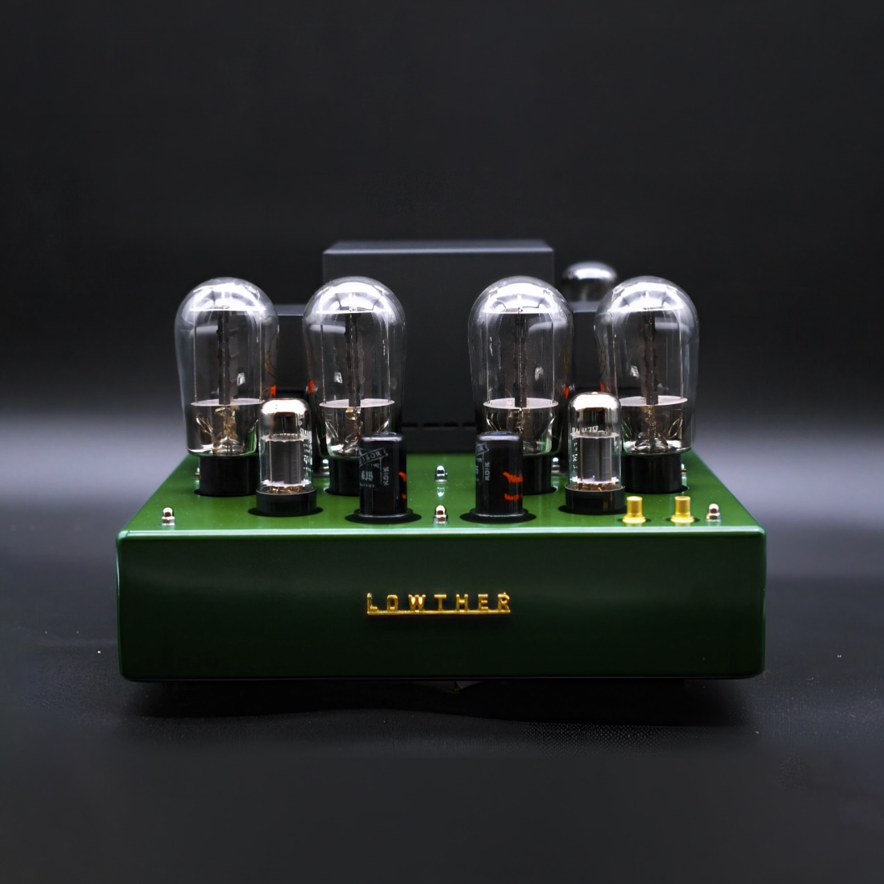

The Lowther PX4 Amp is now available for order!
Get ready to elevate your audio experience with the PX4 Push Pull Stereo Power Amplifier. Built with precision and a focus on sound purity, this class-A push-pull amplifier features high-quality tubes like the PX4, 6SN7, 6J5, and 5U4G/5AR4 for unparalleled performance.
Specs:
• Output Power: 10W + 10W (6Ω)
• Frequency Response: 10Hz – 45kHz
• S/N Ratio: 93dB
• Variable Feedback Control (0dB to 10dB)
• Traditional Cathode Bias (automatic)
• Input Sensitivity: 1V/300kΩ
• Power Consumption: 200W Max

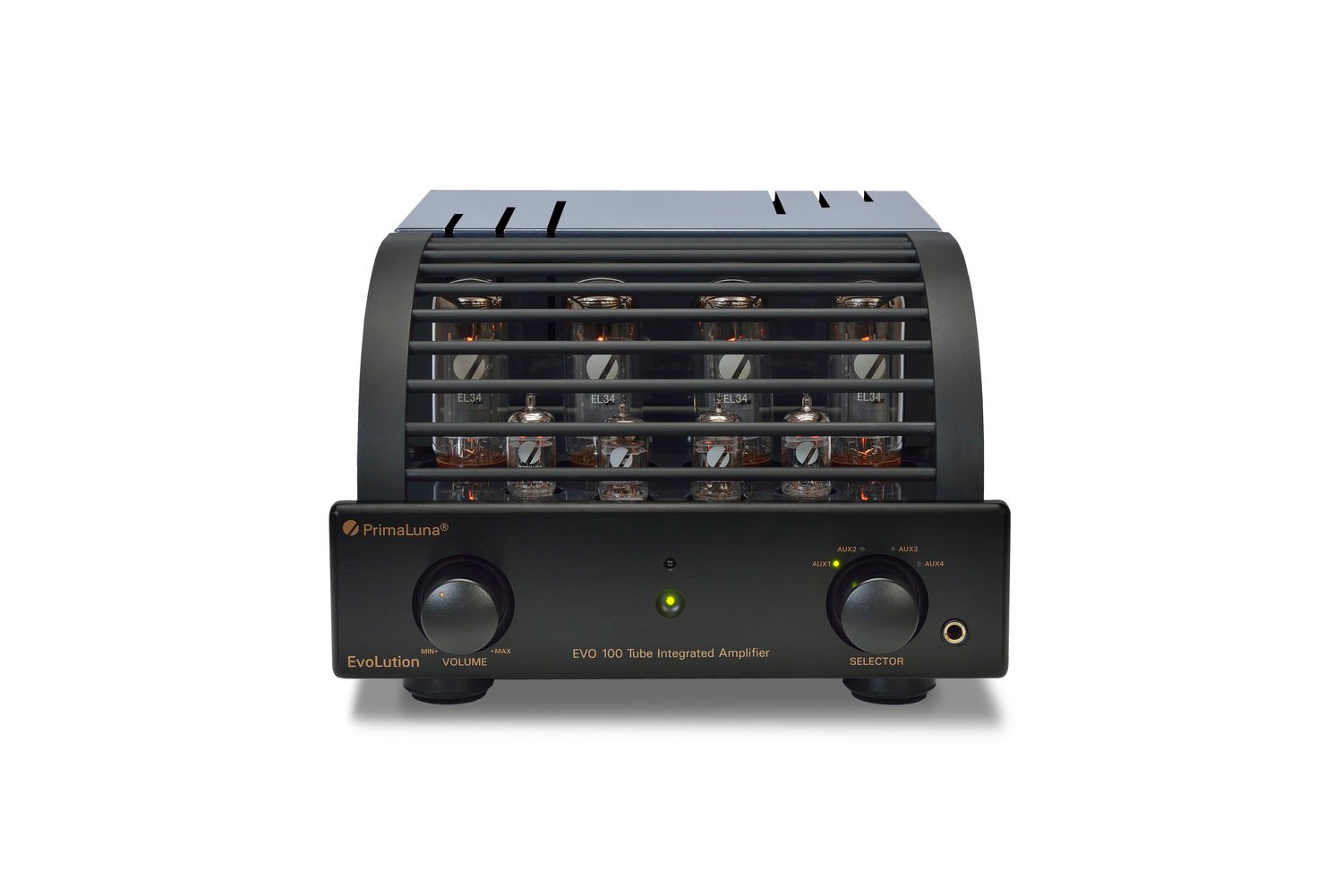

I went to Lowther's official website and I don't see anything about the tube amp they've just released. So I don't know the price, and I can't make any comparisons with my already outdated (not that outdated, eh?) Prima Luna Dialogue Two. But the current equivalent to this Lowther amp (with significantly more power) would be the EVO 100, at $3,295:
How does it compare? Both in sound quality and price? Can anyone give me a definitive answer?
The difference I see at first glance is that it uses tubes that aren't as "common" as the Prima Luna—12AX7s and 12AU7s for the preamp and driver—and a wide range of output tubes to choose from (see attached). The circuit's Auto Bias design allows you to choose between them without any bias adjustments. An advantage that has meant years of pleasure for me, without any inconvenience or wasted time when tube-rolling...
https://www.primaluna-usa.com/integrated-amplifiers
PS: I see that all PL models now include a headphone output. Mine didn't bring it, damn it ! 😡

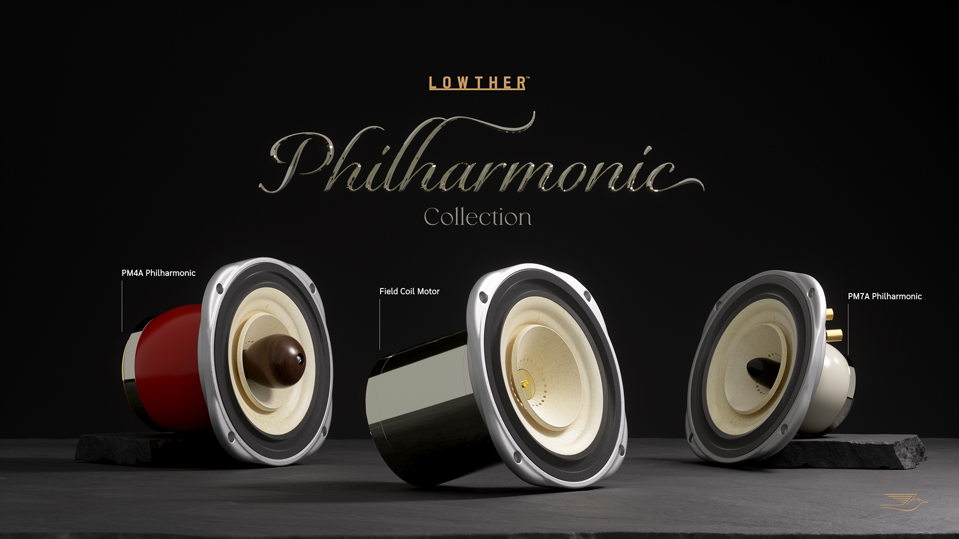

1. Introduction to Lowther's New Collection Philosophy (5 minutes)
• Brief overview of our four-tier collection approach
2. The Concert Collection (5 minutes)
• The classic Lowther experience designed for self-builders - those who know what they like.
• Complete Lowther line up - minus the Field Coil.
3. The Sinfonia Collection (5 minutes)
• Premium cone technology and other improvements
• Enhanced bass response characteristics
• Notable elimination of the traditional "Lowther shout"
4. The Philharmonic Collection (10 minutes)
• All-Alnico design with comprehensive enhancements
• Significantly improved bass response without sacrificing the Lowther clarity
5. The Grand Opera Collection (5 minutes)
• Our bespoke commissioned offerings using Permadure/REMCO metals
• The pinnacle of full-range driver engineering
