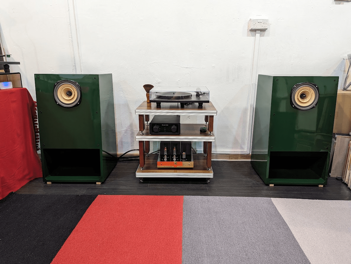

Nice cabinets in green finish. Please let me ask you what has improved in its sound in comparasion to the older serie of lowther. Is it pm6a, 7a, 2a what is in the cases ?
that is a PM4A , the extra room on the backloaded horn should be able to get to 55hz rather than the original 70hz. But still room improvement, probably designing a new spider to allow lower Fs.
The Premium has the English feel to the tonality, no shout which they probably have addressed in the new design. Good control of the midrange and not harsh compare to the older Lowther.
