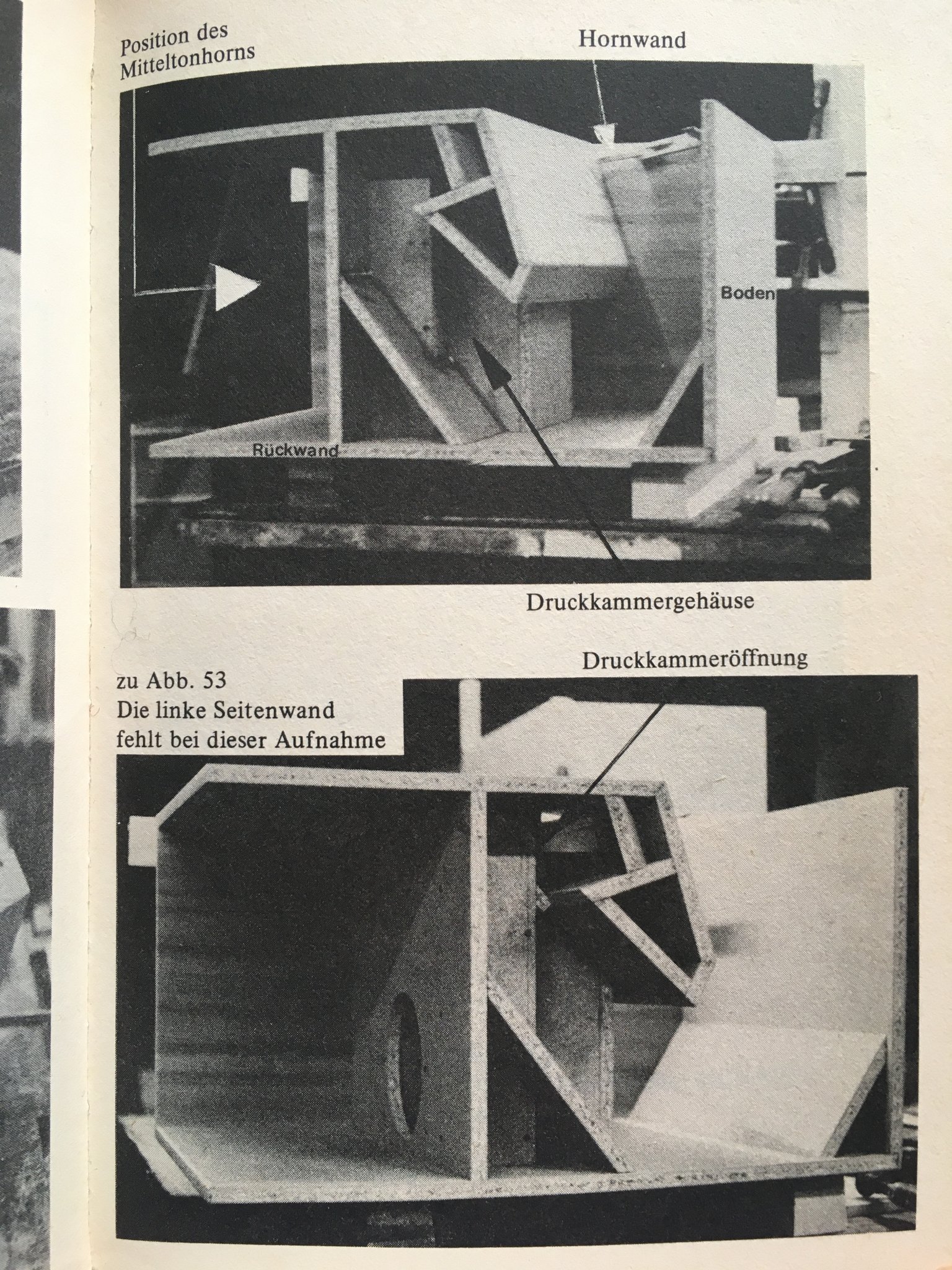

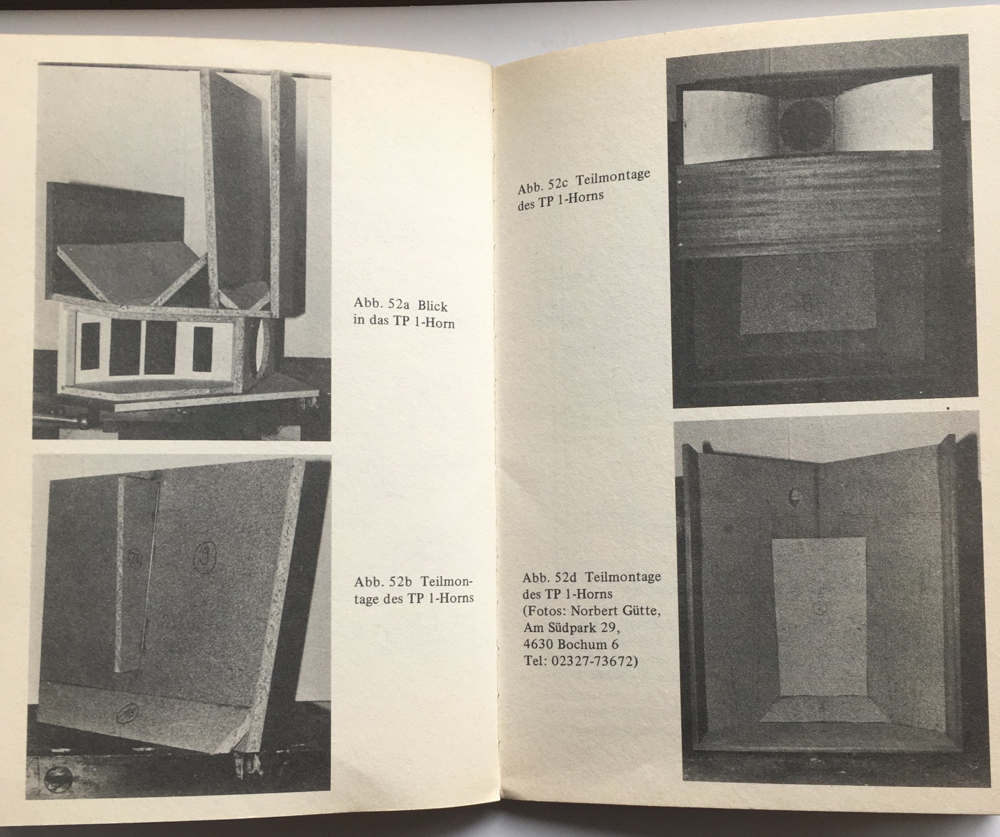

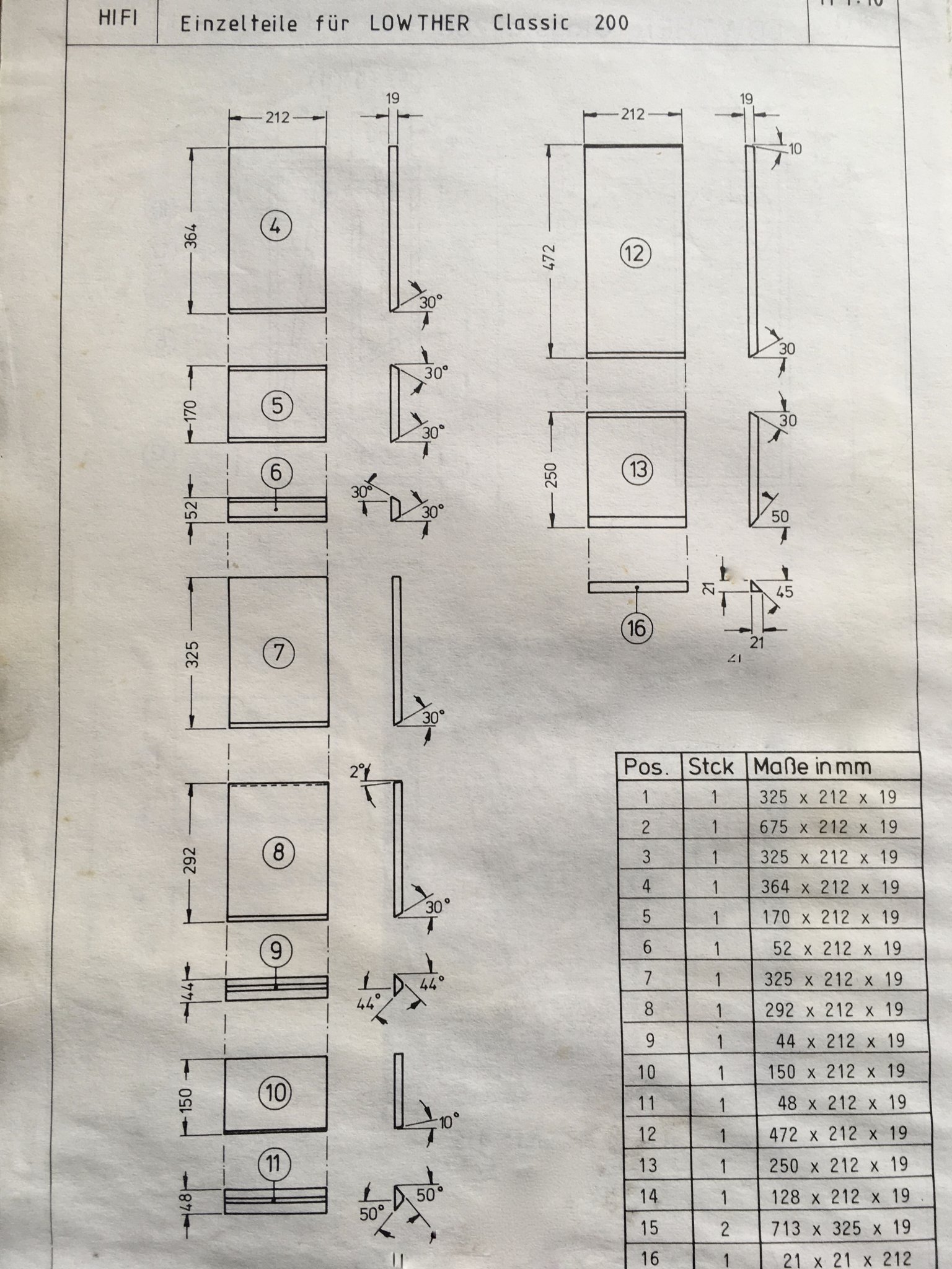

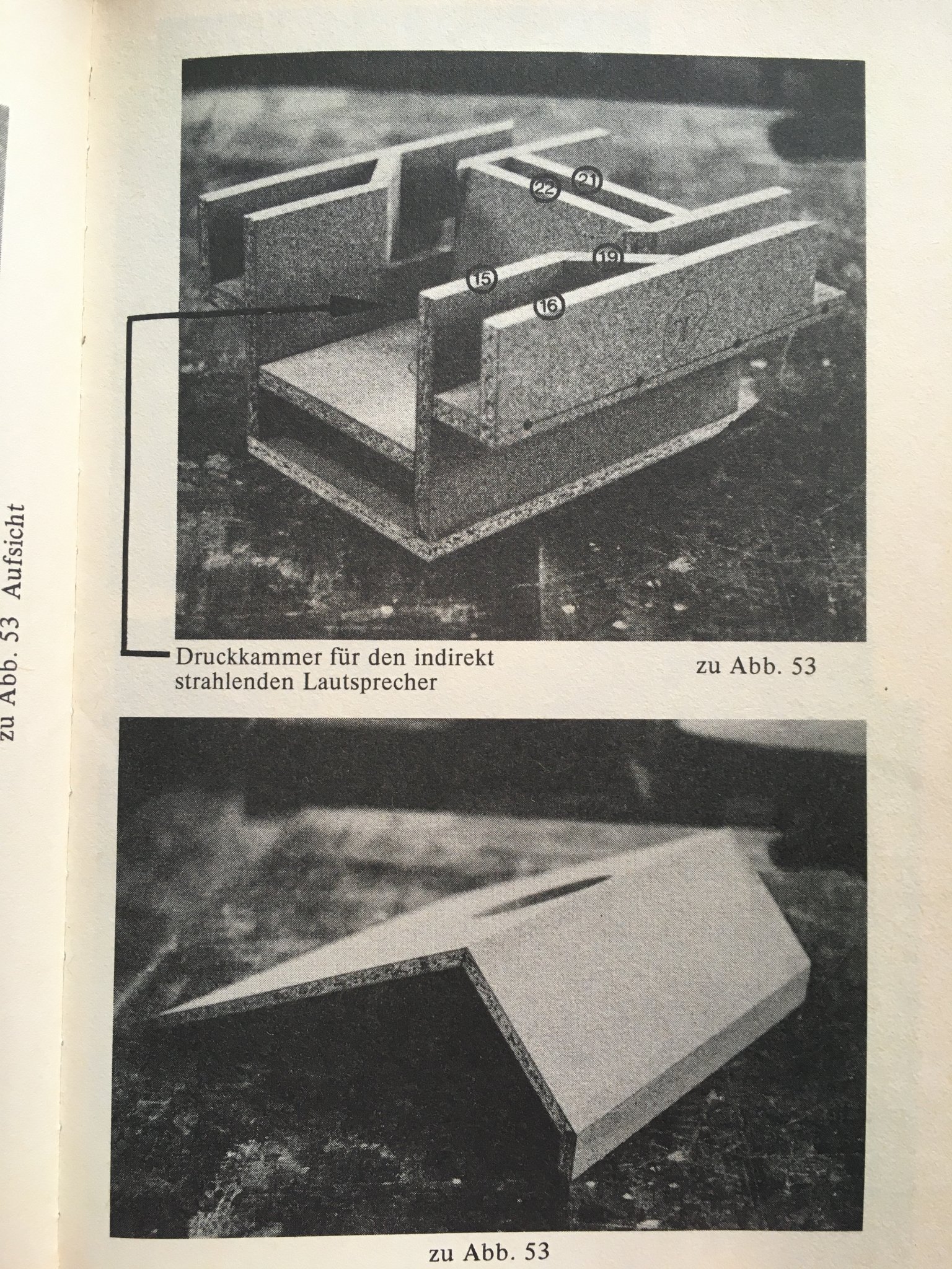

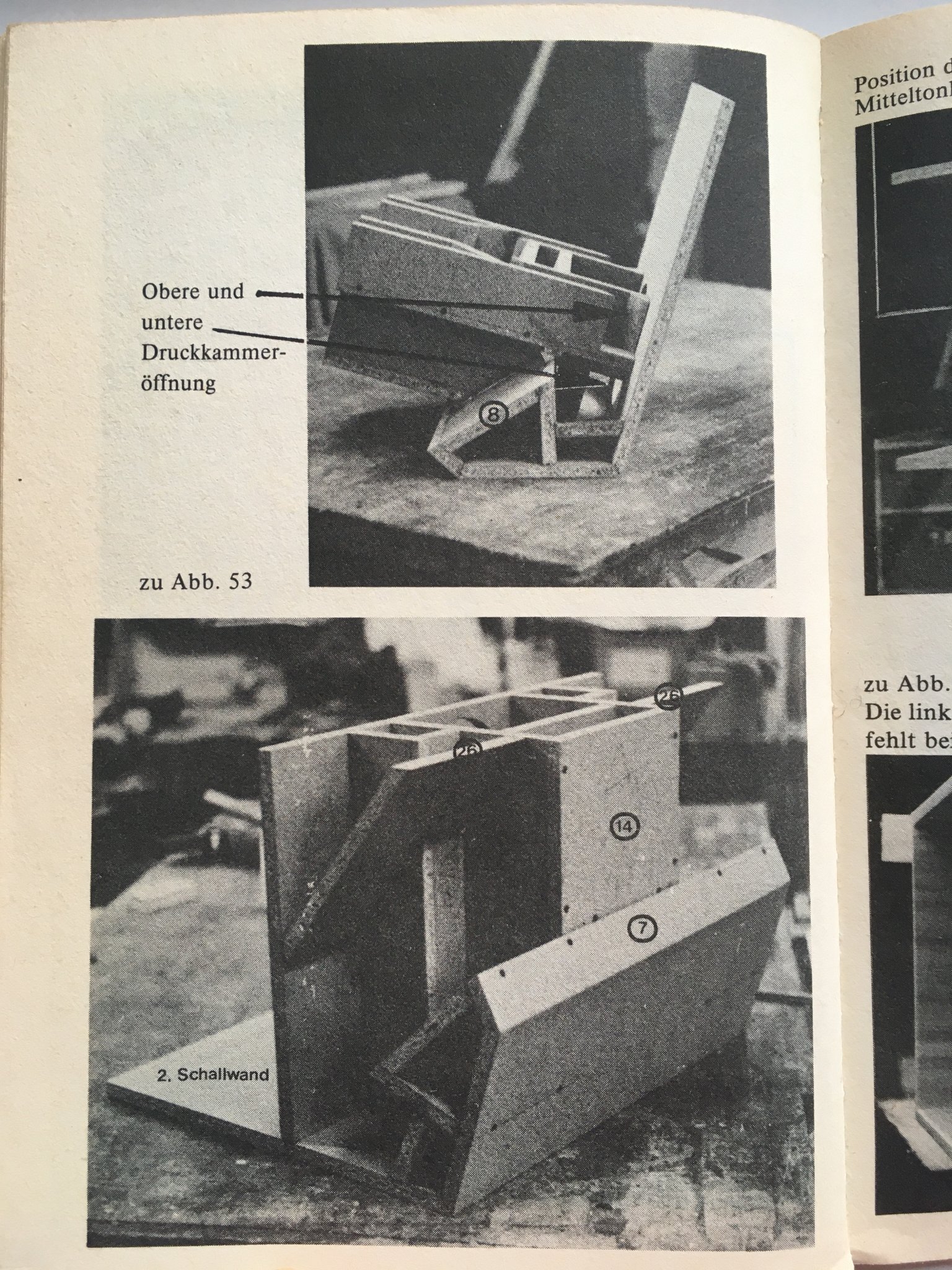

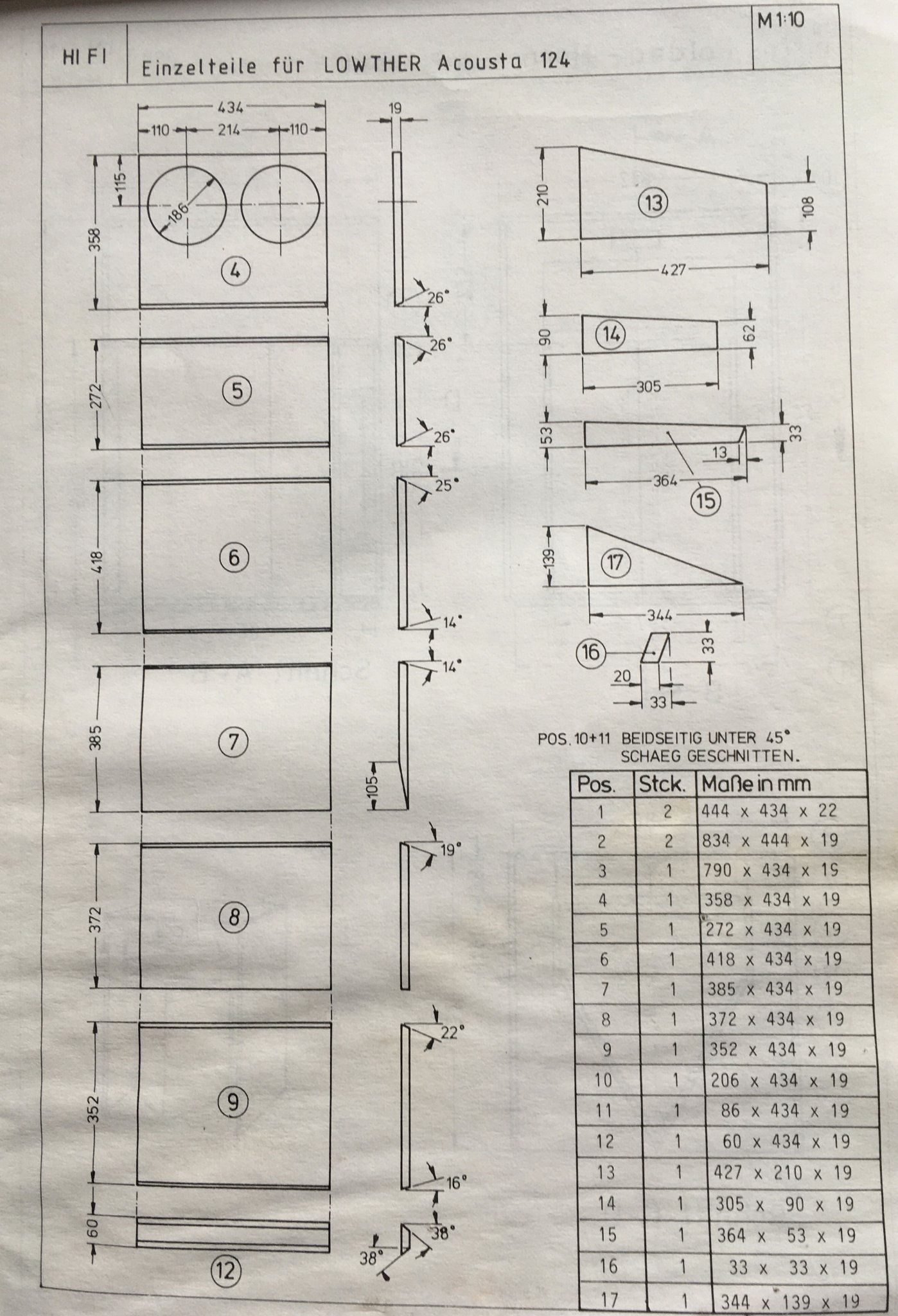

Hi.

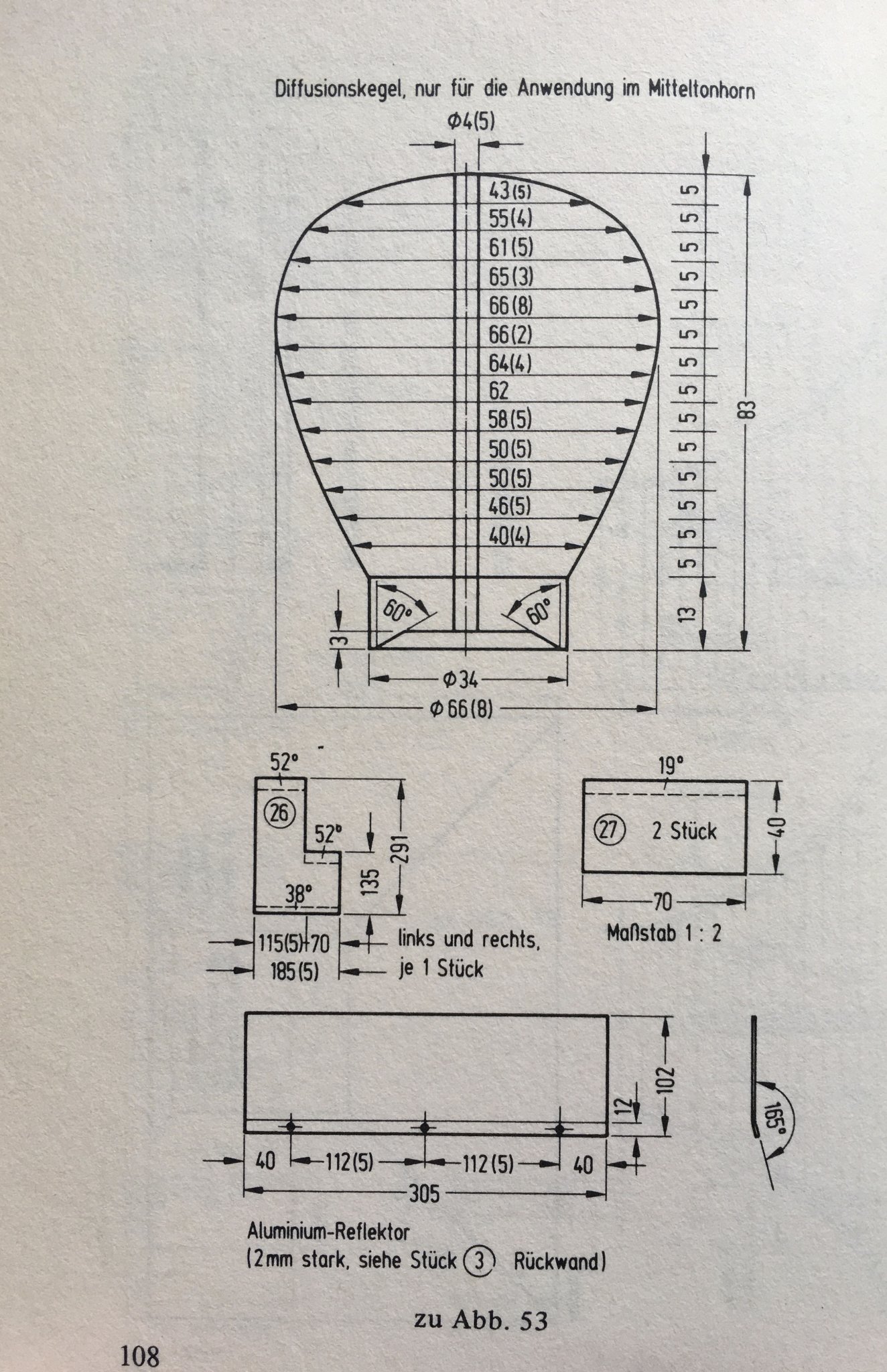

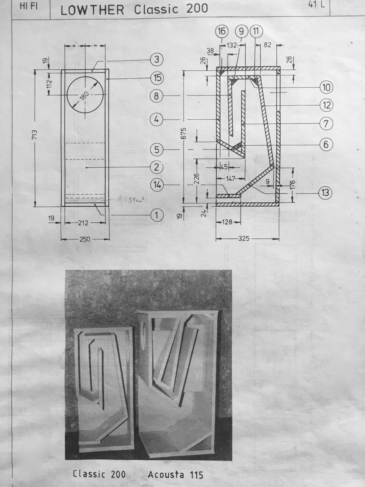

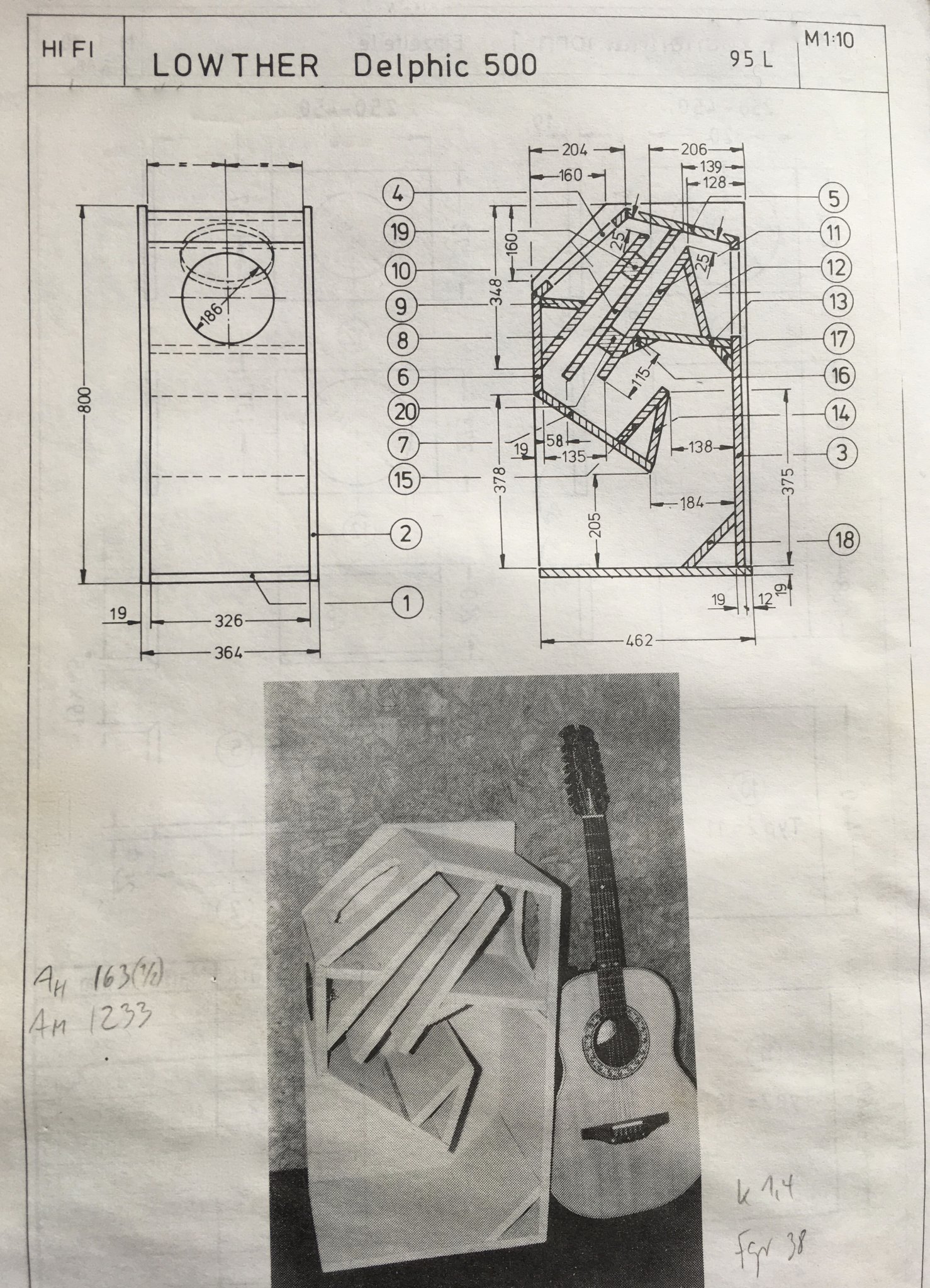

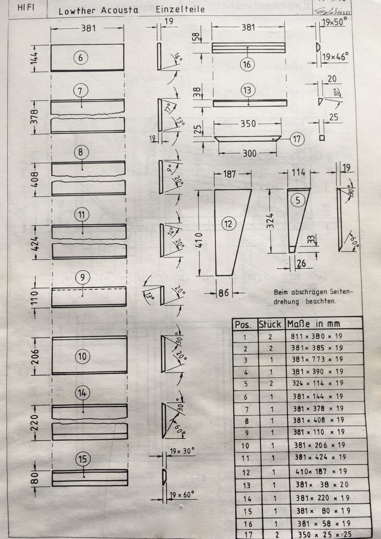

Just discovered this thread and would like to provide the following plans.
They come from (3) books that were published in Germany in the early 80s. The photos are sequential according to the pages.

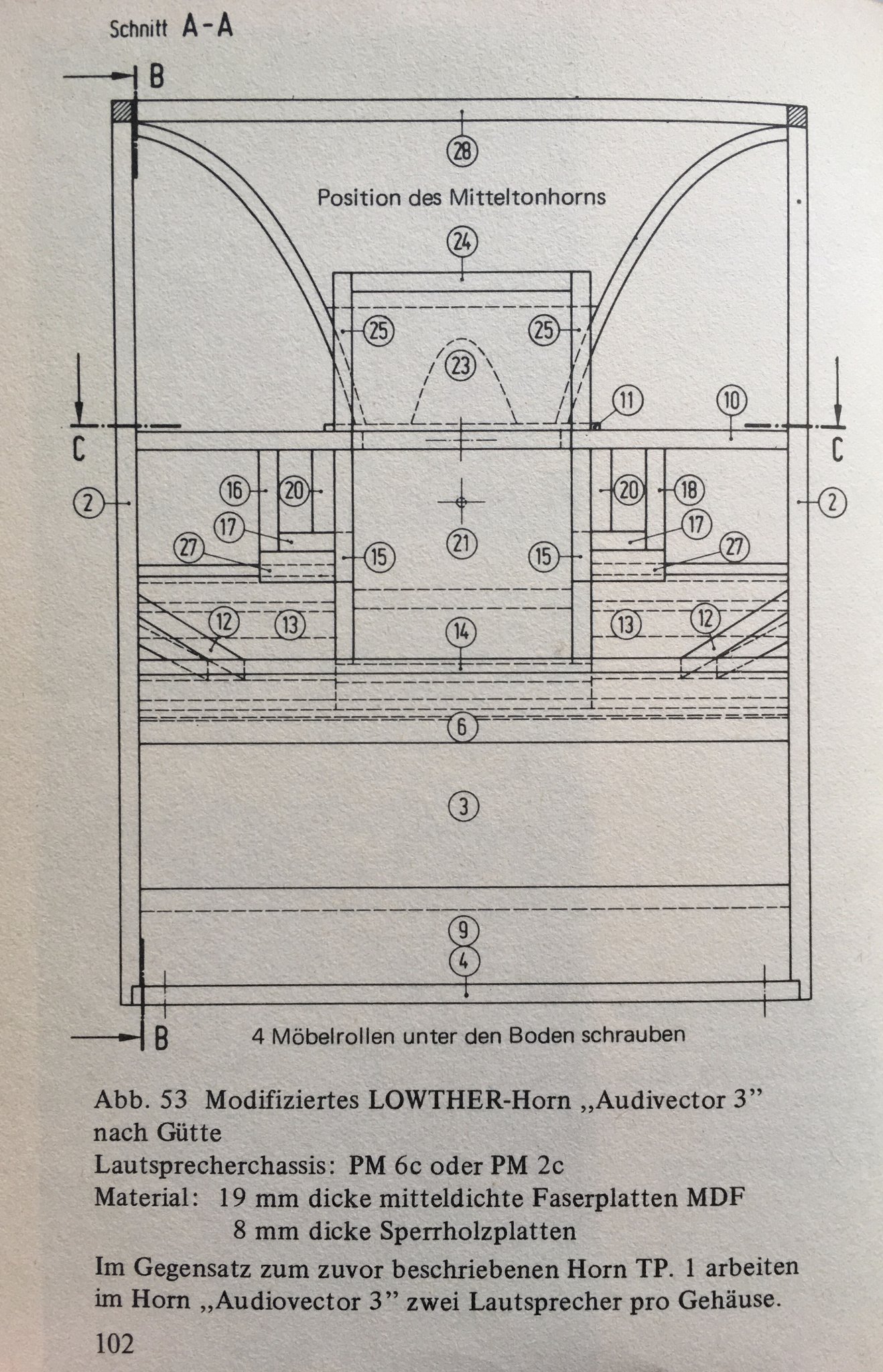

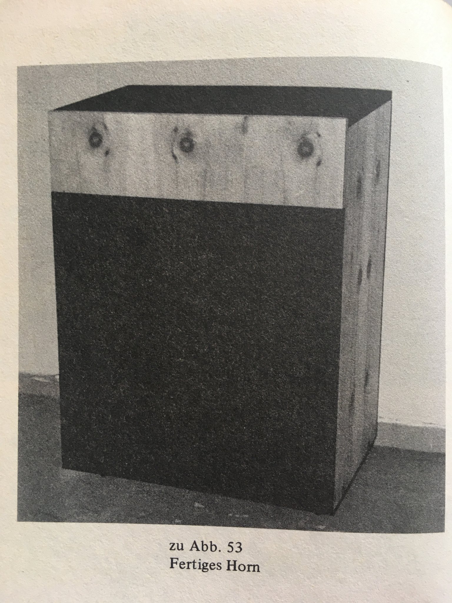

Lowther Audivector 3
