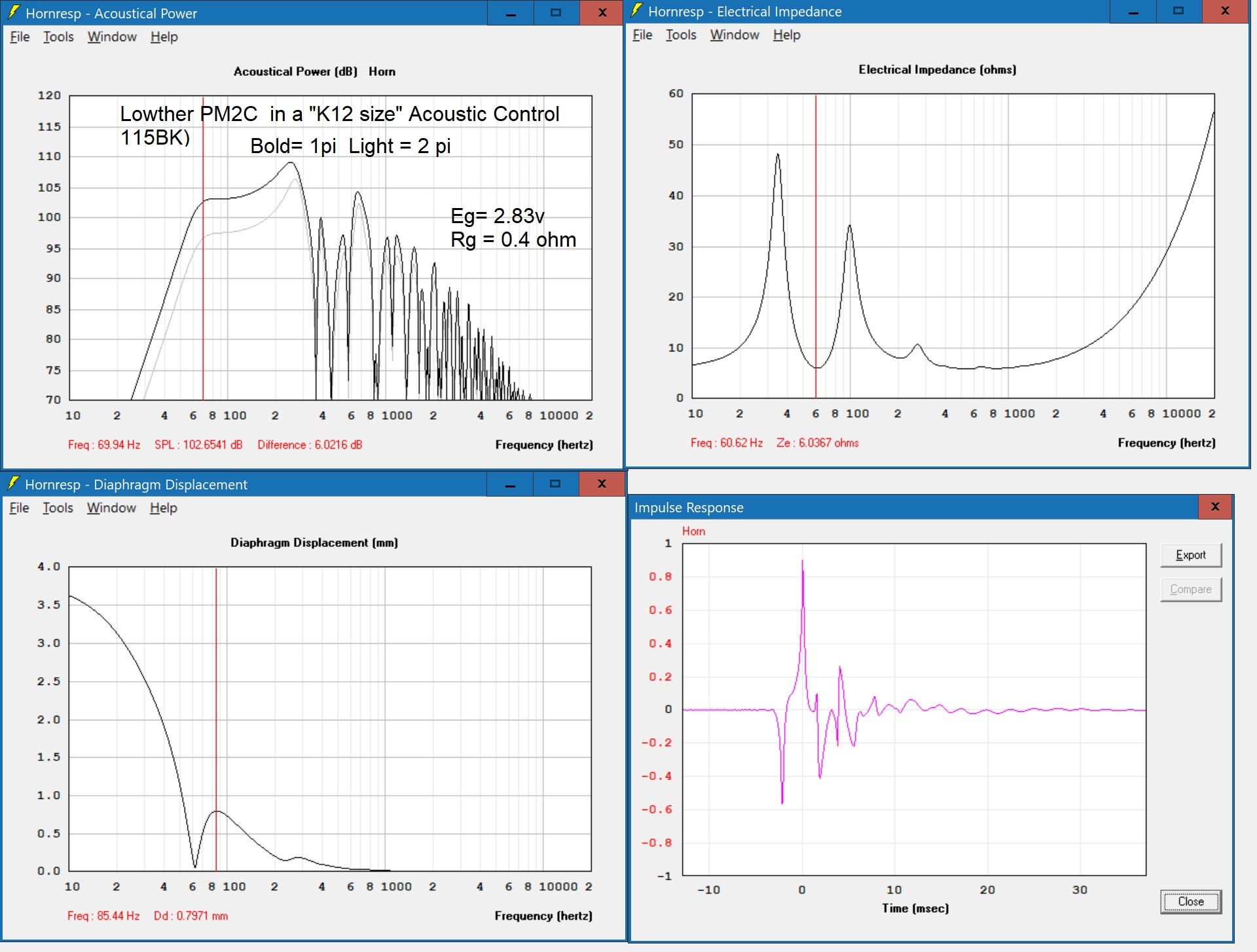

PM2C specs seem friendly to a Karlson K12 (or 0.85 scale Acoustic Control 115BK). ( I think Diyaudio member "Suntiger" would use a curved reflector per Rig.6 of patent 3540544)
PM2C… can’t find it at the Lowther site. I assume a ceramic magnet on a PM2A? Data?

Response is pretty decent based on those numbers.
F10 in the mid/low 40s, F6 low 50s. Really small box thou. 11 litres, could be a challenge to make the baffle big enuff.
Given how low and how small, sensitivity has to give by Hoffman’s Law. The frequency response is probably rising up to the 97dB number.
Response is similar to PM6 but in a third the volume.
