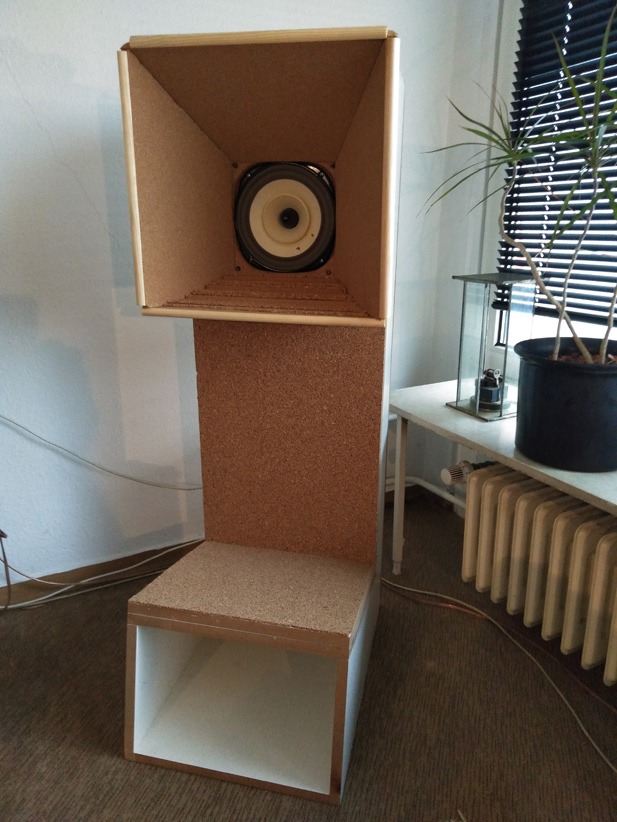

Referring to your comments above, I don't care how it does it, all I care about is "is the miniOnken design a valid option for my proposed Lowther project when it comes to bass performance? Will it give me as much bass as a TL or TQW box?

miniOnken alone: Nol I care about is "is the miniOnken design a valid option for my proposed Lowther project when it comes to bass performance?
miniOnken with suitable correction filter: Yes, with expense of reduced efficiency
Depends on specific design. TL or Voigt pipe (TQW as you wrote) may operate at wider frequency range compared to Onken, so more bass boost is possible. But again, it depends on specific design.Will it give me as much bass as a TL or TQW box?
I dont see how this mini onken will give more bass compared to simple bass-reflex box of the same size and tuning.
miniOnken uses the high vent resistance as part of the equation. You would not want to do a “traditional” BR with the same tuning. You would usually tune it lower. The BR can be taken lower, but will lack the stability of the nminiOnken’s alignment even under the dynamic changes in T/S.
A miniOnken only goes as low as it goes, but the bass is very articuate and elegant, and “in control”.
It is a set of trade-offs that give very good, but not the lowest bottom possible.
Don’t talk to me, talk to the builders, they is very pleased.And I dont see thats mentioned in a picture by planet10, it says "no filters required".
A very good study. He chose a less suitable Lowther which did need a filter as bass was weak. Choose a driver more approriate to the enclosure means less band-aid required (if at all).If you wish to go that way check this ML-TL (mass loaded transmission line) project by M.J.King.

You can only use the PM6 in a (right) miniOnken. They are very specific. Until i looked at this particular driver, none would work in a miniOnken.miniOnken alone: No

I believe filters to be bandaids and i always design to avoid needing them.
