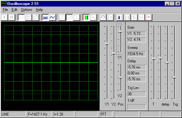

Well, did some messing around with this setup, so here goes:
After downloading the oscilloscope, put it on the screen. Also make sure you have a microphone set in front of the tweeter-very close. Along the top of the oscilloscope are many pushbottuns. Counting from the left, press buttons #:
1 ,3, 6, 9, 11
When the waves go UP one division, they are 6 dB up. When they go down 1 division, they are 6 dB down.
Then just simply start at say, 8,000 Hz on the test generator, and work your way down until you see the response drop. Note the frequency where the response begins to drop, and note the frequency where the response is 2 horizontal lines down. It is 12 dB down at that point.
Then we will be able to tell how to crossover from the woofer to the tweeter.
After you have done that, you might want to test the woofer, just for accuracy's sake. Pay attention to that little anomaly around 2,000 Hz.

Hi
so far i have just measured the tweeters response, 1st with the cap and then a second time without it.
With cap
@8000Hz there was no output on the scope but i could hear it.
5039Hz 1 division on scope
4756 2 divisions
4000 4 divisions
3563 3 divisions
3363 3.5 divisions
3174 2.5 divisions
2923 2 divisions
2000 1 divisions
No cap
5339 1 division
5039 3 divisions
4756 6.5 divisions
4237 8+ divisions (off scope)
3177 7 divisions
2996 8 divisions
2828 6 divisions
2244 5 divisions
2000 4.5 divisions
i will get the woofer done at a later date. what frequency range should i be using for this?

I am thrown for a loop. The frequency response test you just did seems to indicate a tweeter with a peak at 4,000 Hz and a gradual rolloff in either direction from there.
Acoustic Research-a fine and respected company-would not make such a tweeter.
Just for a piece of advice, try putting the microphone as close to the tweeter as possible and see what happens. Just try 2 tones-8,000Hz and 4,000 Hz-to see if they are even remotely level.
If not, try the opposite approach. Put the speaker on the floor facing up, and hold the microphone a yard away. Again, see if 8,000 Hz is any closer to the level of the 4,000 Hz tone.
Incidentally, what amp are you running this from? Is it hooked up to an equalizer? Is the equalizer turned off?
How are the tone controls set? Level, I hope. We want a flat signal from 1,500 Hz to 20,000 Hz.
If you have a disposable set of old Walkman headphones, you can cut one of the headphones off, plug it into the sound card, take the 2 wires from the removed headphone and attach them to the terminals of the tweeter-one wire to the "+", the other to the "-". This should measure the amplitude of the signal going to the tweeters-wheter it is flat, (equal amplitude at all frequencies), or not.

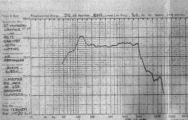

The information at the Acoustic Research Clssic Speaker site seemed to indicate that most 8 inch AR woofers crossed over at 2,000 Hz, but there was no sure indication that the AR 18BX did so. So the possiblilty of a 4,000 Hz cross over for the AR 18BX exists.
Crossing over means that each respective driver stops playing at a certain point. So if a woofer starts to gradually play less loud at 4,000 Hz, the tweeter should start playing at 4,000 Hz and continue up to 15,000 Hz and beyond. The tweeter should begin to play less and less the farther below 4,000 Hz you go., just as the woofer should play less and less loud the farther above 4,000 Hz you go.
If you turn the treble tone control to cut the treble, at some point you will hit the place where the response begins to go down above 4,000 Hz.
So if the woofer is set to cross over at 4,000 Hz, then that is the reason for the slope on the low end. And if the trble contol is set to cut the treble, that would explain the rolloff on the high end.

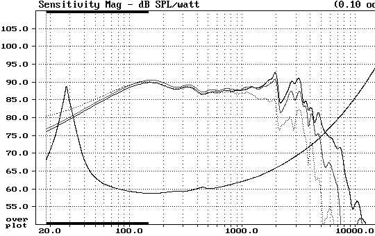

Kram:
Read the response. Nigel is doing his best, but he really does not have any reference as to what the crossover frequency is. So he is assuming the tweeter is 8 ohms, mostly because he has no other choice.
Everything Nigel says is right on the money-assuming that the AR tweeter is a constant 8 ohms throughout it's range.

Kram:
Well, I broke up a Walkman pair of headphones, and seemed to get a decent set of wires to hook up to the sound card.
But that oscilloscope program was giving me wierd readings. So did another program I downloaded.
However my little cheap analogue voltmeter was rock steady.
I will check to see what the problem is with the oscilloscope program. However, I strongly suggest that you start asking around to see if you can borrow an inexpensive voltmeter just to run a test to see if your amp is giving out flat response at all frequencies.

I am showing two graphs. The first will be a test speaker that AR had in an AR 17-an 8 inch only slightly larger than your AR 18BX. Forget the response hump at 100 Hz for the AR test speaker-note the high frequency response around 2,000 Hz.
I have read that AR used basically one speaker in all their 8 inch boxes. If the high frequency response of the AR 17 test speaker is the same as the regular AR speakers, (and I think that is likely), then note how the response is flat until 2,000 Hz, then goes down at 12 dB/octave.
I think a simple, inexpensive noltch filter will render the Audax very close to the AR woofer's response.
The main difference is that we will port the Audax, and the Audax looks to be about 2 dB more sensitive. I think the AR tweeters should still be able to keep up with it, though.
Here is the response curve of the AR 17 test speaker:
