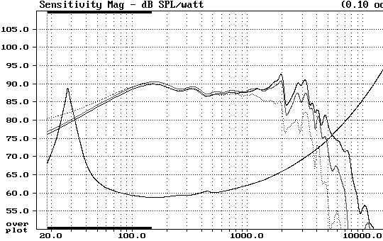

Well, I checked the audax AP210ZO for you. The curve doesn't look half bad, (the 1.5 dB hump in the bass will be barely noticeable), but there a couple of things that make this not as good as the Peerless.
A) I don't believe it has a symmetrical magnetic system. This leads to higher distortion around the tuning frequency. However, the tuning frequency is much lower than the F3 cutoff here, so maybe that is not such a problem.
B) It has a small excursion-only about 2.5 mm. This limits it's output at bass frequencies. With the setup I am about to show you, you should only be getting around 103 dB at 55 Hz. So a 30 watt amplifier just about pushes this to it's limits in the low bass. You can use a larger amp with it though. How big is the amp you were planning to use with this?
On the other hand, this is Audax, a very respected brand, and it goes down to about 50 Hz in your smallish box, and it is in your price range. Barring finding a great deal on a "closeout sale", this might be just the ticket for you.
And you know what? It wouldn't be half bad, either. It would be nice if you could afford the Peerless, but if you are looking for a couple of drivers to make a set of "nice sounding" speakers, these will fill the bill.

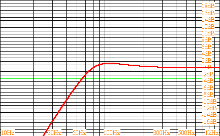

Here is the frequency response. The vent would be a 3 inch inside diameter pipe that is 13 3/4 inches long. That tunes the box to 42 Hz. 3 inch elbows are available in home sonstruction stores to fit the vent into the box. Or, a 2" pipe can be used that is 5 5/8 long instead. The 3 inch pipe would be preferred.

Kram:
Your first question: am assuming that the 13 3/4 inches long tube for the port goes inside the box and i use a 90 degree elbow to join it to the port hole. Am i correct?
You can do it that way if you want. Or, you can have the PVC tube go into the box for several inches, then join to an elbow that takes the tube upward. Either way is fine. One thing: be certain that the port opening on the inside is completely clear of any obstruction, including stuffing. Also, if the port opening is against an interior wall, even a bare wall, the box frequency will be lowered. If you want to put the port opening against a bare wall, make the length 11 inches instead of 13 3/4". That's just a guess on my part.
Remember that the length of the port includes the length of the elbow, measured down the middle.
Do not give yourself a neurosis about the length of the port. I ran the simulations with the port 16" long, and 11.5" long, and you know what? The curve was almost identical! So you have plenty of leeway here.

Just checked out the response curve of the Audax AP210Z0 on the Audax website.
It has an aerogel cone. Aerogel is a new material just invented a few years ago. It is supposed to be both light and stiff. Speaker manufacturers only use it on speakers they feel will go into very good systems. Apparently, Audax is putting something into these speakers. This is a good sign.
The curve has an anomaly right around where you want to cross over. Hmmm. Shouldn't be TOO bad. Maybe we can do something with it on the crossover.

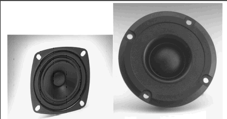

I bought the audax drivers yesterday and tried to fit them to the existing cutouts, it turns out that im going to have to do some wood working afterall as the new drivers are just slightly too wide.
Ouch!! Your cutout is 184 mm, your speaker needs 185.2 mm. A lousy 1.2 mm off, (less than 1/16")! Grrr. I knew I should have checked that spec, but it is located in a different part of the Audax website from the electrical specs.
Does the Audax at least lay in the indented area, assuming your box has one), surrounding the cutout? Or does the indented area have to be enlarged as well? Enlarging the indented area could be tricky. Before I come up with suggestions I would like to know if it is necessary. Give me some dimensions about the diameter of the indented area surrounding the cutout. The outside diameter of the Audax is 218 mm.
Oh well, maybe it doesn't matter that much. This seems to be the speaker that most meets your needs and budget at the moment regardless of cutout sizes.
I don't know if you have any woodworking tools, but if the 185.2 mm cutout is your only problem, small reciprocating saws-very inexpensive-are available. By inexpensive, I mean some places have them for $10 over here. Or maybe you can borrow one. Even a hand rasp will enlarge that cutout the small amount you need.

AudioFreak is correct. A cone tweeter looks like a miniature woofer or midrange, complete with dust cap. The important thing is that the voice coil that drives the speaker is small, while the diaphragm that makes the sound is larger. The voice coil in the center drives the larger diaphragm, or "cone". So a 1.5" cone tweeter might have a .5" or even a .25" voice coil. the smaller the voice coil, the less power the tweeter can handle-heat buildup, you know.
On the dome, the voice coil drives the diaphragm around the outside. A 1' dome has 1" voice coil. This cuts down on vibration, etc. Also, domes can handle heat better, because their voice coils are as large as the diphragms they are driving.
Here are 2 Peerless tweeters-Peerless is one fo the few manufacturers that even makes a cone tweeter anymore. Most of Peerless' tweeters are domes. The cone tweeter is on the left, the dome is on the right.
