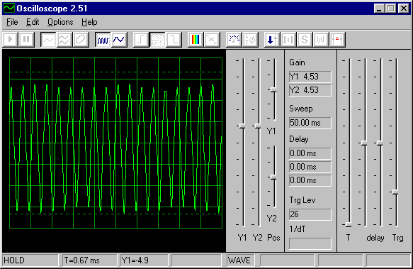

I followed ttvonau's advice on another thread and went to Steve Ekblad's excellent site for audio software-which should have been the first place I went. I've had that site on my Favorites for well over a year.
A couple of the programs listed just did not work, others, such as SpeakerWorks from Audua, are supposed to be excellent but take some time to learn.
However, there is a gem-Oscilloscope for Windows, ver. 2.51. Quick to download, easy to use. Press the arrow button on the left top-it looks like a "Play" button, and it displays whatever waveform you feed it onto the screen. The amplitude varies with the loudness of the signal. And you can adjust the sensitivity.
I include a screenshot below. This readout was made by my speaking softly into a computer mike. The only question is: how many dB per horizontal division? I am guessing that is is 5, but I will simply calibrate it tonight or tomorrow.
Whatever you do with the tweeter, Oscilloscope for Windows should be something on your computer anyway.
