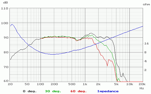

Danish-made Peerless is always a good place to start your search for a woofer. As a rule, I find that they usually incorporate design items that frequently are only found on more expensive speakers.
The Peerless 850136 is an 8" woofer that has relatively smooth response up to 5,000 Hz. They recommend that you cross over to a tweeter at 3000 Hz. Below is a frequency response chart for an unenclosed 850136. If put into your box, it will be 3 dB down from the midpoint at 55 Hz.
It has a magnetic structure that allows linear movement in a bass reflex enclosure-not every speaker does that. Very low distortion near resonance.
It costs $45 at Madisound in America-but I guarantee you, it is available in England. Probably at a similar price. I mean, they are made in Denmark. So that would be what-about 30 pds? That is within your guidelines.

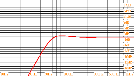

Just for the heck of it, I ran the simulation for this woofer in a box your size on WinISD. In a .66 cu ft box tuned to 47 Hz, (a 3 in diameter pipe of 10.5 inches length), the speaker is 3 dB down from midpoint at 51 Hz.
I can run the same program with metric sizes, if you tell me what metric sizes are available.
The blue line is the midpoint, the green line the -3 dB line.
I am not saying that absolutely this is the speaker for you. By the way, it is 4 ohm-is that a problem? I am just giving you an idea of what is possible. I think this woofer is a good choice, but it need not be the ony one. I am sure that other members have other good choices for you to consider before you buy.

For a simple xo, I would do a basic 2nd order centered at 2k to 3kHz.
Actually, the peerless rolls off nicely at 4.5kHz, so you could simply put a cap of correct value (youll have to experiment)in line with your tweet. As I said before, this can be very good (and cheap!). But your off axis performance will suck(sweet spot speakers).
If I wanted to get a little more complicated, I would consider the 3dB bump in the peerless's response around 1500 Hz. A first order (6dB per octave) low pass centered at 1500 would take care of that. The actual -3dB point would be closer to 2.25kHz. Then for the tweeter, a 2nd order high pass centered at 2.5 to 3kHz (again, you'll have to experiment). I think this would be the best solution.
