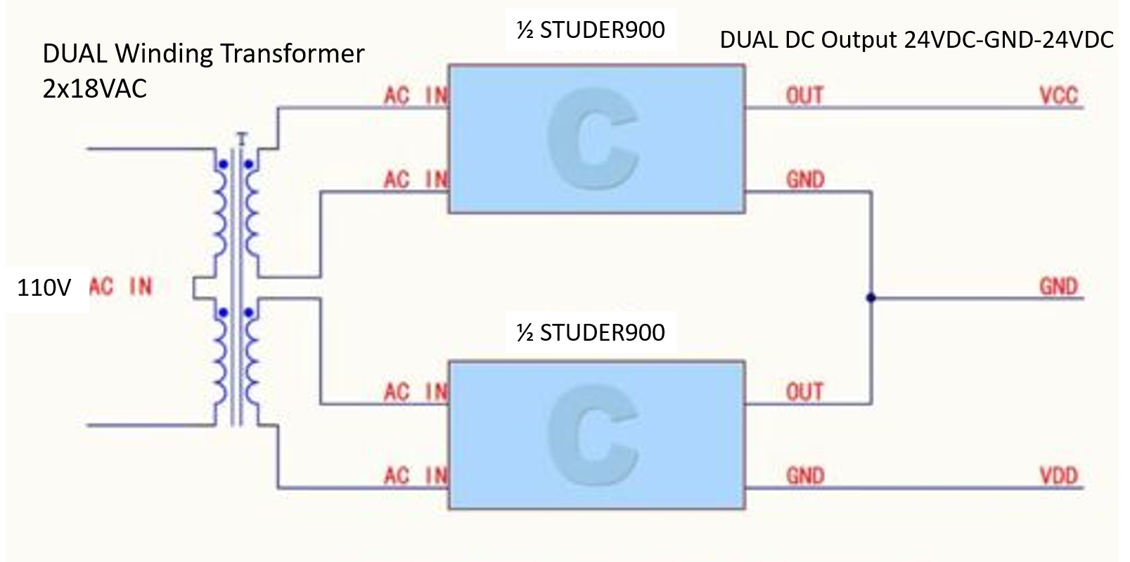

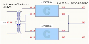

Bo, you have the wrong transformer. The Studer900 board is 2 independent rectifier circuit. You need a dual windings transformer, not a center tap winding transformer. When you get the correct transformer, use the hookup to get the +/-24VDC you want.Hi Keilau, thanks for helping out.
I'll try to attach some images to illustrate the situation.
Hope that clarifies what I've got connected and how I've connected it up.
Thanks again.
Bo
Bo needs two positive 24V outputs, one for each board. Is that what your diagram shows?
Thanks, Jonners
Thanks Keilau, my 2x24VAC traffo is on order, along with a new Studer900 board, so I'll be good to go shortly. Thanks for your help.
