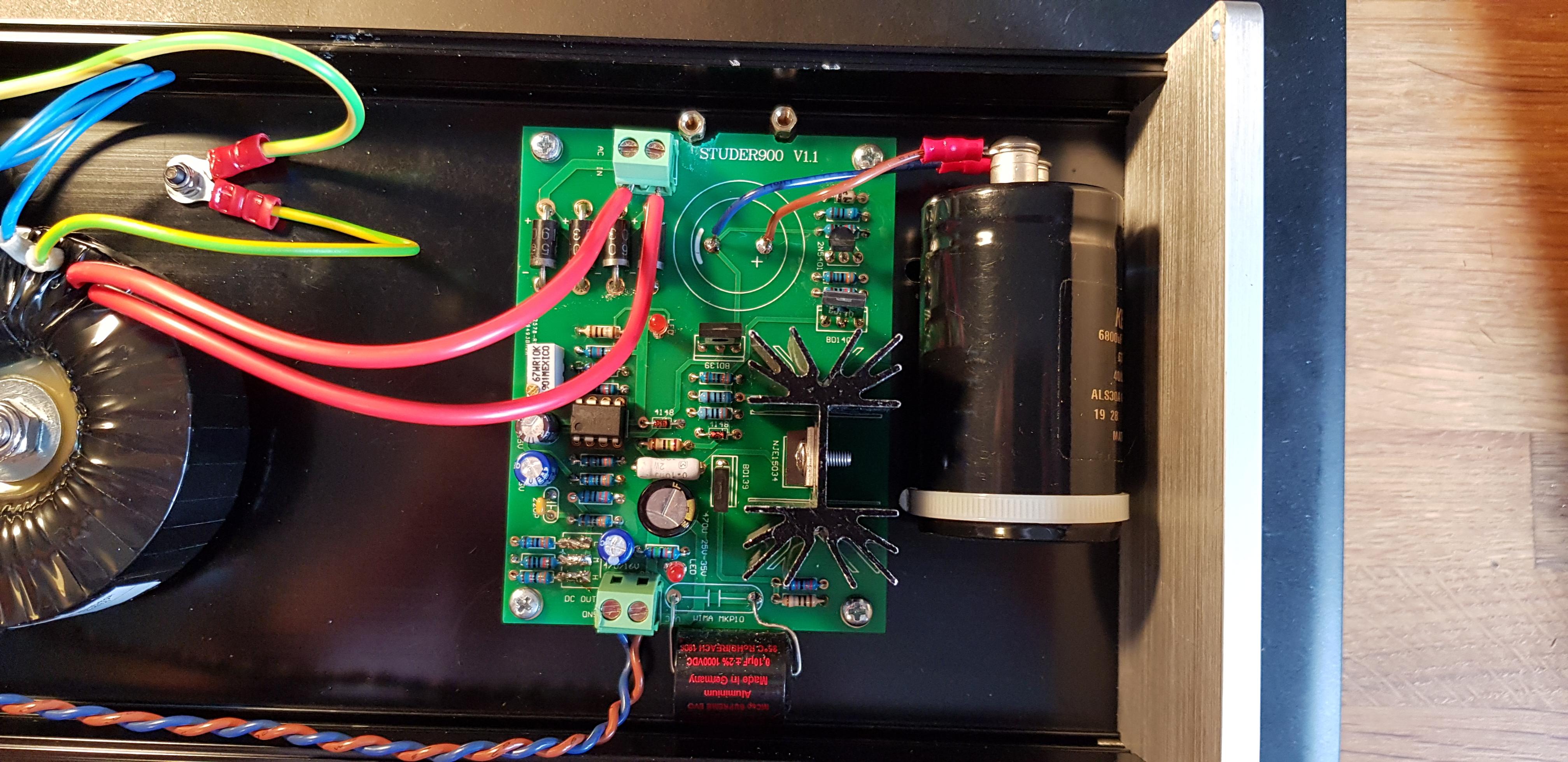

I need to correct an earlier statement, when I said that the Kemet ALS30 smoothing cap was not as detailed as the Panasonic FR pair. It turns out that how a big can is mounted makes a big difference in the sound. I had the Kemet on its side secured with a zip tie around each end. When I removed the zip tie at the top and used only the zip tie at bottom, the detail and HF was more balanced. However, having the zip tie at the very bottom edge of the cap’s case gave too much HF detail and too little LF as in the attached photo. So I found it best about 1cm up from the bottom....noticed that the high notes (piano, cymbals, etc.) are a touch dull.Their tone is dull, lacking the musical sparkle of my other power supplies. @200+ hours...

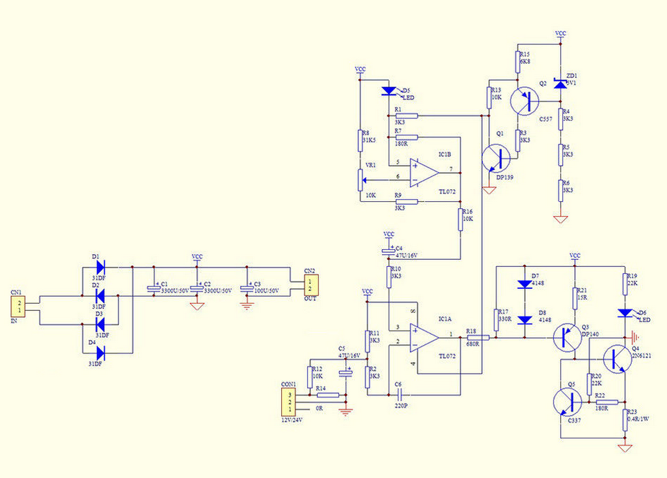

Hi Guy's. No response from Minisnow (E/bay seller) for several days. So will have to try to repair the unit myself.
Which for me with very limited knowledge will be very difficult. Fortunately these units will also work off of DC so I should not zap myself with 240 V.
So I need to know what is the MJE15034 is, is it a NPN or PNP type, so I can order a replacement.
Cheers
MJE15034: Bipolar Transistor, NPN, 350 V, 4.0 A

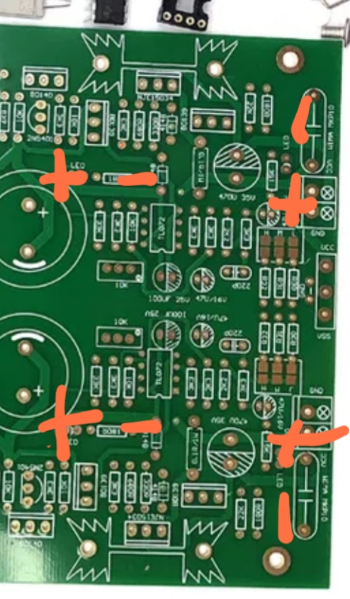

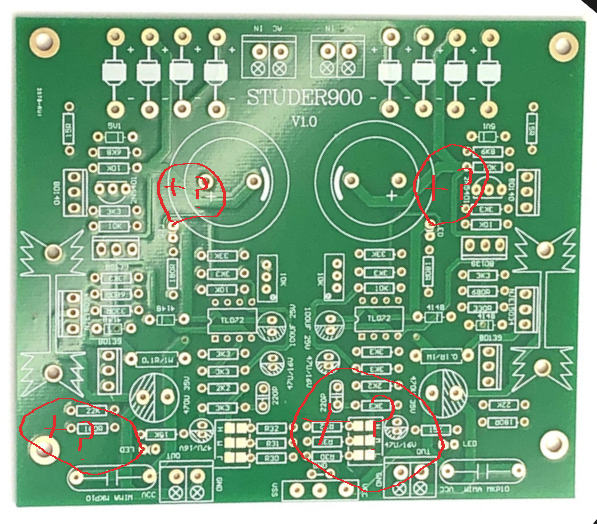

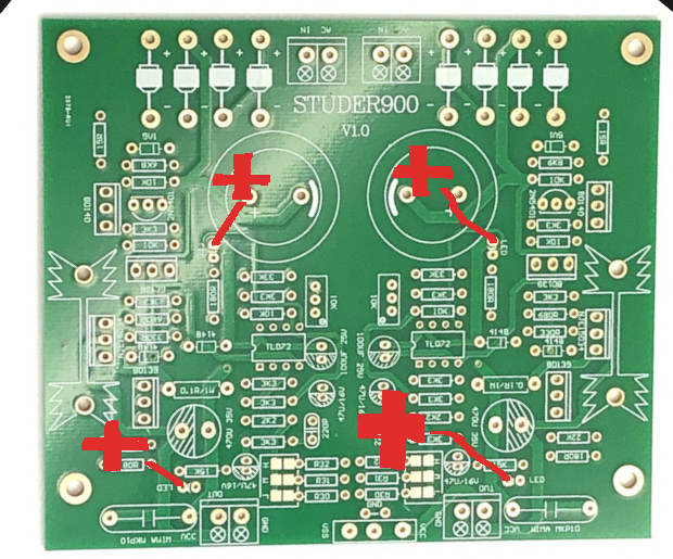

Can someone please detail the led pin orientation (for each led) on the dual supply board....thanks !
(the silkscreen is of no help as it is not logical side to side 🙁 )
