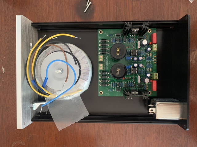

Just got some bits from Audiophonics including their Studer board. Stock current limiting resistors on my board are 0.1r. Got an 80VA 2x12v transformer, hopefully no issue there. Test fit photo attached.
Board is bigger than Audiophonics say: 118x101mm (NOT 117x95). Approx 45mm total height too (not 42).

Hi, I recently bought a ready-built Studer900 clone power supply from eBay and have just connected it up for the first time. I have a 20-0-20 traffo connected to the front of the p/s and a NAC152 clone preamp connected to the DC side. I'm building an amplifier for my son but am not an electronic engineer and have some, but limited experience with this sort of thing.
On power-up I was reading 22V DC from both sides of the supply but over a period of a few minutes (I was thinking/hoping it might stabilise somewhere around that voltage) the voltage ramped up to 36V and seemed to stabilise around that level. My preamp needs dual 24V. Am I likely to have killed it with 36V ? I do hope not !
The AC voltage measured as 19V as compared with about 21V no load. Is that drop normal-ish or a cause for concern ?
I am at a bit of a loss how to proceed with diagnostics. Any help or insight that anyone could offer would be very much welcome.

Hi Bo
I assume you have a dual supply board, so it needs input from two separate 0-20V windings. How have you connected your 20-0-20 traffo? You can't get 36V out from 20V AC so I think you must have been putting 40V in to the board.

Hi Jonners, thanks for your response.
Yes I have a dual supply board. The traffo secondary has 3 wires, two outer wires at 30VAC and a centre wire as ground. I connected the outer wires to the outside connector of each power supply input and the centre wire to the inside connector of one input, with a short link wire to the inside connector on the other side. This seemed logical to me.
I tested the traffo before I connected it up and I got about 21VAC between the centre wire and each of the outer wires, so if I was supplying 40V to the board, which is absolutely the logical conclusion, I don't understand how I did it. That conclusion, furthermore, is bolstered by the fact that, having removed the board and given it a visual inspection all around, it is evident that the top of each smoothing capacitor is bulging and the plastic jacket on one of them has split, presumably preparatory to venting itself. Worrying stuff.

Hi Bo
The schematic of this board is difficult to follow, but it is designed for two separate outputs which can be connected at the output end to create a dual supply. If the input windings are not completely separate from each other I don't know what would happen, but it does look like the main smoothing capacitors have had their rating exceeded.
I looked up an eBay description of the board, and it says "Input Voltage Range: Dual 9V-24V (4 line transformer)." I think that's the issue.
