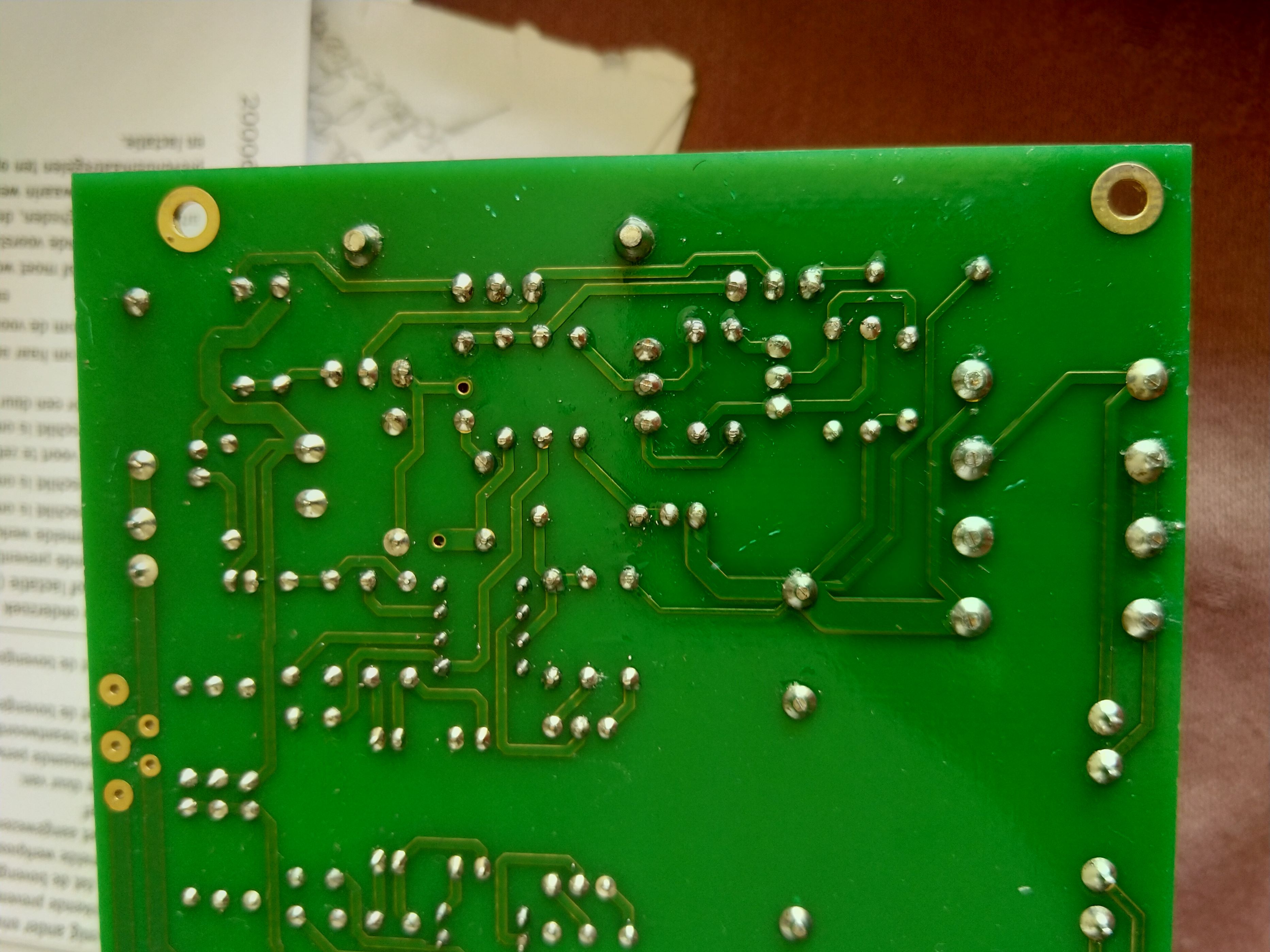

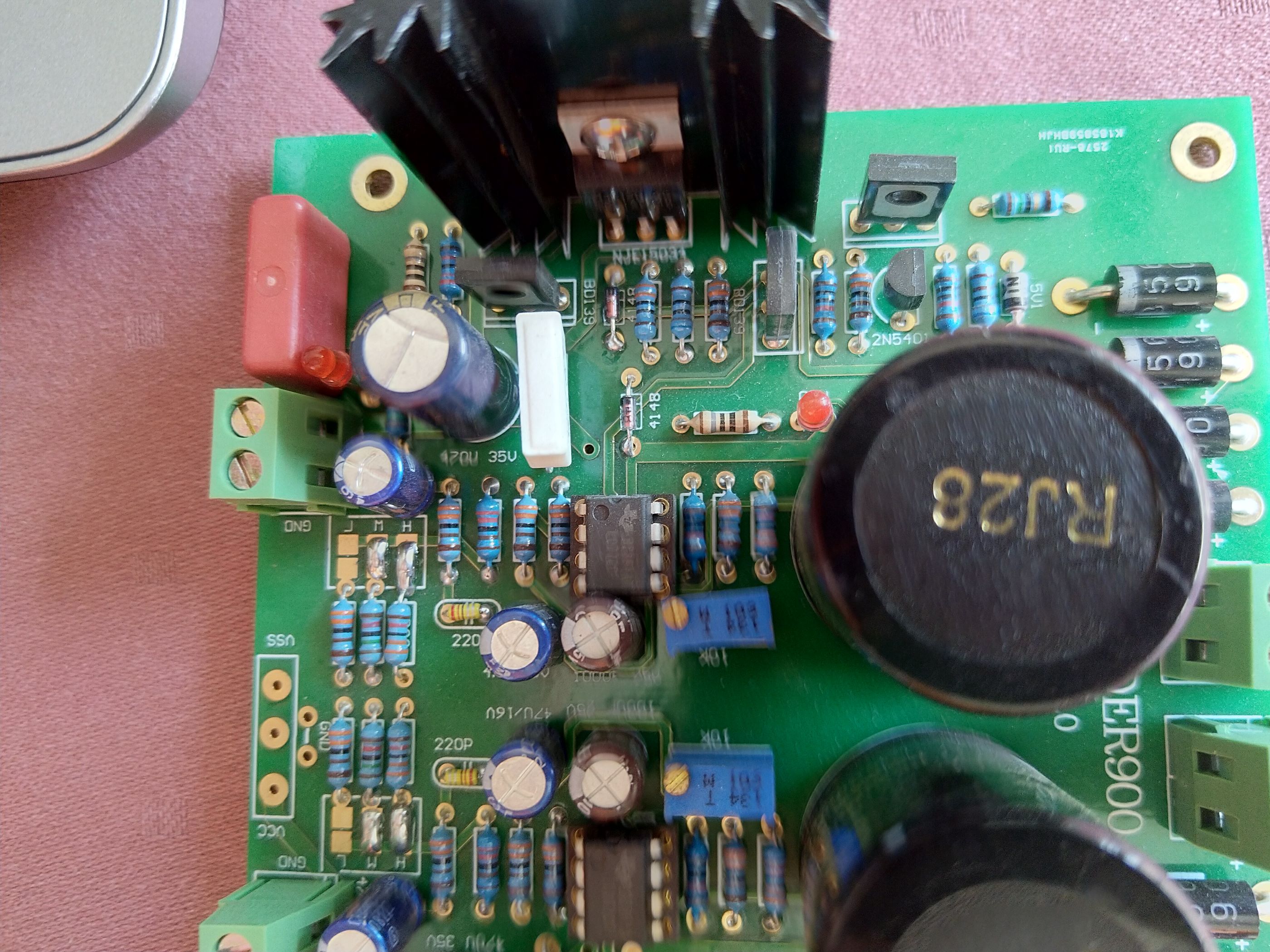

I just purchase this board and noticed the resistor (I think it shoud be 15 ohm) between the power restistor (0,1 ohm 1Watt) and the diode is missing.
Does this have any influence? I can't test it yet as i'm still waiting for the transfo
I can't seen a missing resistor!
There are two small holes , they are vias that take the current from one side of the pcb to the other. Maybe it is these you refer to?

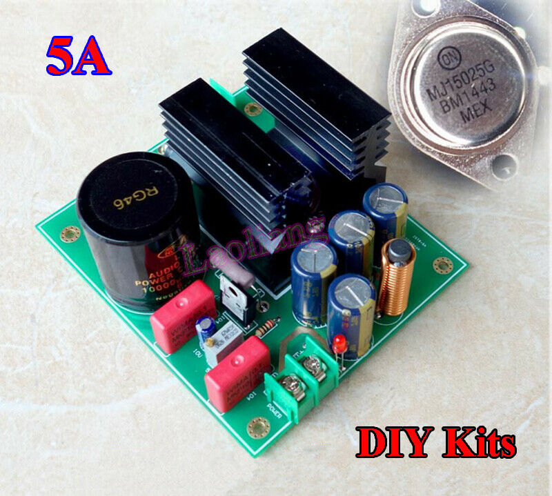

Your solution is a higher rating PSU, linear or switching should both work. This one on e-bay may work for you.
5A MJL15025 Linear High Current Regulated Power Supply Board DIY Kits Low Noise | eBay
I have no first hand experience on this board, but the approach seems to be what you need.
I have used several PSU board based on the L1038CP chip (in TO-3P case) for the 1-1.5A output range. It works well. The noise level is that of a straight LM317 without a de-noiser. It should be good for your application too.
Assembly LT1083CP Linear Adjustable Voltage HIFI Regulated DC Power Supply Board 699903130848 | eBay
