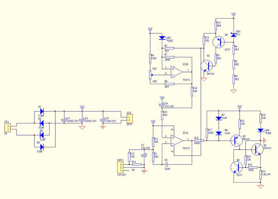

The other question I had is that only one of the LEDs light up (the one next to the big cap), should they both light or is the 2nd one an overload alert or something?
If the boards are in parallel they won't necessarily share the current equally and there could be some sort of interaction between them.
Both LEDs should light up.

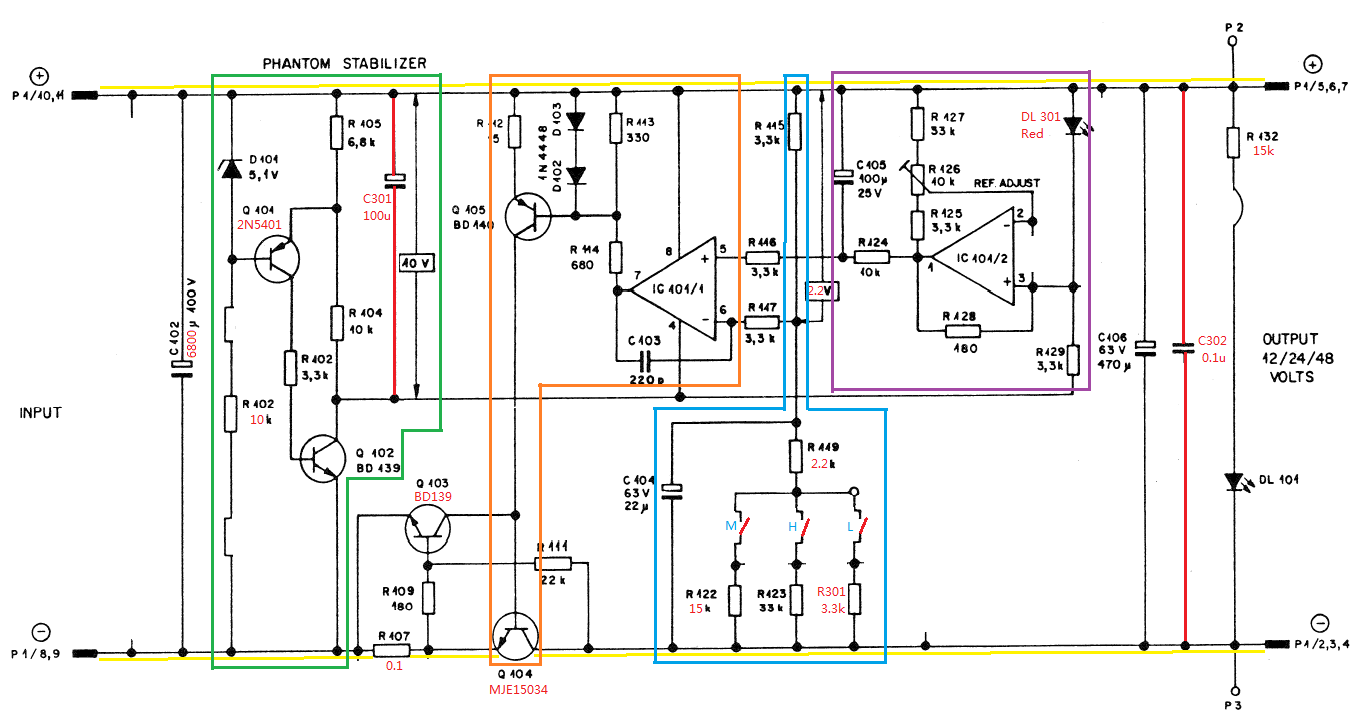

Without a schematic it's tricky to work out what its function is, if any, beyond being a visual indicator that the board is working. My guess would be that it is just an indicator or possibly that it also provides a small load for running down the charge on the board's capacitors.
You could try moving your supply and load connections to the other side of the board and seeing whether both LEDs light up on that side (don't forget to set the voltage). If they do then it's probably odds on that the LED has simply failed and you could replace it or just shrug and continue to use the fully working side.
