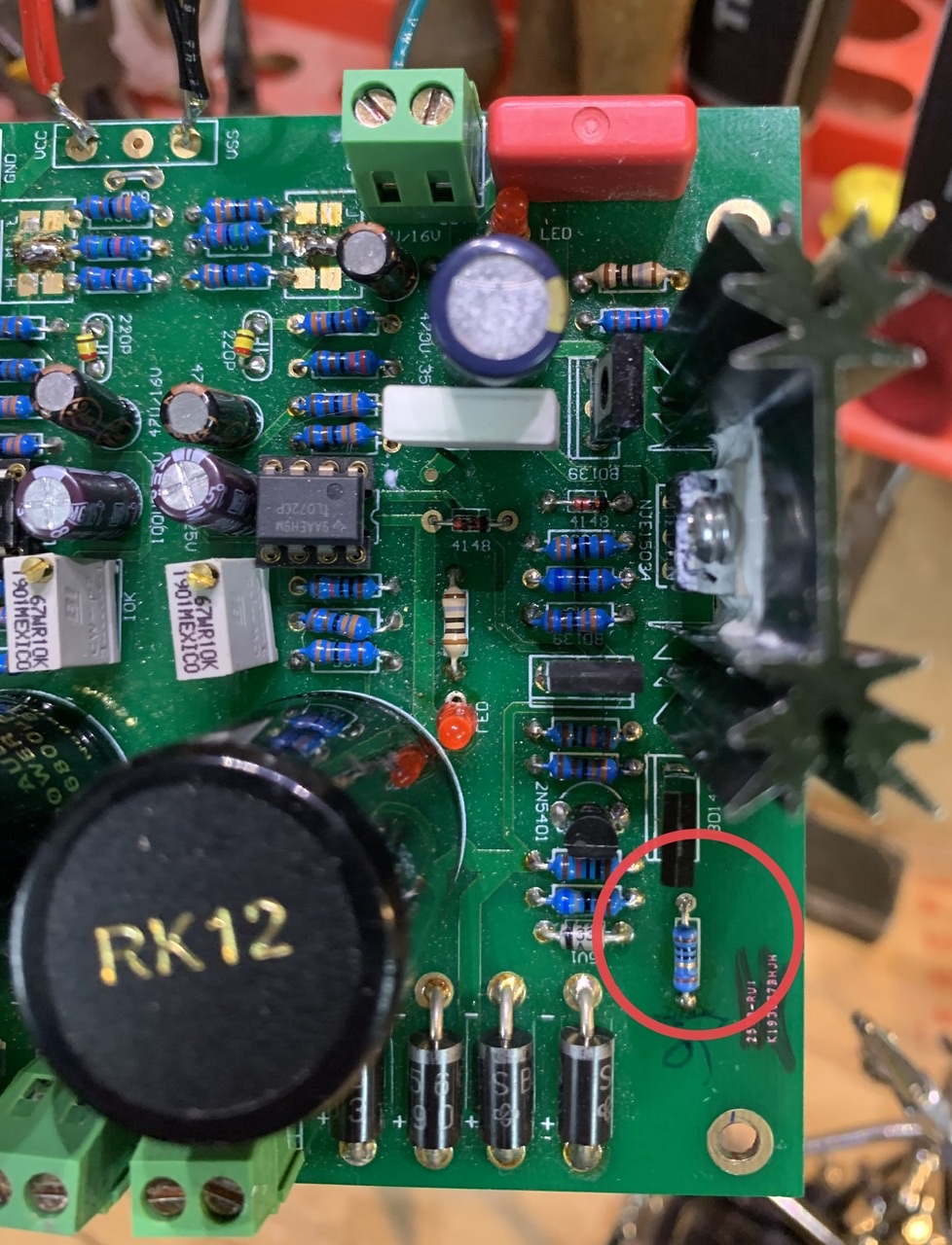

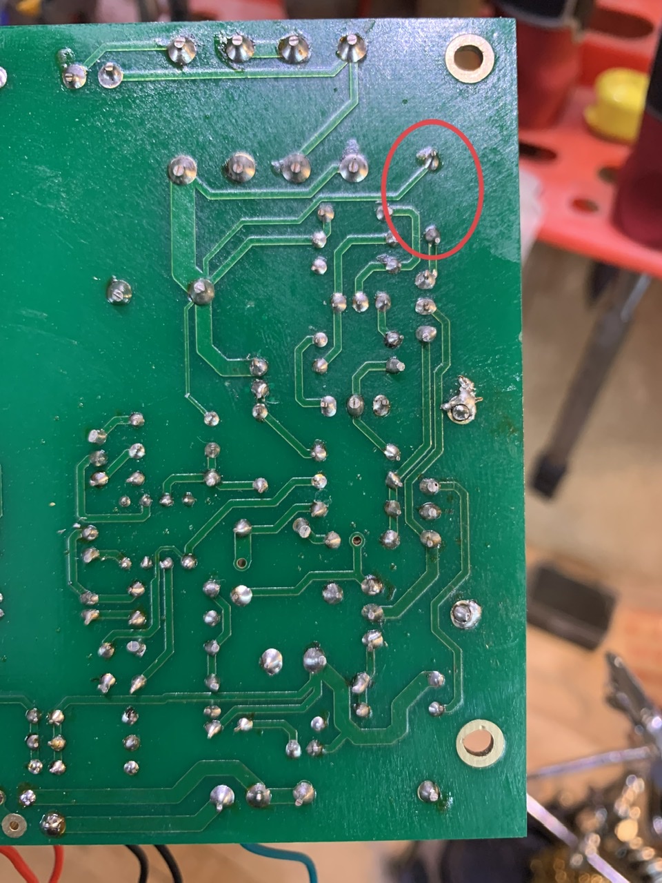

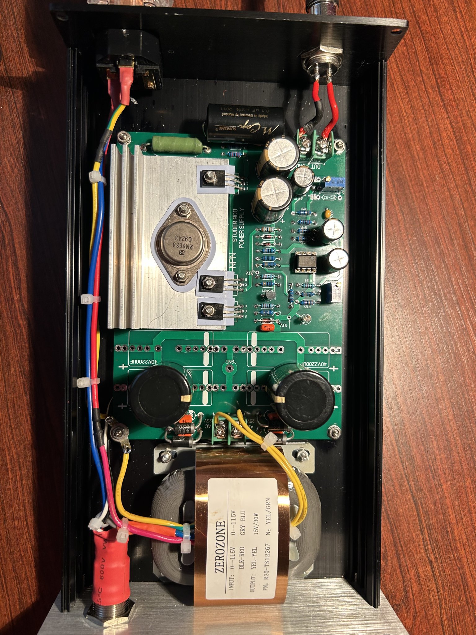

Ok, I’m hoping someone here can point out where I’m being an idiot. I had both sides of this PSU running independently for months last year but now I need it to run bipolar for my BA2018 line stage. I’m getting a solid 21VDC out of one side and nothing out of the other, plus one particular resistor on that side is frying repeatedly.
Here’s a photo of what the faulty side looks like. Please don’t laugh (or do but not where I can hear) at the soldering. This was the first I’d done in like 30 years. I’ve circled the resistor that keeps getting fried and included a photo of the transformer I’m using.
I’d appreciate any thoughts or advice as I can’t move forward with the line stage until I get this sorted. Thanks
Well if i see right it seems to me a 10 Ohm resistor, the one which limit the emitter current of BD140 PNP.

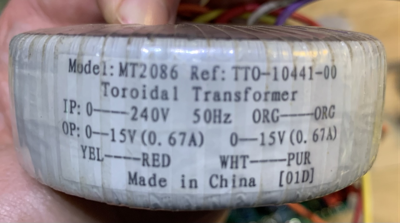

Do you have a transformer with 15VAC secondary? if yes that is roughly 21,6 V unregulated voltage. You will fry also the transformer and diodes to have 21VDC output. You have too less time to load capacitors and deliver current to load. Maybe the load you have is really small and this did not happened yet.
Not only the resistor fries but also the PNP BD140 should be very hot and small like burnt.
Change transformer to 24VAC and it will work.
With your transformer the BD 140 has to deliver very high current in the base of the MJE15034 in a very small fraction of the sinus....It is over the limit.

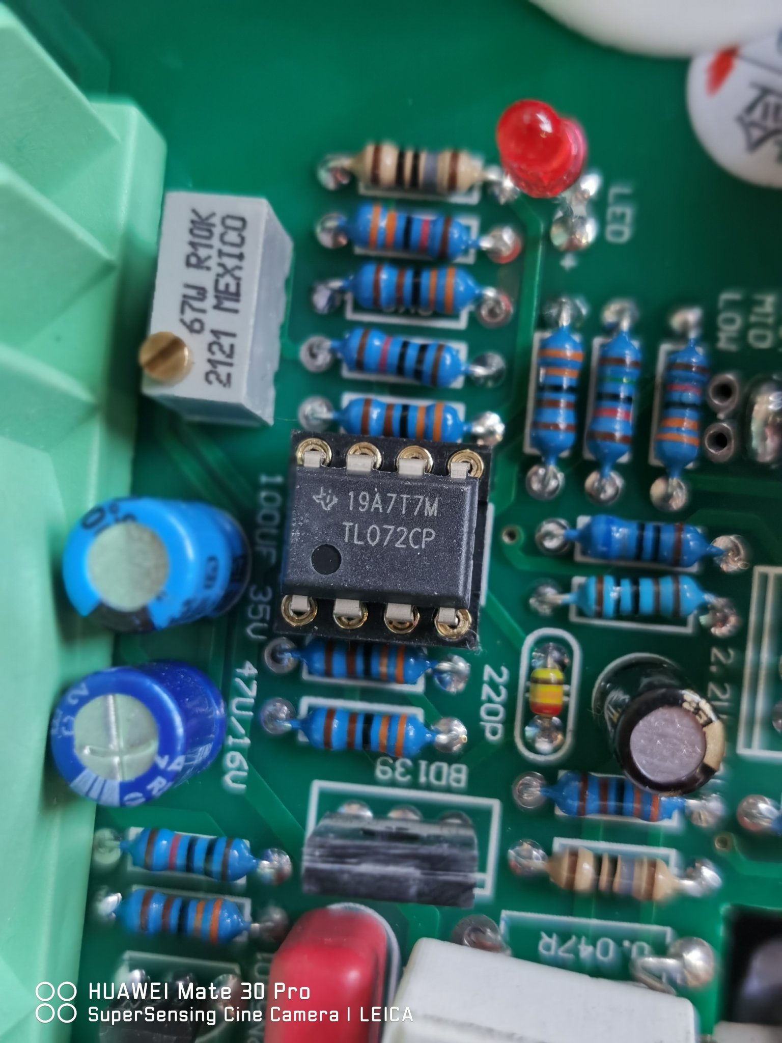

hey guys, is it possible to replace the original opamp TL072 directly with something better likes MUSES01 or MUSES02 (Studer900 LPS)?
I did try dual ADA4627 as well as LT1057 but the LPS becomes hot and suddenly stop working without power on after 1 or 2 days using until i plugged the TL072 back to the circuit.
I've tested a few different opamps - and the one I find best is the TLE2072. It makes a nice improvement to the sound.

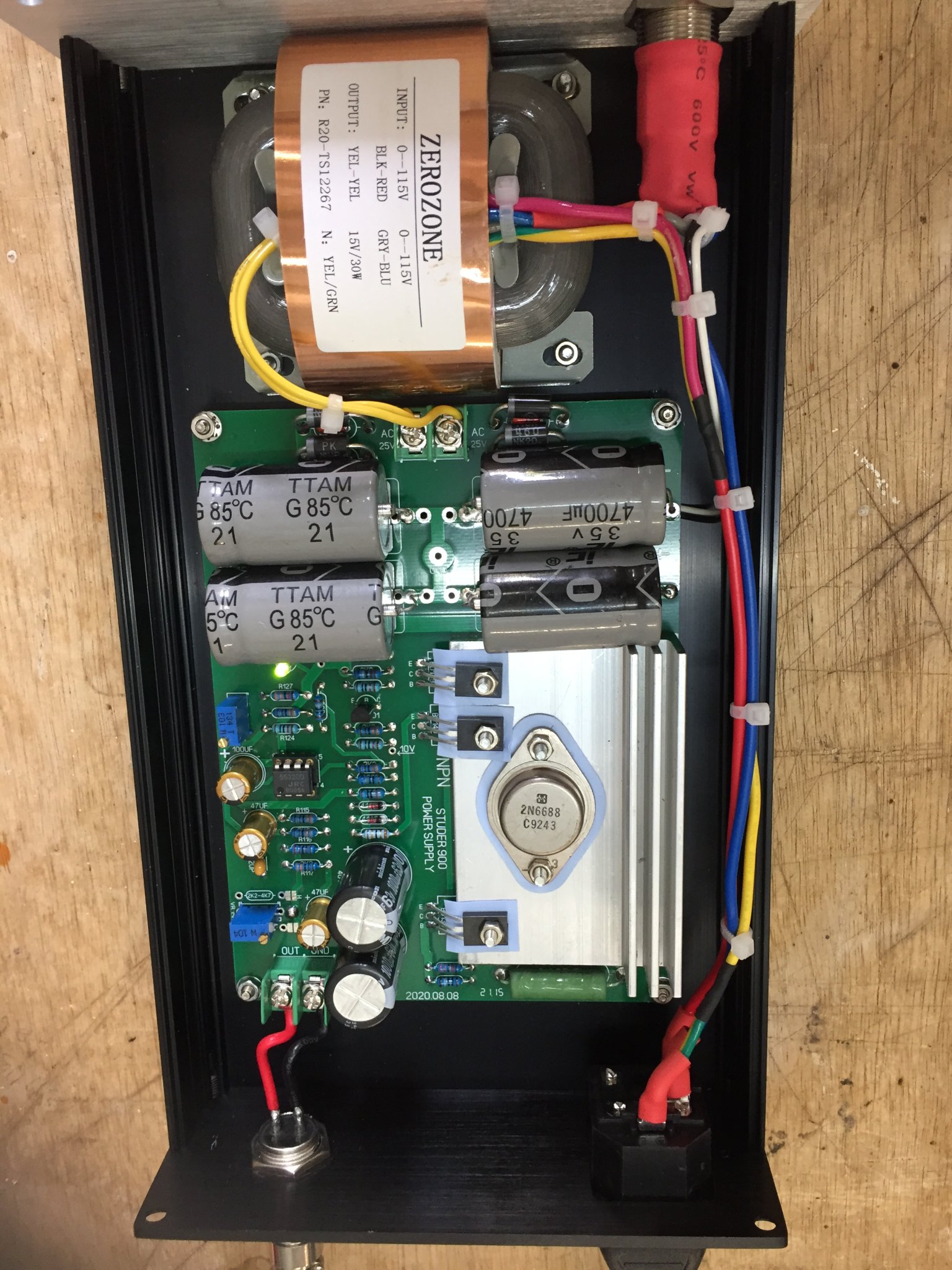

I have recently purchased a version with a new board layout which has a larger heatsink and a variable resistor to set the main voltage. It also has quite a bit of room for upgrading the caps which I have done (as well as fitting a proper earth connection to the chassis). Here is the original version before modification.
Here is the modified version.
