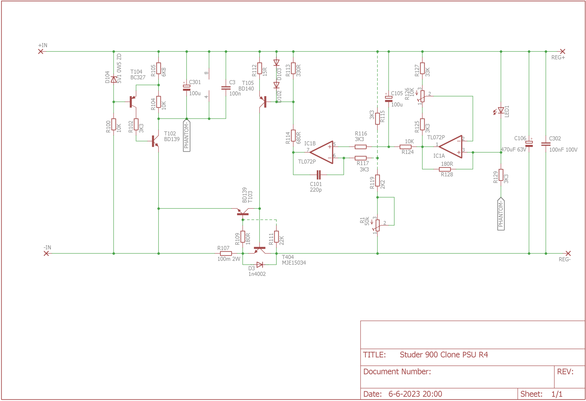

Compare quiecent current to see if the OPA draws significantly more current per amplifier(2x in one package) another option is that the frequency compensation is not right. Another is that the output of the OPA cannot swing high enough to force the BD140 transistor into cut-off.
The last option is plausible. Looking at the available schematic, we see that Q105 has 330R between base emitter, and the OPA is connected to that node with 680R resistor. So if the opa cannot approach + supply within ~2V it cannot "close" Q105 and it will continue supplying current to Q104 Bellow => output goes low.
You can test this hypothesis by changing the resistor R114 to 1K or 1K2.
Edit I just read the OPA datasheet, scratch the output stage hypothesis, you are replacing a 3Mhz FET input opamp with a 400Khz bipolar jobbie, that is bound to give issues, its likely oscillation or latch-up.

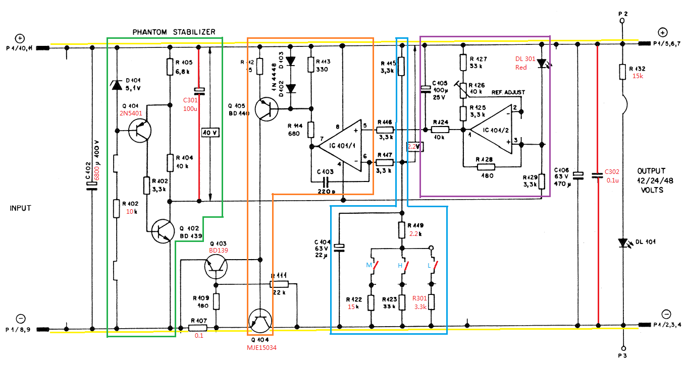

Looking at one of the circuit diagrams posted earlier in this thread, it seems there are some output caps. Is it possible I fried the direction one when I plugged my headphone amp in backward? Is it possible a spike caused by frying the caps on my amp have caused a feedback which fried the cap on the PSU?
Sorry, no idea. I'd think the danger to the amp was greater than to the PSU from connecting them backwards. If this was sold as a finished 18VDC supply, I'd hope the transformer and circuit config were up to it, though it should be printed on the side of the transformer what its input and output are. If the jumpers for 120 vs 230VAC were done wrong/not done and it was plugged in, that could fry things.
