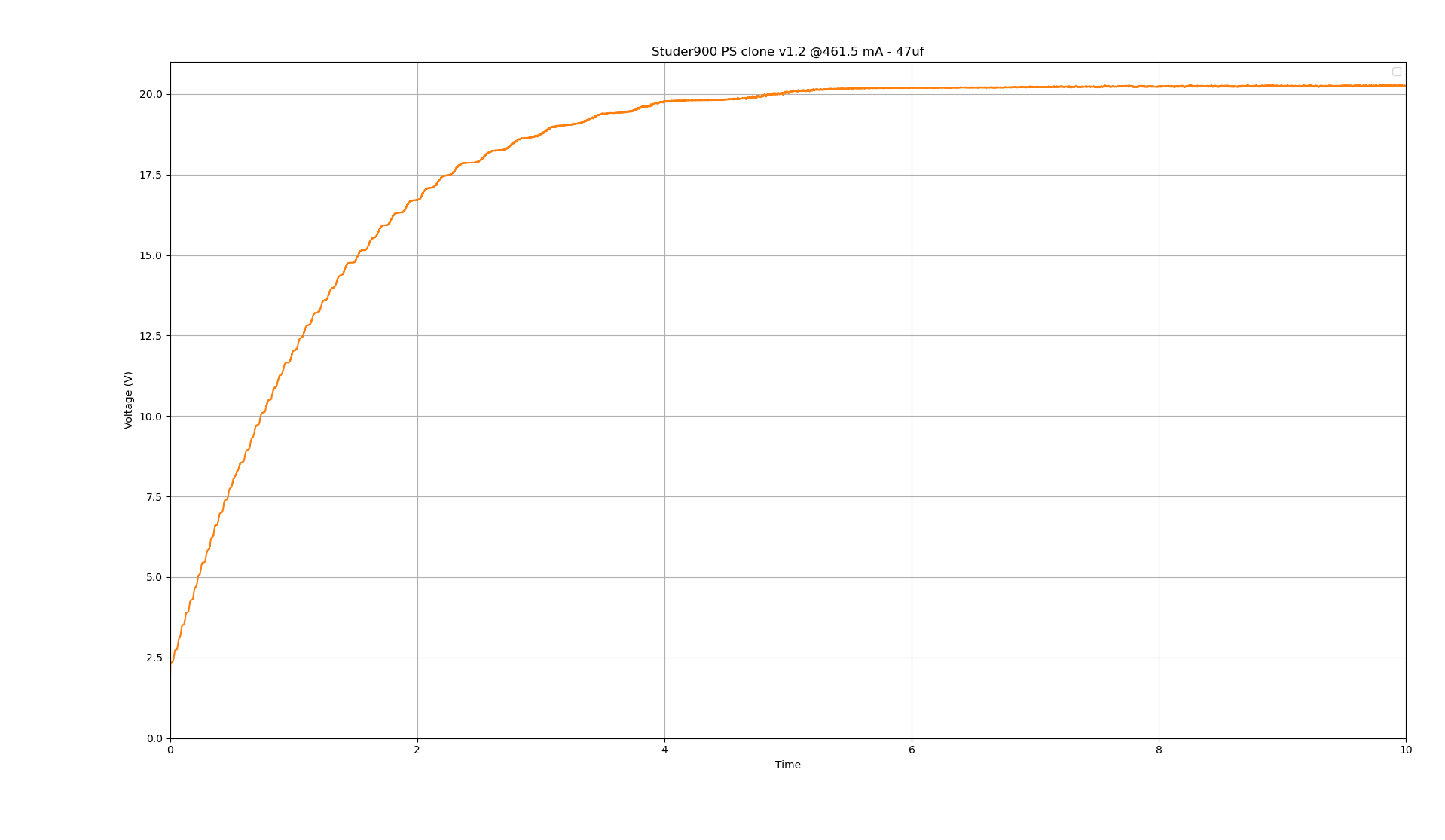

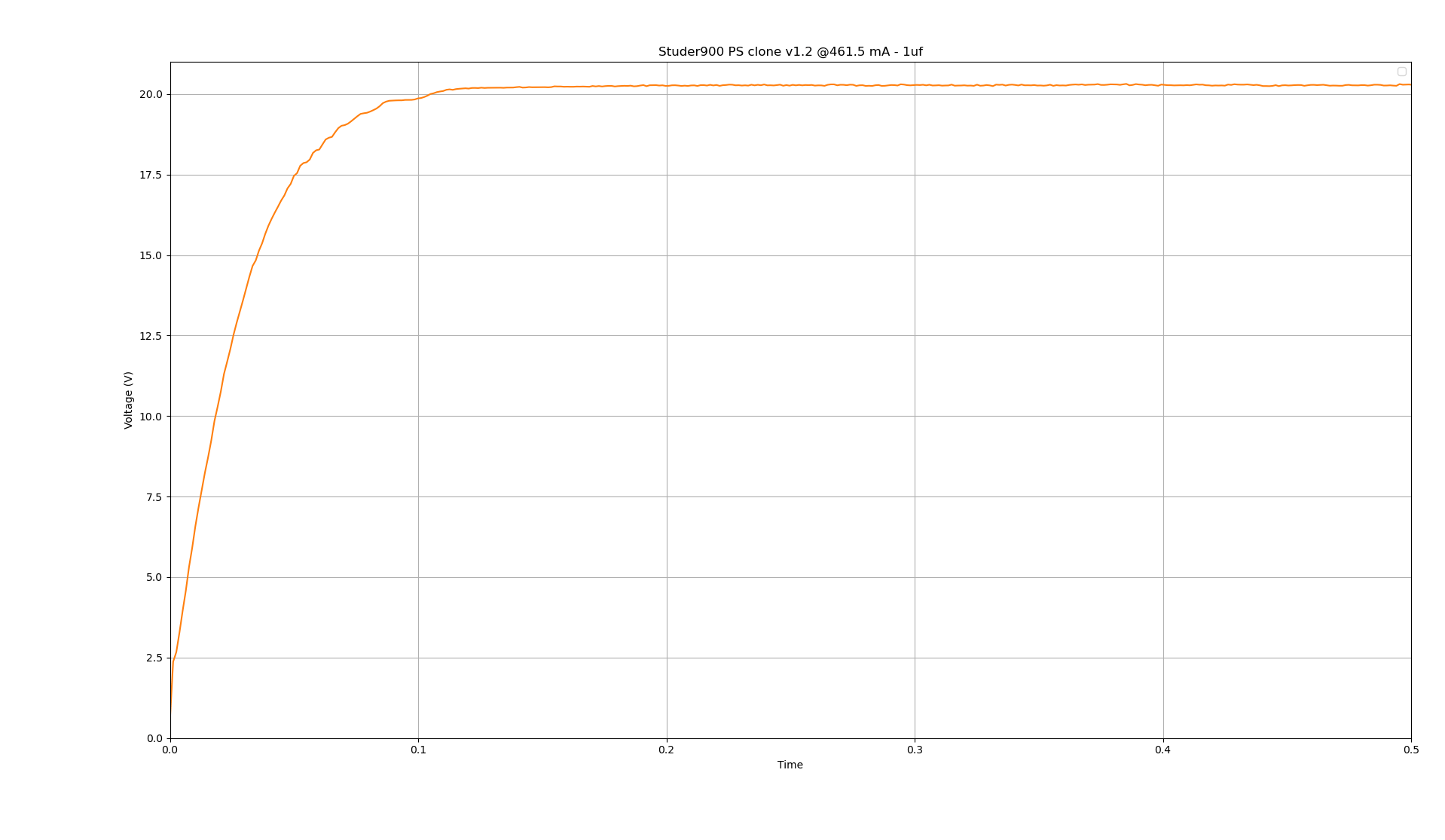

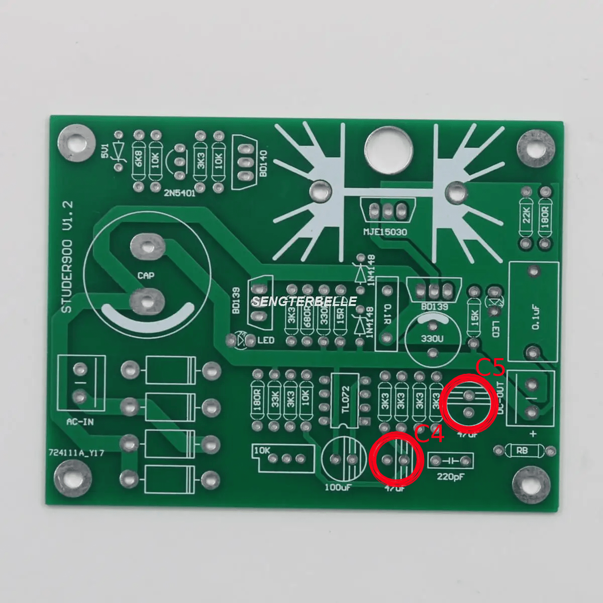

Aliexpress v1.2 board is taking ~6.5s to reach 21V on the output with 23.6V on the input bulk cap. This is not reasonable for my use case.
Thanks to this post (other schematics shared by the members aren't accurate, for the v1.2 that is) I figured it's the C4 and C5 that define the run-up time. Replacing original 47uf with 1uf caps shortens the run-up time to ~0.25s.

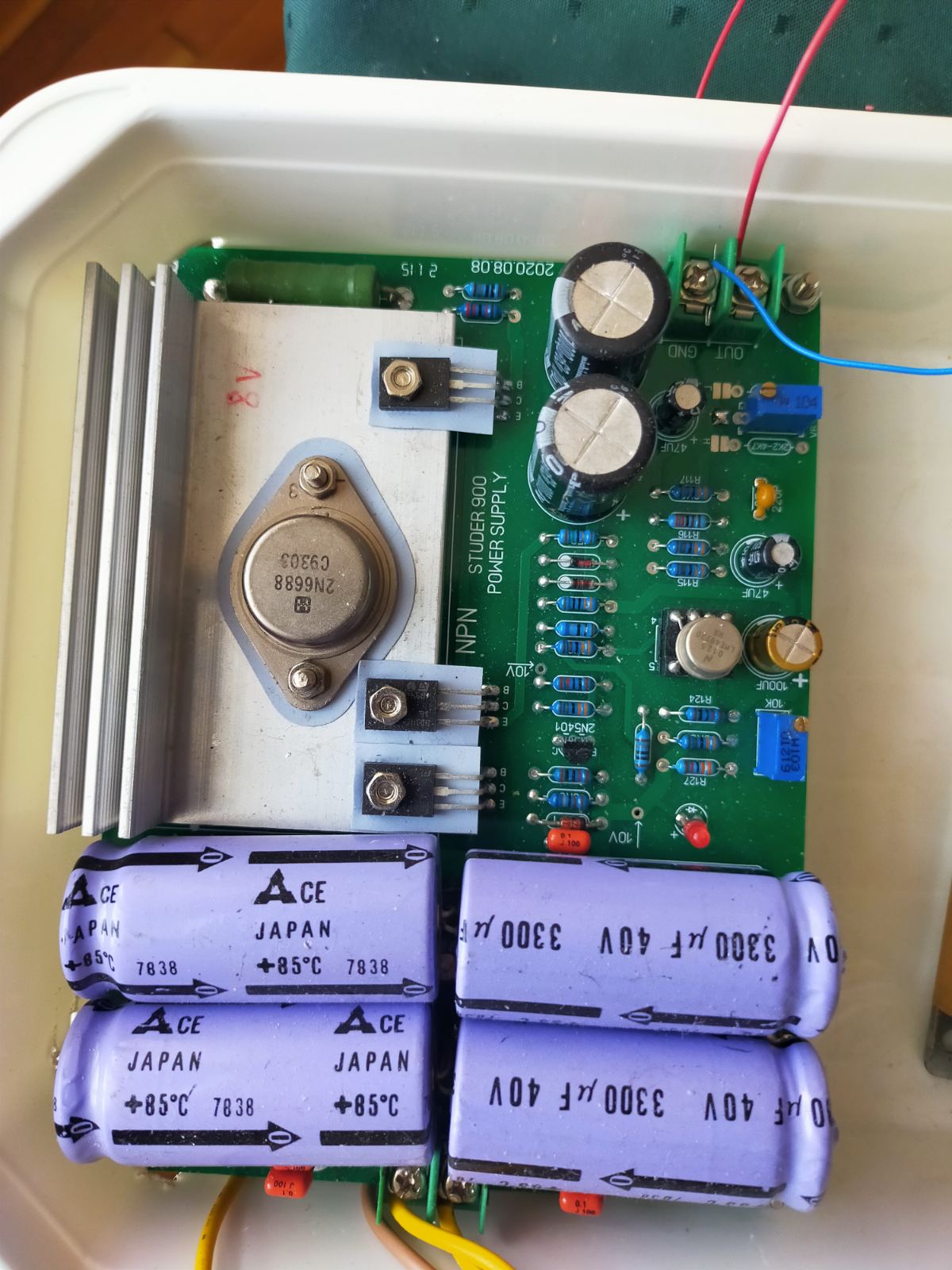

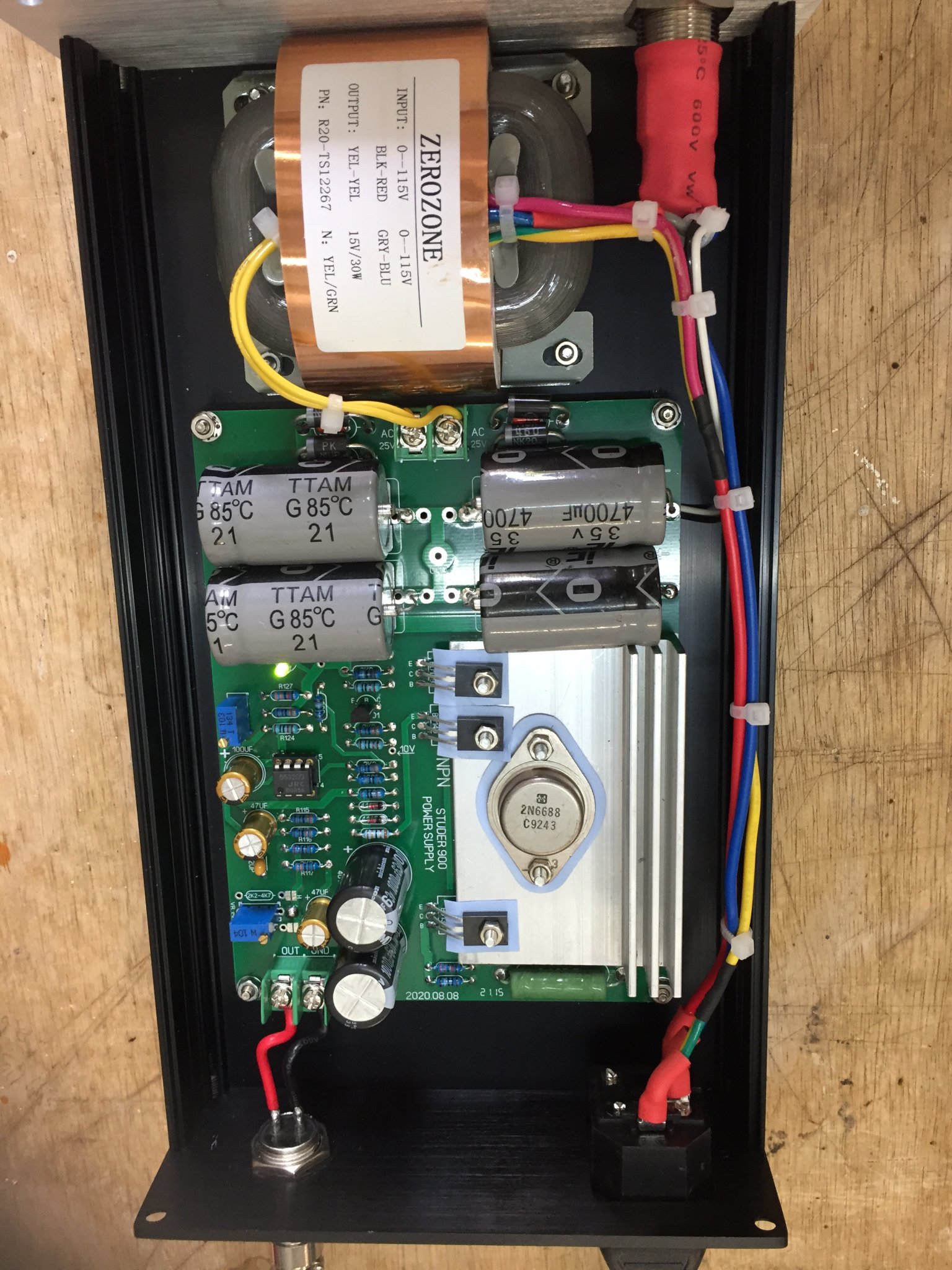

I have recently purchased a version with a new board layout which has a larger heatsink and a variable resistor to set the main voltage. It also has quite a bit of room for upgrading the caps which I have done (as well as fitting a proper earth connection to the chassis). Here is the original version before modification.
Here is the modified version.

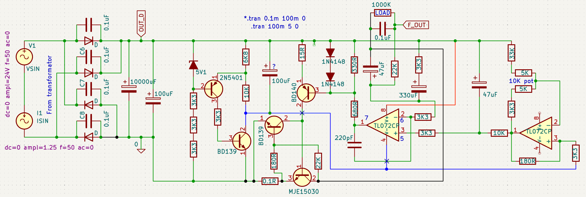

Hi everyone, I'm planning to build a PSU for my DAC and Headphone AMP based on the Studer 900 schematics found here.
Do any of you have an "improved/ new version" schematic that I could use in KiCad? (Or replicate)
I need a 24V ~1A and a 5V ~1A output.
These can come from two total separate boards and transformers, I don't mind.
If I don't need variable output which parts should I exclude from the schematic?
I'm a total newbie in this area, sorry if I'm asking someting stupid.
Thank you!

If wanting to lock in a voltage with only slight tuning adjustment, you can:
- use PCB version 1.2 and only has one trim pot and one voltage set resistor (RB).
- For other versions of the PCB use a combination of 2-3 resistors to set the main voltage (L, M, H). The seller description often tells how to use them to set the right voltage or use this post no.68.
- For the boards with the the large shared heatsink like the one pictured above, replace the top trim pot with the 2-3 resistors above.

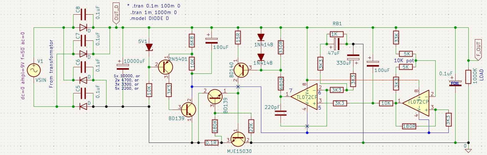

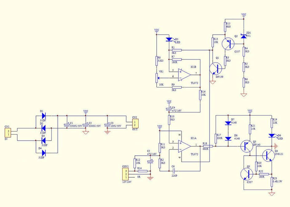

Yeah I've rotated that, and corrected some connection errors, but somehow I made it worsethe 5V1 zener is drawn the wrong way around in that schematic
I guess it's going to be easier to make a new one, I'll try to copy #385, but I'm not sure what CON1 and CN2 is for.
CON1 is yours F_OUT with ground and CN2 is absend on that board, just connect cn2 to VCC and GNDI'm not sure what CON1 and CN2 is for.
Thank you,

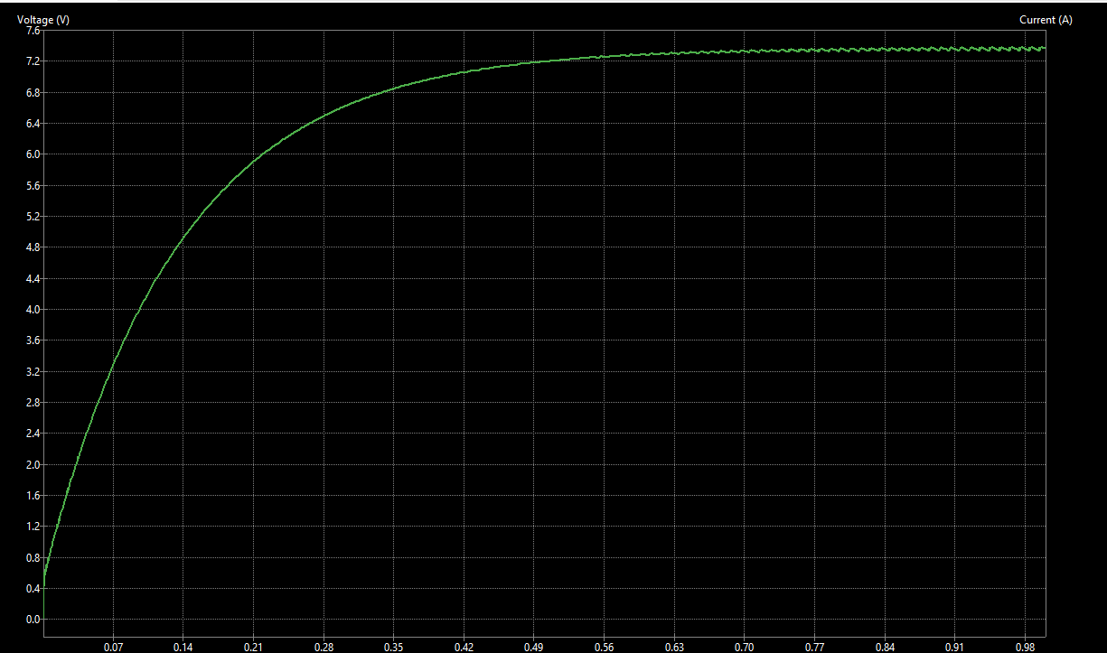

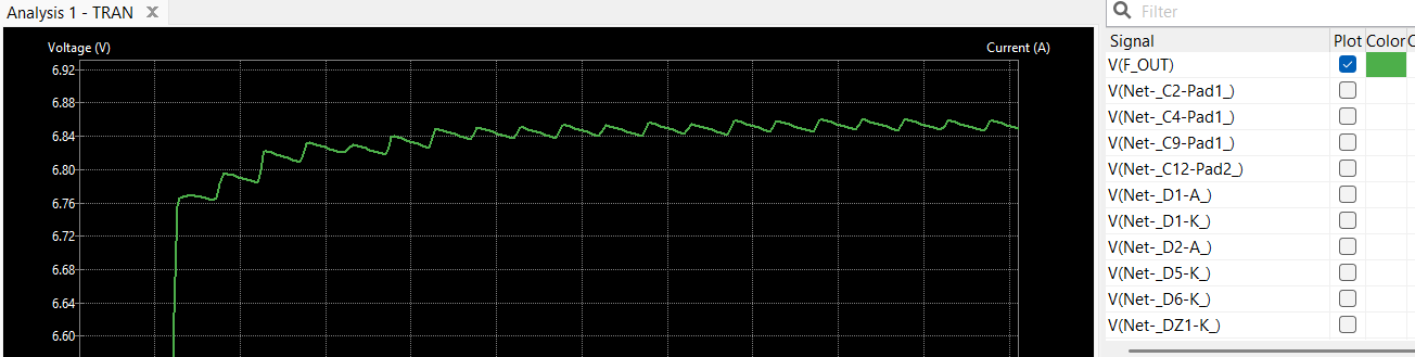

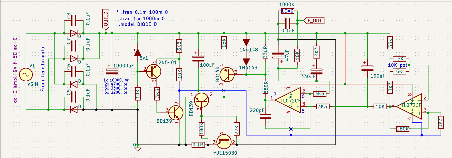

I tried my best to replicate the schematic, but it still doesn't seem to work.
Is it the makeshift 10K potmeter? I tried changing its values, but didnt seem to do anything.
I traced down every route, but I didn't find any errors, hopefully I'm just blind and its something put in reverse again.

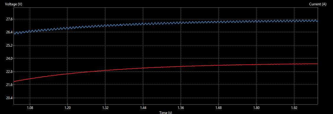

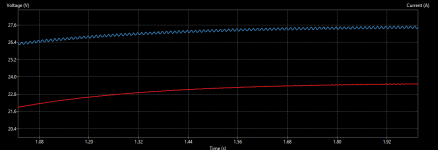

Blue line is OUT_D (From Diodes + 10kuF cap), Red line is the output.
