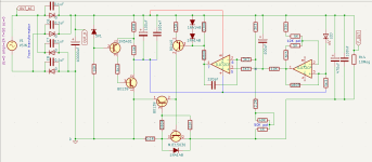

where is the red led near the right opamp?
Oh, I forgot those.
Seems to be good now, after adjusting the potentiometer to 1K/9K.

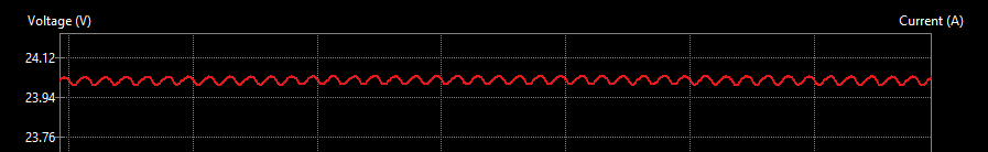

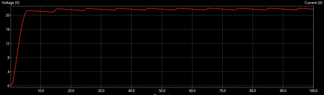

The output is still "wavy" or is this how it supposed to look?
Thanky you btw!
Its supposed to be a straight line. perhaps this is oscillation?
I have no idea, but I couldn't fix it, so I remade the whole thing from the schematic in #343.
The output is still bad tho.
What I've noticed is that modifying the potmeter values does nothing to the output, but I cannot see any wiring mistakes.
+If I lower the value of the 10KuF filter cap, the sawtooth becomes steeper, but increasing doesn't fix the issue.

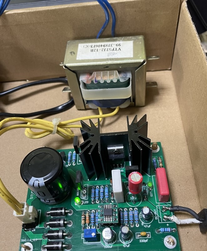

I started the board for the first time today with 12V output and 15V AC input, and as I expected MJE15030 get very hot (70-80 degrees open air) with 3.5cm radiator (as on aliexpress boards) with low load. Should I decrease input voltage or better to change radiator to bigger one ?
