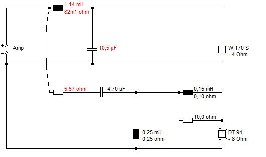

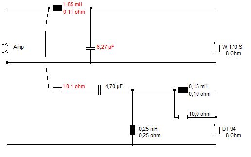

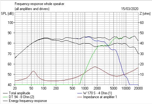

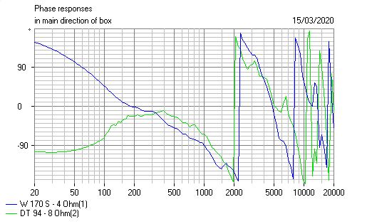

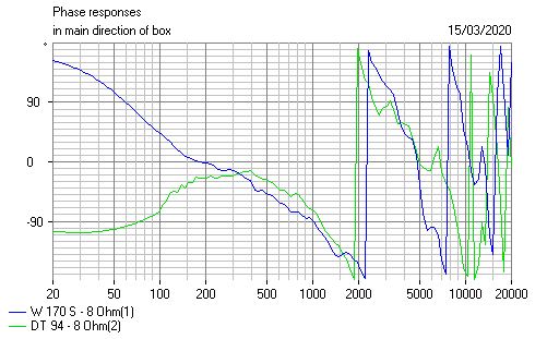

Anyhoo. I decided to sim a 6" woofer here in 4 and 8 ohm:
W 170 S - 4 Ohm | Visaton
W 170 S - 8 Ohm | Visaton
TaDa! Draw your own conclusions... 🙂

My friend, there was no deception that I was simulating a constant-voltage source here. 🙂
Which is what the average Joe, like myself, owns.
715078d1542007725-restoring-monitor-audio-r300-bookshelf-speakers-monitor-audio-monacor-ht-22-cone-tweeter-jpg
Draw your own conclusions? I know 4 or 8 ohm is invariant on the guage, mathematically. 😎
