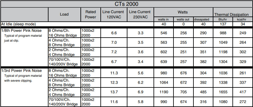

This doesn't sound right. What is the logic behind it?One creates more heat than the other. Who wants more heat, raise their hands
Higher ohm system = lower THD....
It depends on using the right amplifier for the right load.
Isn't the understanding that higher watts creates more heat?
This is incorrect. For the same power input, the same heat will be dissipated. As I wrote previously, in going from an 8Ohm to a 4Ohm driver, the current may increase by a factor of sqrt(2), but the voltage will decrease by a factor of sqrt(2) if the power input is the same. The net result is that the power dissipated by the coil resistance will be the same also.
