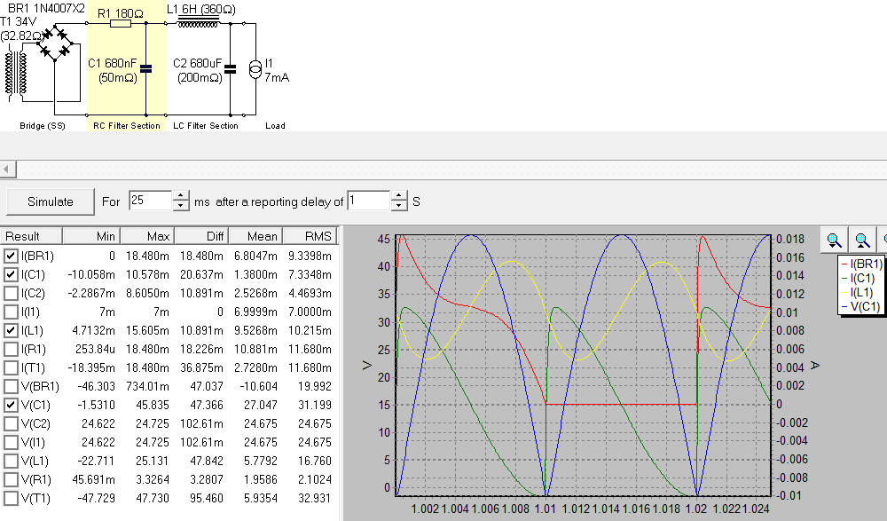

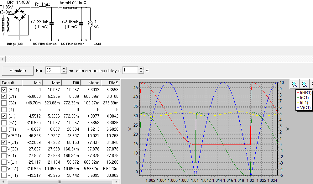

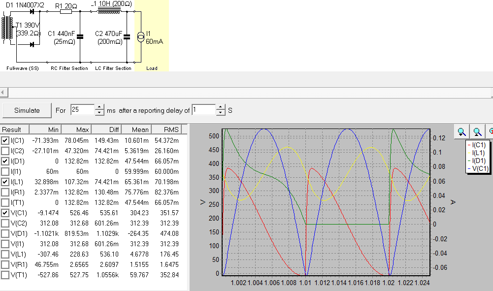

All I could find to dig up were these three power supplies I designed for a pair of amps. A high Voltage supply, a high current supply and a high impedance low Voltage and current supply. Each was built and used.
The takeaway is the philosophy has been translated orders of magnitude apart.

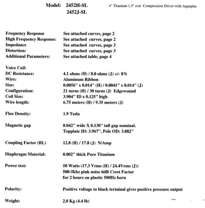

Comparing the 4Ω and 8Ω versions of the Faital 12HP1060 show some differences.
Most obvious is the Mms of the 4Ω is 138.7g while the 8Ω is 126.9g
The 4 ohm motor will be "stronger" than the 8 ohm one, ONLY if you keep voltage constant, which in due time wikkl drive current I.YSDR
And the motor force factor is obviously more on the 4 Ohm version. More moving force results in a lower Qes, hence lower Qts. Motor force factor = (BL x BL)/Re.
But that is cheating, because you are now applying twice the power!!!!
The fair and proper comparison means applying same power to both, so lower voltage to the 4 ohm one. (0.707x)

This shows very clearly how JBL uses the thickness the wire used in edge wound coils to determine 8 VS 16 ohm in their assemblies. Example 2452 compression driver.
