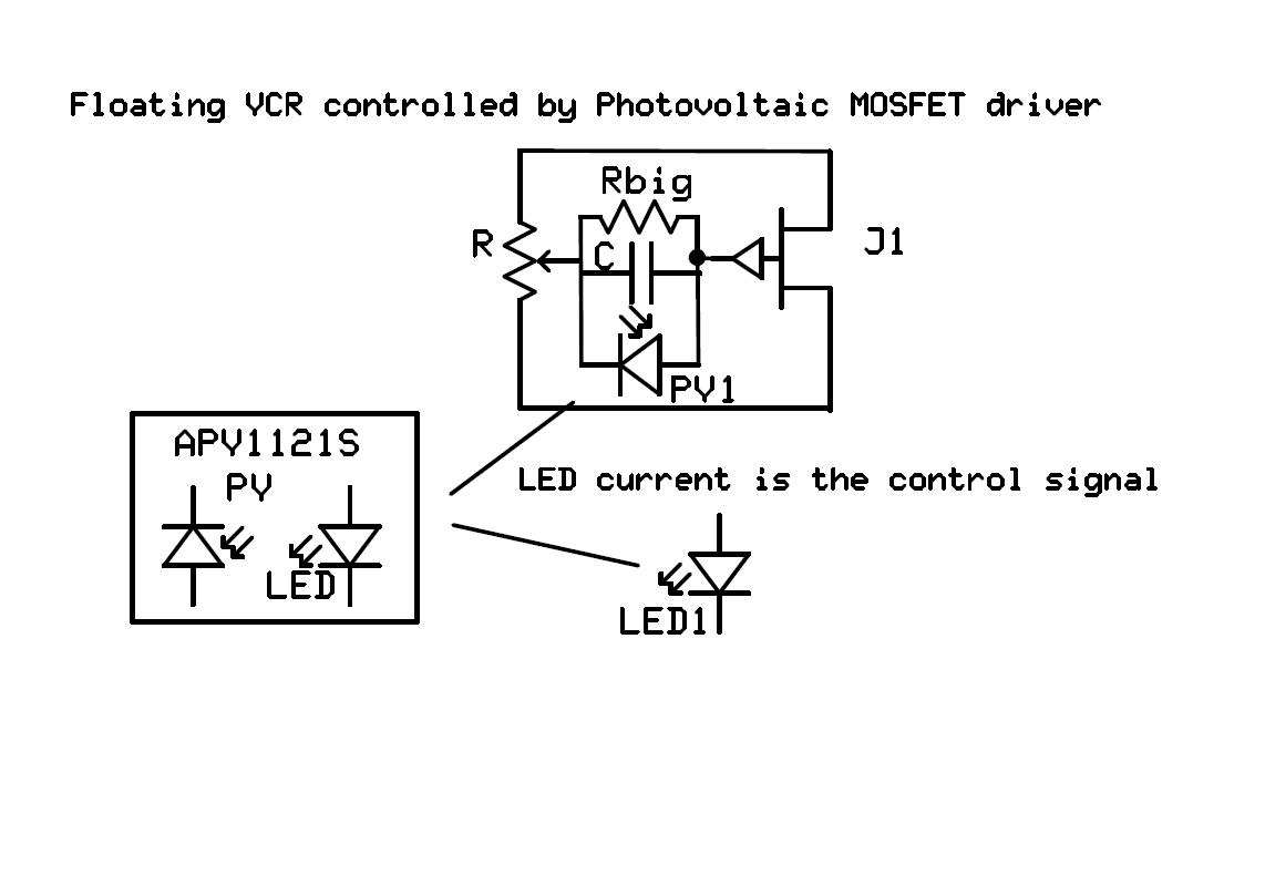

Here's my idea. The photovoltaic MOSFET driver generates a small isolated current with up to 8V compliance. You just force this current into a large resistor to control the gate voltage of the VCR. The RC can be at a very low frequency rather easily. I envision a second control channel could be used to cancel the thirds, thinking out loud right now.
That floating VCR controlled by a Photovoltaic MOSFET driver is rather clever. The isolated control opens up some possibilties.
I think that it is similar in function to the Photo FET Optocouplers like the Fairchild H11F1M but lower distortion.
I am messing around with ideas to meet Samual Groner's reasonable and realistic design goal for a very good DIY oscillator. Progress is slow though because I am back at work unfortunately (bad for my sanity but good for the bank balance).
