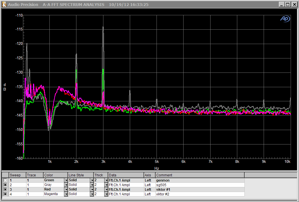

looks like Samuel was right and the shown results were unreal in terms of absolute levels. The synced averaging and the AP graphing methods are to be taken with a grain of salt (and there are still some real and annoying bugs in the control software), especially for less experienced operators like me.
==> Forget the previous plot I posted in #730.
I measured again, now with traditional spectrum averaging (128x) and results are way more realistic now. The differences between the DUTs, though, remain fairly constant.
Two pcs. of Viktors' 1kHz Osc were tested, I see a slight increase of LF noise vs AP Genmon and the SG505 but the harmonic purity is outstanding and seems to be consistent.
I also looked at settling after a level change, at high level settings it settles quite fast while a the low end (at 300mVrms) it bounces up and down a little for some seconds.

Thanks very much for revising the measurements--that looks valid now!
The exact performance of the SYS-2722 depends a bit on the age, as later units have certain improved subcircuits. The one I'm using has around -135 dB (analyzer) and probably -140 dB (generator--measured with passive notch filter) 2nd and 3rd harmonic residual at 1 kHz.
So in your plot the distortion for Victor's oscillator could well be from the analyzer.
Samuel
PS: Yes, the synced average mode is tricky. Hardly ever use it therfore.

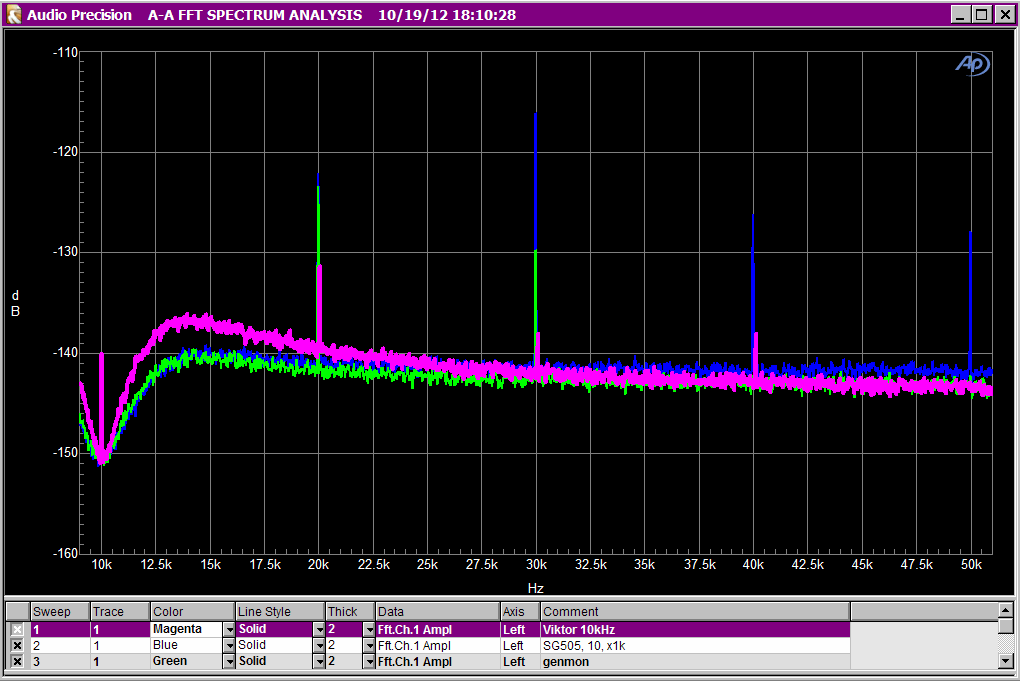

Follow up with the 10kHz version.
The AP genmon trace again has higher 2nd and 3rd, above that it's in the noise.
Viktors' is better in 2nd and 3rd harmonic but some 4th is visible too.

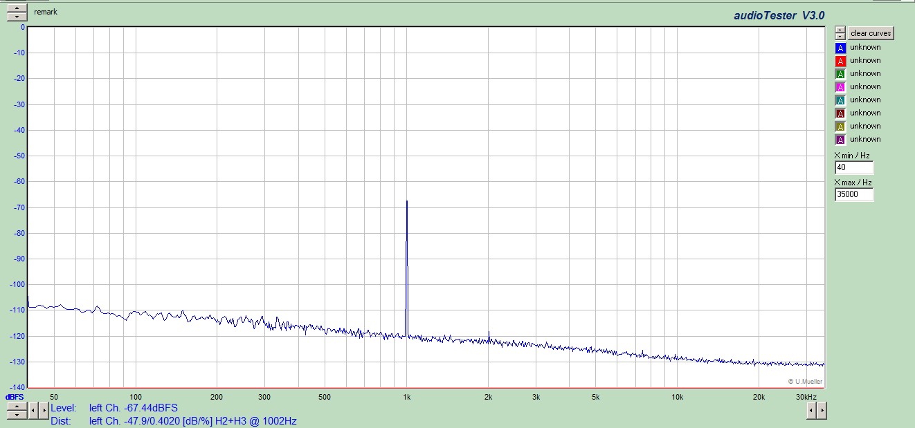

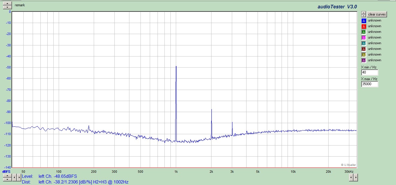

I repeated my measurements of Victor's oscillator with notch filter, to attempt to clean up some of the noise I was getting previously from a sloppy test jig. Pretty impressive results - All I could detect with 1.76V output was the 2nd at -139dB below fundamental, and that's barely detectable. This is 0.000011%, that's four zeroes.
During amplifier testing I noticed the oscillator does not care to be loaded down with your circuit, so I put this signal into Pete Millet's soundcard interface, which has a gain of 2, and balanced line driver output.
Then I get 2nd at -122dB below fund, and 3rd at -131dB below fund. That's about 7 times as much distortion, but still quite usable for testing amps and preamps.
I can provide calculations if anyone questions my numbers, knowing the notch filter gains the 2nd by 31dB and the 3rd by 35dB.
