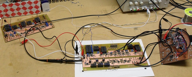

Glen's oscillator
"The notch filter & distortion amplifier PCB is the board in the middle. The board to the left is the state variable oscillator board and the "dead bug" rats nest to the right is the prototype auto-tune board."
From Glen's website. The generator board looks nice and compact, perfect for a rack mount box.

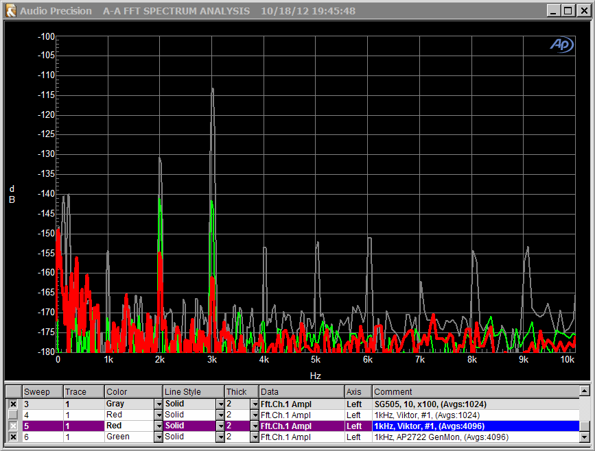

Residual Harmonic Distortion of Viktors Mickevics's 1kHz Oscillator
I had a chance to hook Viktors' 1kHz Oscillator on the AP and compare it against AP's own generator (direkt GENMON routing) and the Tek SG505. Test level was 2.7Vrms (Full scale on Victors')
No shielding of the Osc, and fed by lab supply.
The results speak for themselves, or in one word : INCREDIBLE!
Only with massive synchronuous averaging (4096 runs, checked for no/little loss of harmonics magnitudes) it was possible to see the distortion of this oscillator and it fares better than AP's by 10dB...15dB. The SG505 (with only 1024 blocks averaged) is far behind and plaged by hum which also seemed to disturb the autotracking of the notch filter of the AP.

Wait a minute--what analyzer settings did you use to get these plots? Can you post a screenshot or e-mail me the setup file?
A SYS-2722 has no way to directly measure distortion below -130 dB with any reasonable uncertainity.
Samuel
I used massive time domain averaging (the full max of 4096 blocks, took several minutes to record) to discard some 20dB of noise/hum. I'll email you the setup tomorrow when I'm back at work, at least the genmon trace should be replicable (though we have outboarded the xformer to get the noise floor as low as possible). Any double-checking is appreciated.Wait a minute--what analyzer settings did you use to get these plots? Can you post a screenshot or e-mail me the setup file?
Samuel
The plot seems to show 155 db notch depth. Is that real, or software?
I have never been able to duplicate the averaging noise reduction they get with other systems.
