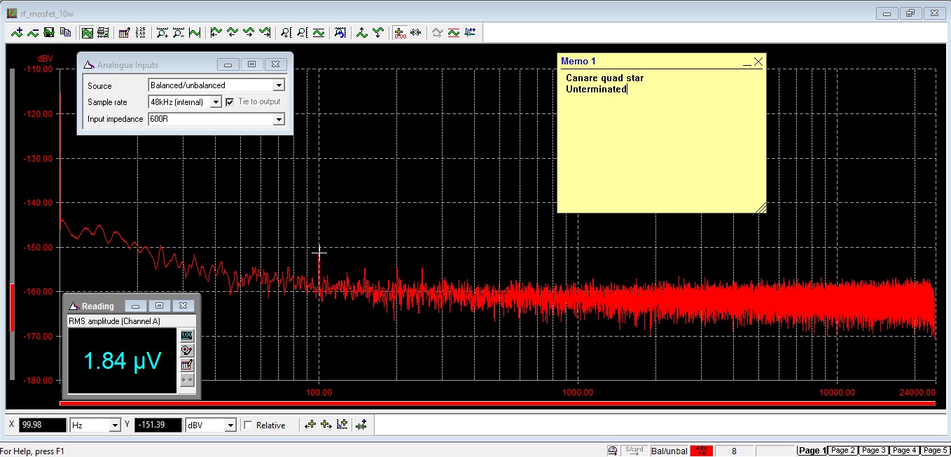

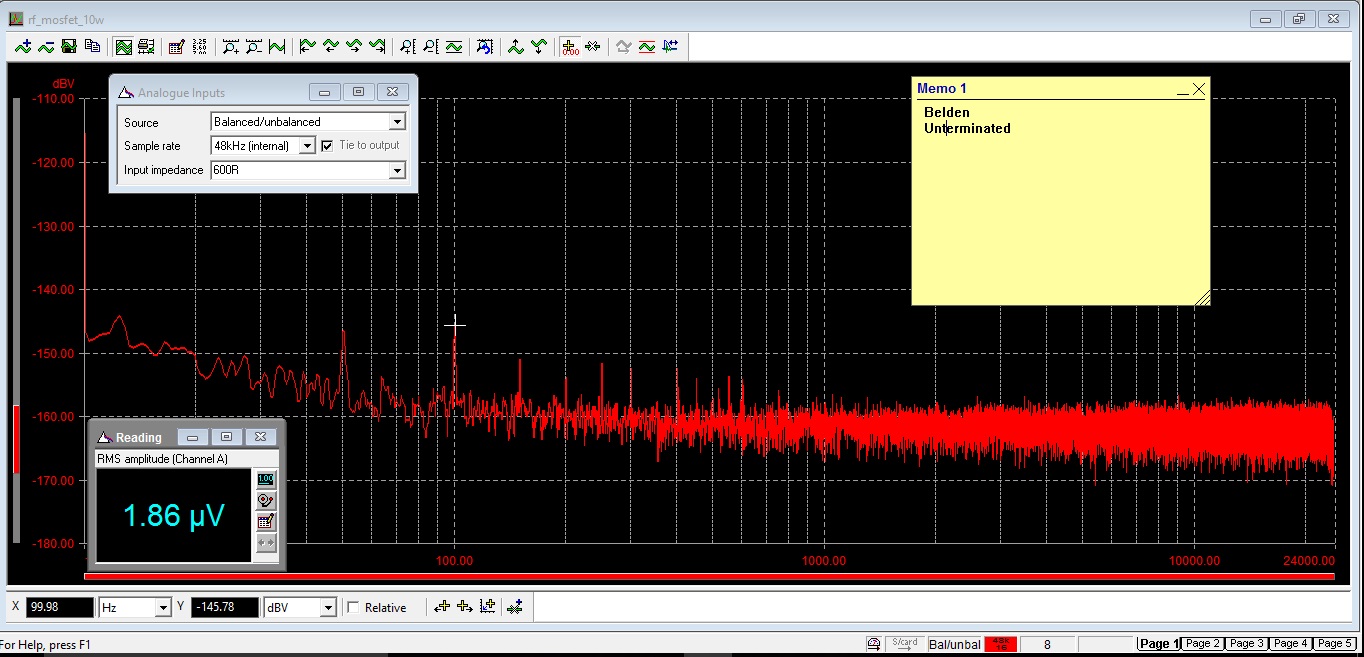

Star Quad Simple Test
I started to do the test only to notice that the usually ubiquitous mains EMI pollution shrouding my test bench had fallen away quite a bit! :headbash:
Still, in this environment i found a small (but worthwhile to me) improvement.
You can take a look and decide whether its worth your time and the $2/M for the cable.

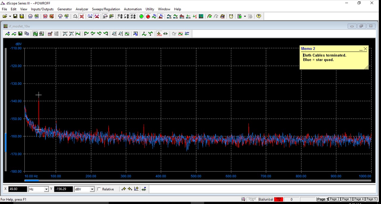

Yesterday I redid the tests with the unused ends terminated with 100r termination. I found that the starquads made a very worthwhile difference (look at the 50hz component which is down 17db or so) and so I will be converting all my test cables to the as I go along. Of course ymmv 😀
