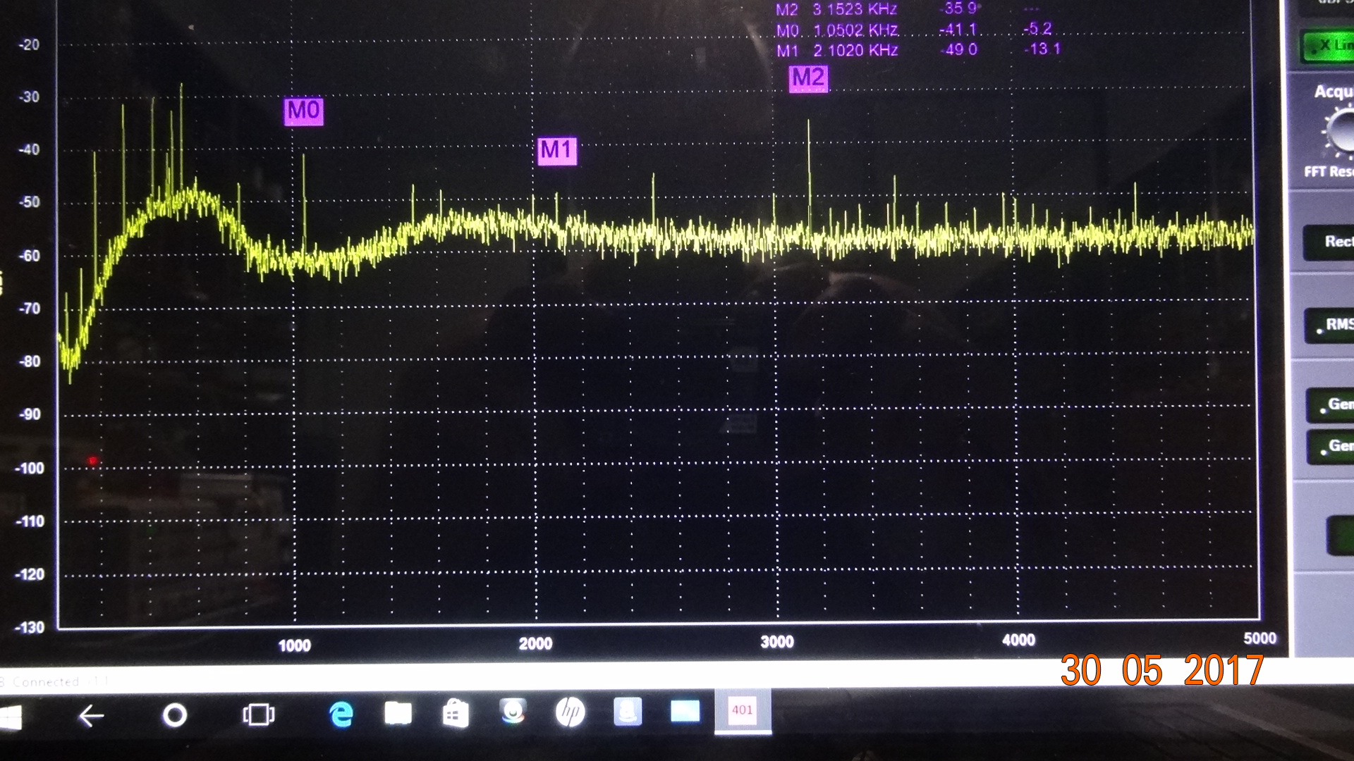

I am getting very good results with simply filtering the output of a very low distortion generator...... notch filtering. Passively. 2H and 3H.
Need auto- tunable notch filter synced with freq gen, offset by 2 or 3 times gen freq. 20-30db notch ... minimum.
-Richard
-Richard
From mod'ed KH 4402B.... both 2H and 3H are adjusted to be at same level --- approx. -135 re 1v. [ 0dbv = -100dbv] With only one simple LC notch on the 2H, the 2H is now -150dBv.
Parts to do better are on order and noisiness will be gone as this shown test has little shielding.
With David's gen, the 2H (and soon 3H) will be at or below the -160dbv level...... the lower limited with the ShibaSoku 725D/QA401.
Of course, notch filters can be made for other gen freqs as well.

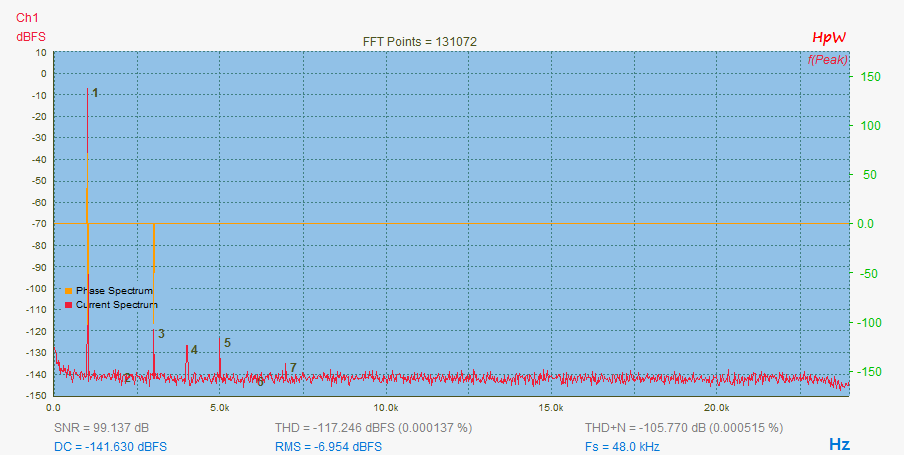

Some weeks ago a customer of my SW and I experimented (also some years back) on that harmonic cancellation already 😀
My Sine & Harmonic generator was used with various try and error settings.
Conclusion:
1. this works 😎
2. All harmonic settings (level & phase) are level dependent
3. The levels where about -110dB to... -120dB
4. the phase really made the beef
in other words, it's not clear where all influences comes from: DAC SDM algorithm, DAC circuit, output buffer and each interactions...
see attached picture... with 2. Harmonic removed
Cheers
Hp
