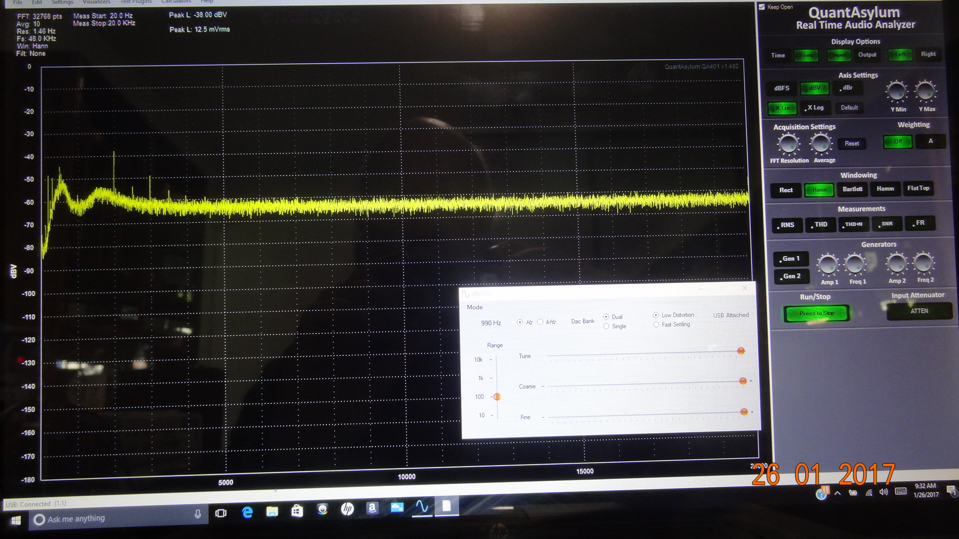

David --- i think this is my issue..... scanning the 500+ page Audio Precision manual is this weird little jem on page 493 !!
I am comparing results with 3 other analyzer brands at this time whose monitor outputs ARE calibrated and useful for further analysis. .

Your reading of the "Monitor Outputs" is correct. AP System One, Two, Cascade & 2700 monitor outputs are not calibrated as the final signal path to the A2D is the CALIBRATED PATH. The BW is good however the levels will vary slightly.

What I do with the Shibasoku 725 and the emu0204 is, in level mode on the 0dBV range apply a 1kHz 1Vrms signal to the 725 input. Then adjust the input gain on the emu0204 until the FFT agrees. This assumes the emu0204 and software has already been cal'd.
It's tricky with QA400 because there is no input gain adjustment. But you can use the extra gain function to scale the software.
You can also use any line type amplifier which has a gain setting to calibrate the read out device. It's impossible at this point in the signal chain to add any significant distortion and noise will have little effect. So the amplifier doesn't have to be anything special provided it has the BW.

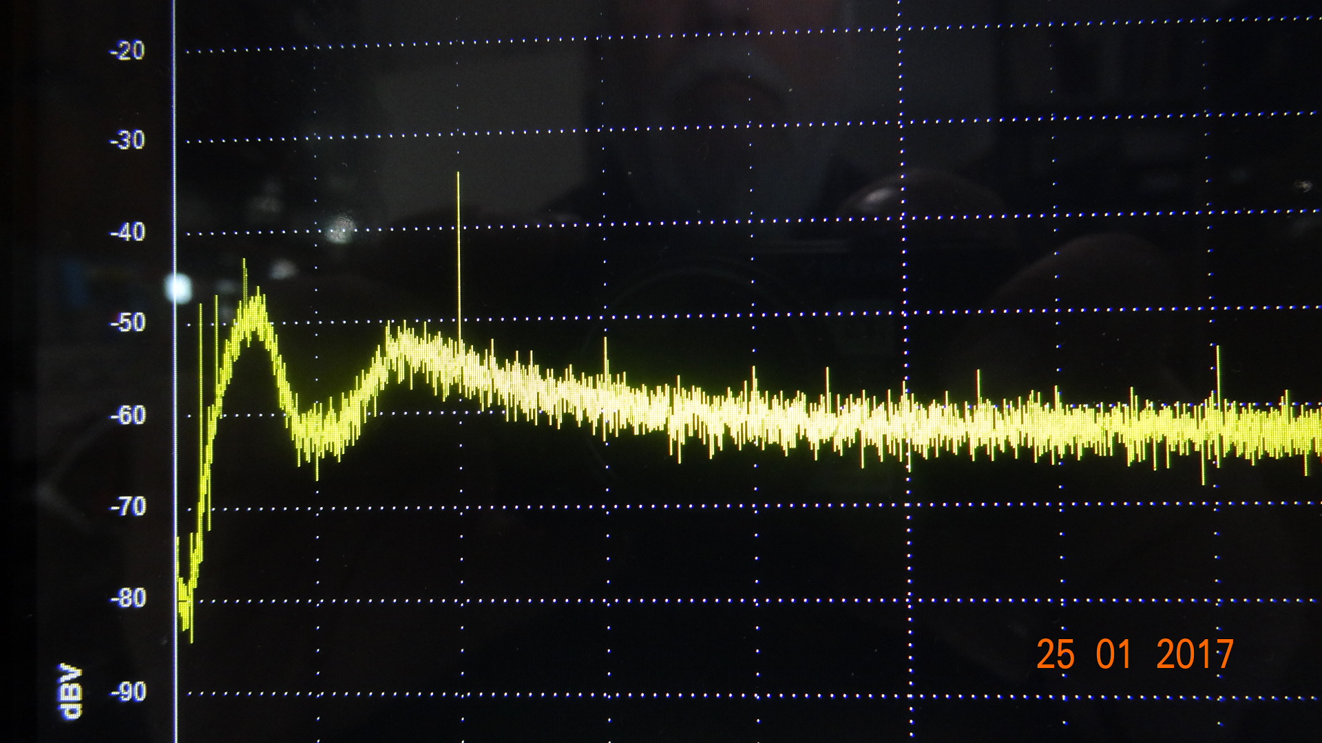

I have long advocated distortion cancellation in audio amps. When we have super low harmonics and want to have NO harmonics... cancellation needs to be tried.
The gen is ultra low distortion. With some very simple non-optimum cancellation tests , I have 2H = -140dB and 3H = -150dB. Now, we will all think of the cancellation or filtered out of remaining very low residue.
