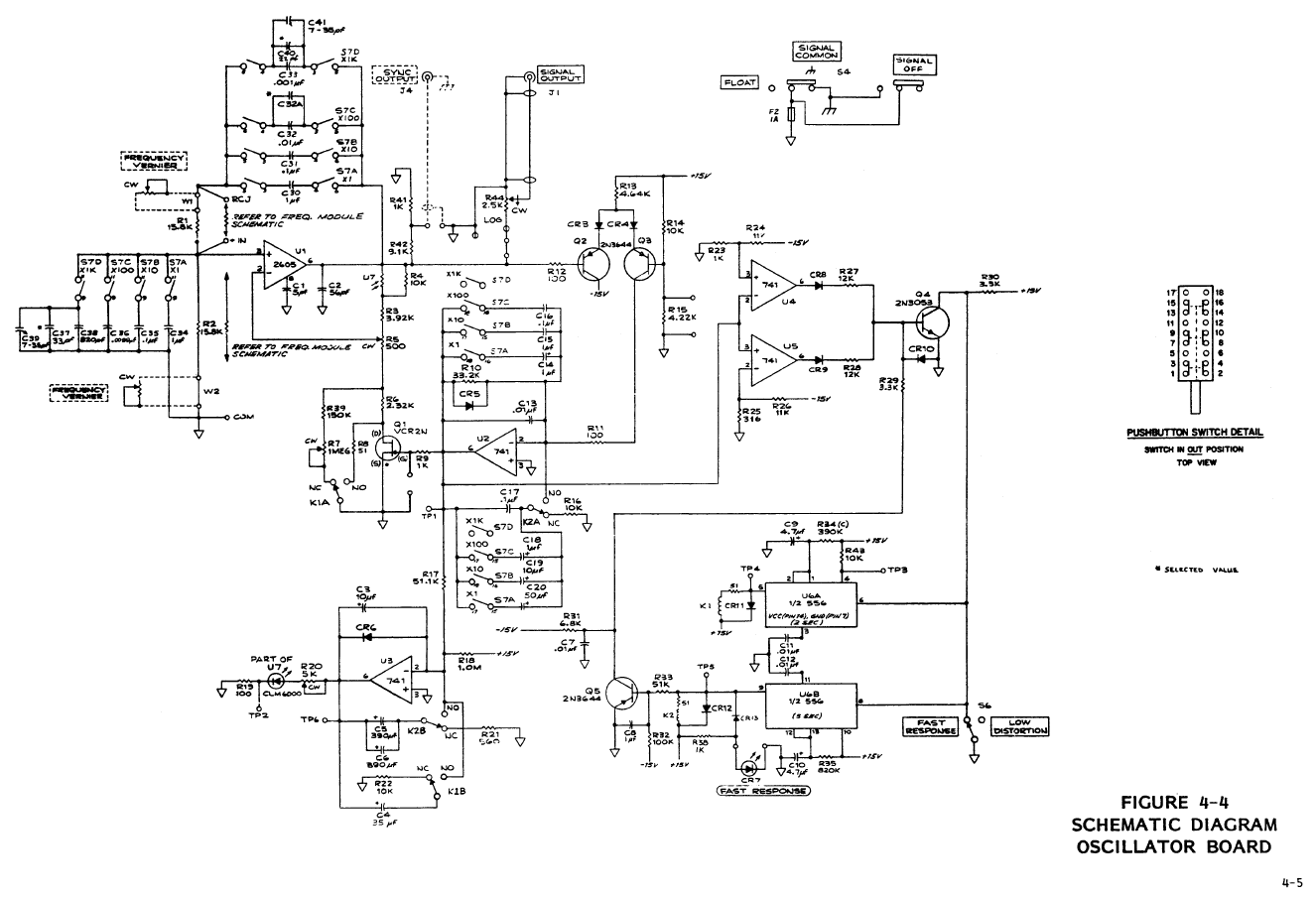

I think the specs are written so that they have a lot of wiggle room. All of them I have checked were significantly better that -80 dB.
The Boontons when carefully adjusted stock can get below -100 dB THD+N. With the mods they are more stable. The Boonton is sort of based on the HP8903. The SV notch sees to work quite well. The limitation seems to be the analog multipliers. I hope to try a newer multiplier if I can figure out how to patch it in.
The SVO uses two multipliers. One for gain and one for frequency. In both its really accurate. I have measured less than .01 dB across most of the range and the frequency is crystal stabilized with 5 digits of resolution. The FET attenuator may limit the distortion (don't know yet) and the output amp may need some help as well. However having a 50 Ohm source good for 14V can be really nice. The other nice trick is that the source is completely floating with no connection to ground.

The Sound Technology ST1700 oscillator is one of the best examples of a photocell stabilized oscillator. It uses a Jfet for fast settling and switches to the photocell after a delay whenever the frequency is changed. John Curl managed to get the distortion well below -100 dB with opamp upgrades etc.
The best photo cell implementation would use an incandescent bulb which is sort of a true RMS detector and down to a pretty low frequency will be pretty ripple free. The cells themselves are also slow to respond further removing ripple.
There is a new source for them that is supposed to be lower distortion. They have a high voltage coefficient so keeping the voltage across the cell low is critical for best performance.

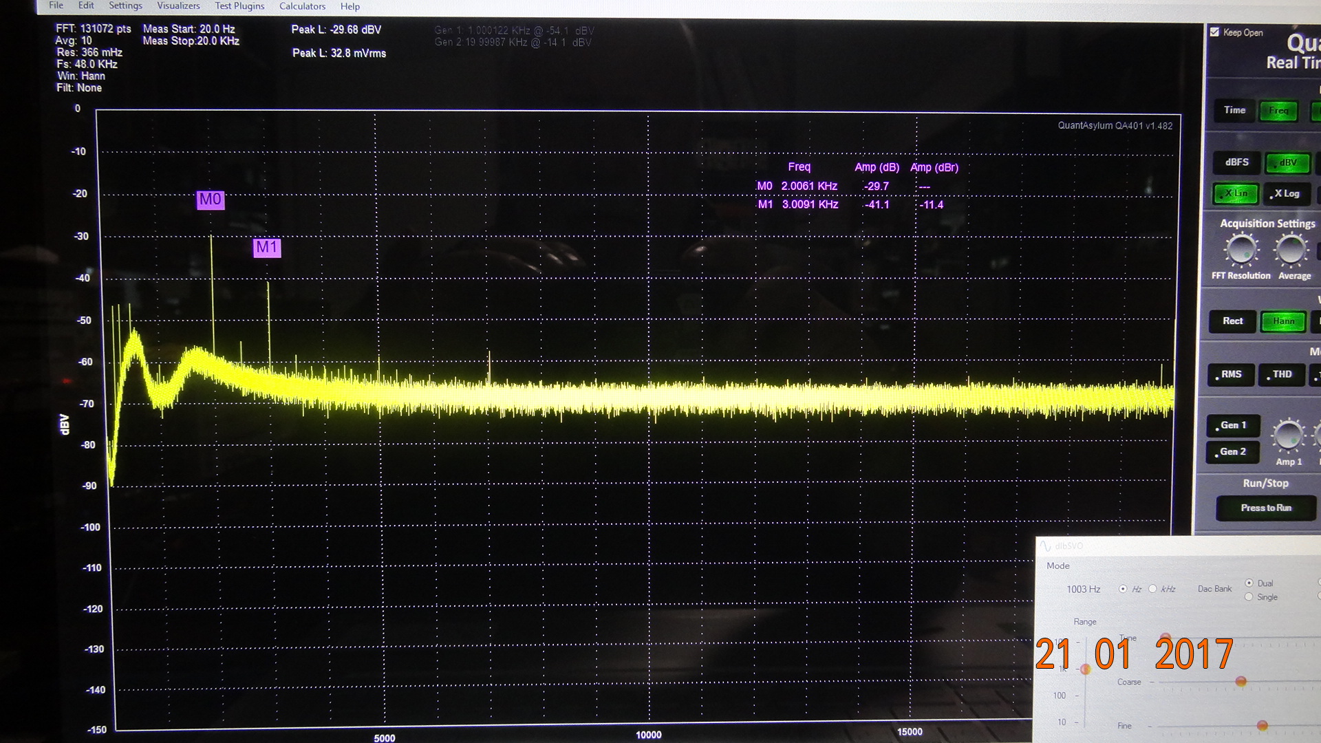

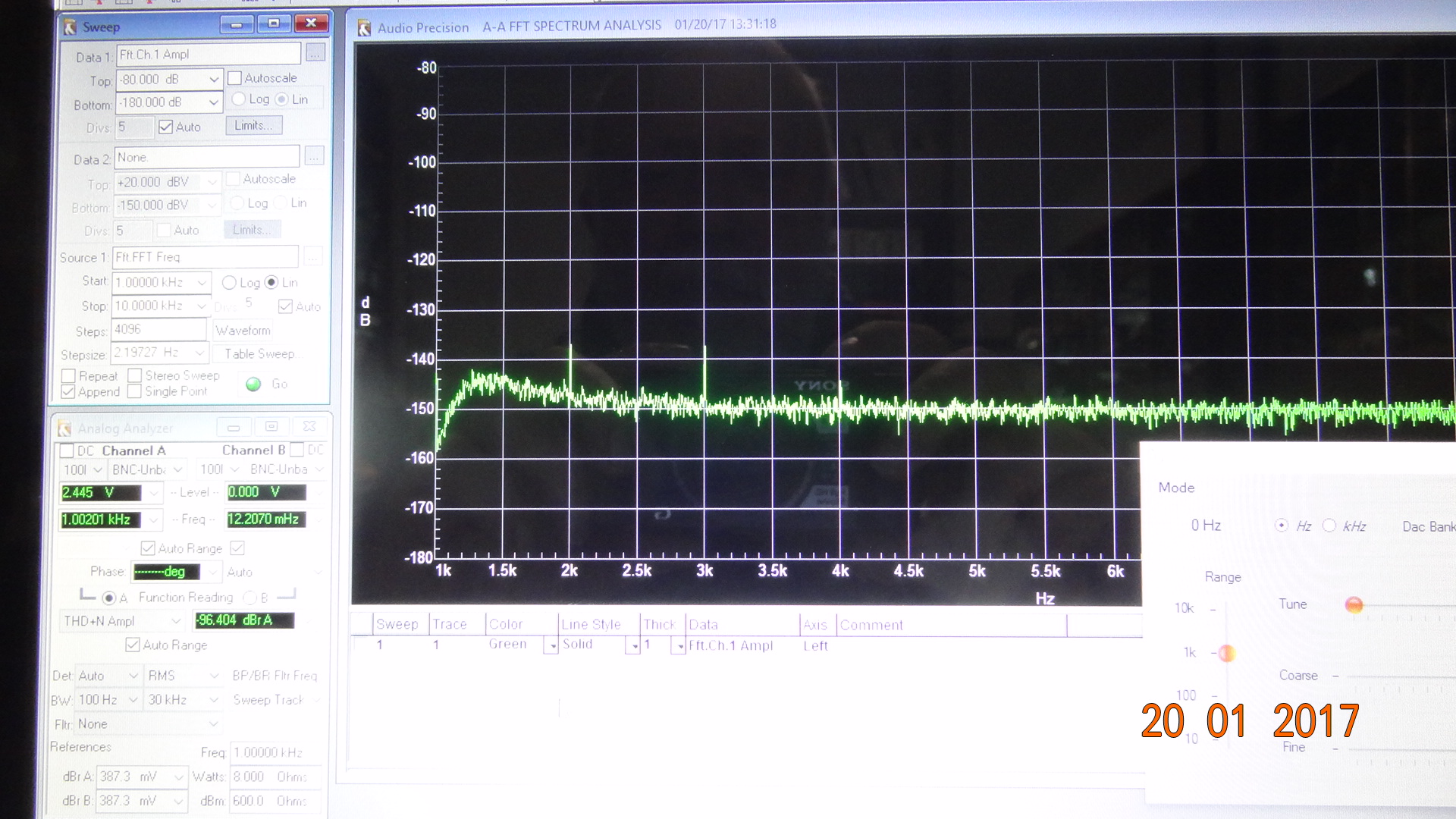

david's generator looks very good on first pass on the AP2722. -137dBV for 2H and 3H. You can take away some DB's as the ref is higher than 1v standard.
I'll go to the monitor output and run it thru the QA401, next.
There is some instability in the gen but I'll sort that out with David Could just be operator error.

You are looking at input channel "B". see channel input "A". 2.45v/1KHz on the left side of screen.

Meanwhile, can we get 3v output or 1v output rather than 2.5v ?
2.5v is 8dB hot from the analyzers normal ref input level. 3v would allow a nice 10dB figure to use in calc.
As shown via the 725D analyzer, it's monitor output going to a QA401 FFT --->
You can add 8dB to these numbers to get the actual harmonic level refered to the input level of 2.5v.

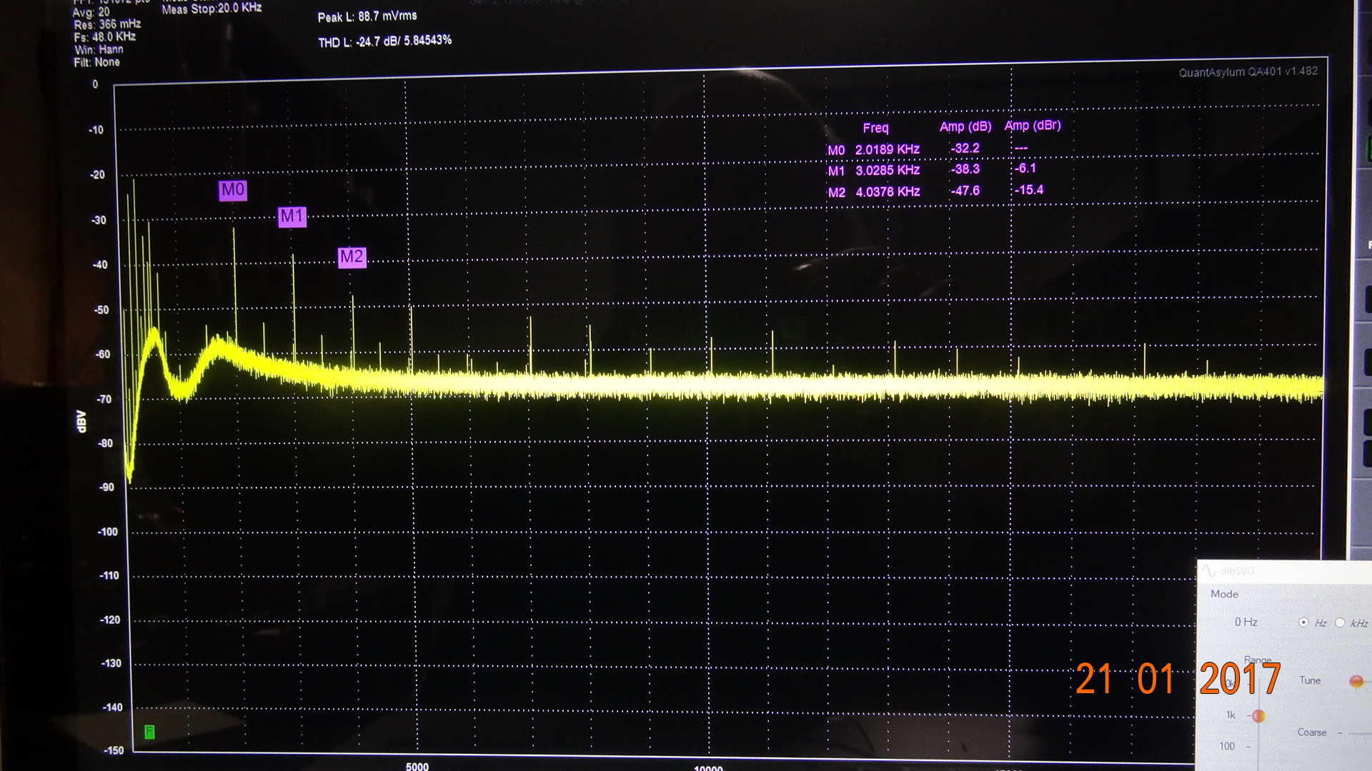

Can it go to 1Vrms. Absolutely not. The SNR would be poor all you'd be looking at is noise. It best to start high then attenuate. Can it be set for 3Vrms. In short yes but not an easy procedure. It requires some expertice understanding of the design and know how on how to set everything. The operating level is part of the loop gain and the limiting circuit would also need to be adjusted. The distortion will rise setting the level higher. The 2.5Vrms is optimal for this gen. It's set for best SNR and distortion performance. Each is a trade off.
What is needed is a post amplifier and attenuator. I haven't found an amplifier yet which is transparent to the distortion of the generator. But I will.
What you have there is a source.
What range is the 725D set to? The measurement shown doesn't make any sense.
What you are showing is way too high and it is not clean as it is in my posts.
You need to be connected to the LP (Low Pass) output of the generator. It looks like your are connected to the BP output. 6dB less slope attenuation.
yes it was BP output. I dont see any thd change between the two. I'll check again. The 725 was set on the 3v range (+10dB). This makes the monitor output zero reference line at -110dB from gen source level (technically +8).

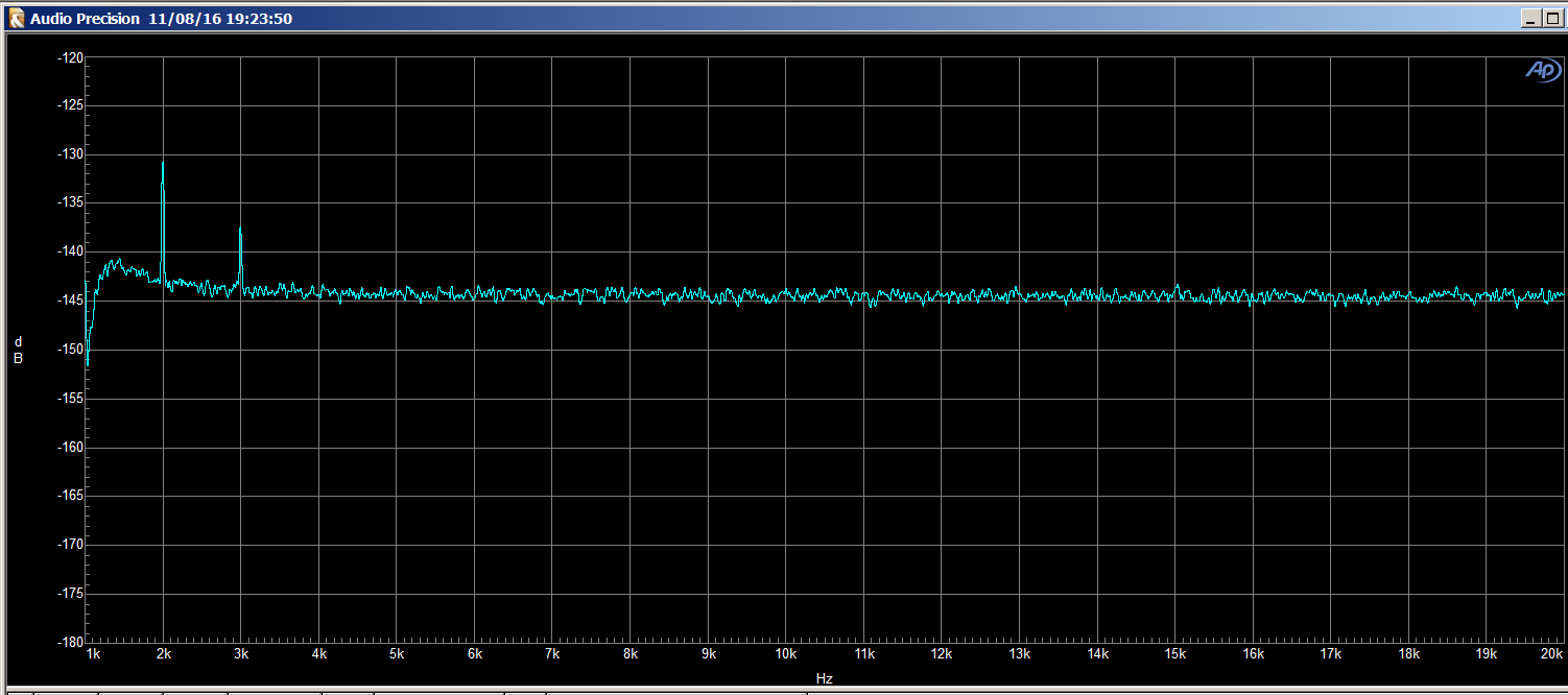

I get pretty much the same distortion on three analyzers... panasonic, shibasoku and AP. small differences mostly with the 2H) only. It has bothered me that others, besides yorself, get much lower readings with their various sources.

Yes, this is normal procedure. In your case, with 2.5v, I use the 3volt range on the 725D instead of the one volt range. I said this in last note above. The range is the lowest -100dB fs when in analyze mode... as you would expect for a source gen of this ultra low thd.
With this info, I get the 2H at -140 and 3H at -146dB. Is that how you read it also? What levels do you have for 2H and 3H?
The biggest issue when testing at these levels is still ground leakage and noise etc. But, as you can see, it is fairly free from extraneous freqs.

These are correct harmonic levels for 1kHz. Try 2kHz. Might be much better.
However the gen might still be lower if this is the residual of the analyzer(s).
I haven't verify this yet.
