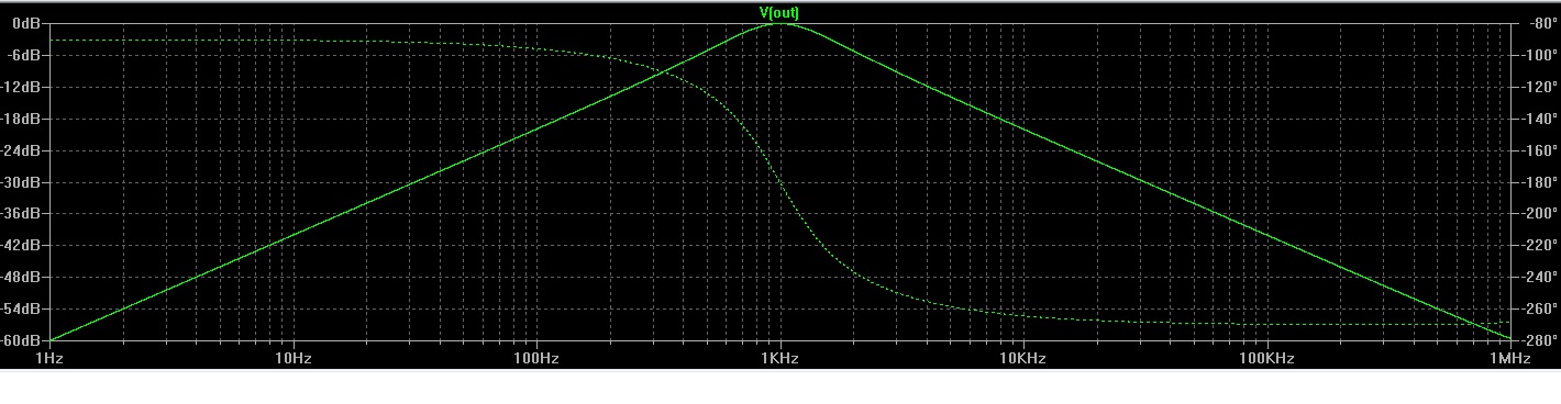

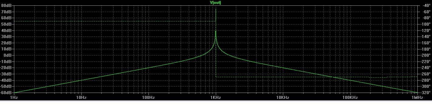

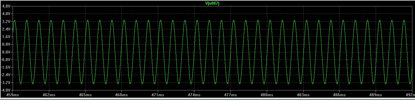

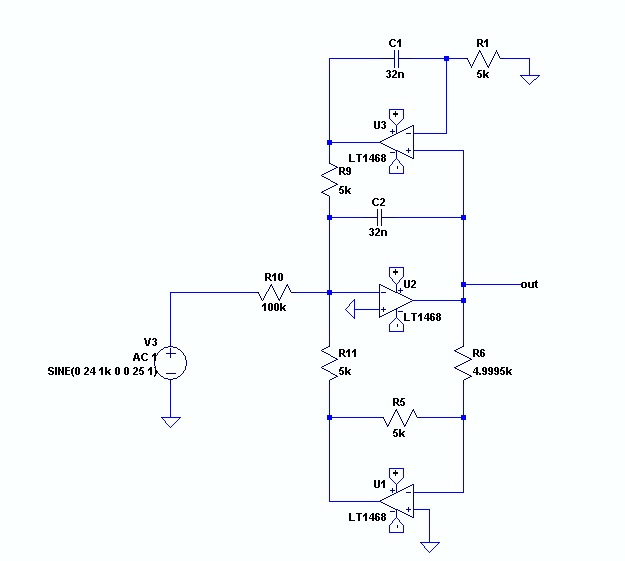

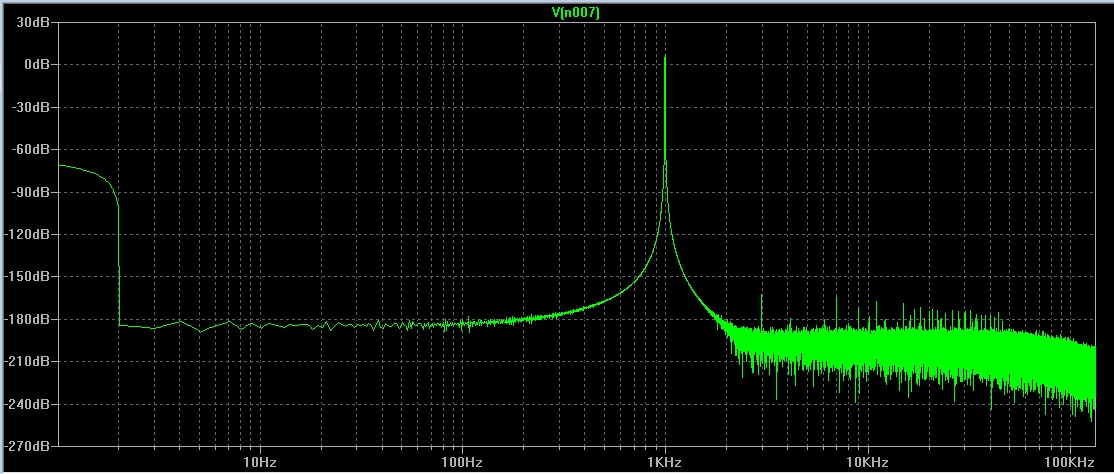

When I built it, it was about 400USD. That's the PCB loaded and USB control interface. No enclosure or power supply. The PCB is expensive one- off but there are cheaper board houses. It's just a 2.5Vrms source.
I'm working on getting the cost down a bit. Save about $80 CAD.
Here is El Cheapo.
It's never been built or tested and you will have to optimize it if you're interested. But it is simpler.
Gives more of a Wien response.
The peak of the filter is at unity and closed loop brings the Q up.
The invertor section would be your multiplier. Just need to control the gain near unity.
I ran this for one minute with no control and slightly above unity.
I included spectra. Not that mean anything.
