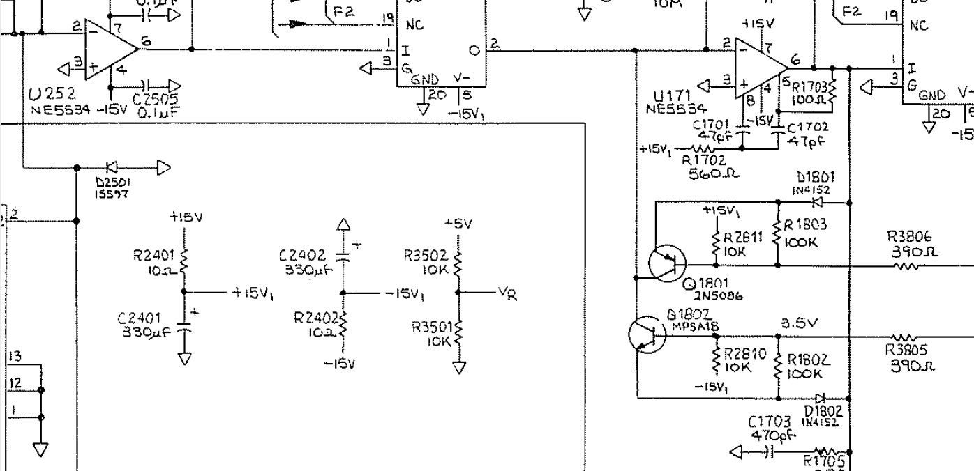

I feel some sympathy for the simple approach after a look at the compensation of the Tek 505 and the AP SYS1 - not simple or easy to understand.
The 505 uses different compensation on each integrator and a third approach on the inverter.
The SYS1 uses yet another approach on the integrators and no obvious compensation on the inverter.
I am not that interested in the details of the 5534 compensation as such, but curious about reasons for the differences.
One integrator in the 505 is two-pole compensated and the other is not, odd.
The two-pole is referenced to earth.
Both integrators on the SYS1 are two-pole and bootstrapped, kind of like Edmond Stuart's TMC from my initial look, and referenced to +15V.
Presumably the reference to +15V is for improved PSRR.

Hi Dave,
I think there is more to the SYS1 scheme than just compensation.
What does the 100 ohm resistor do tied to pins 6 and 5. Will this increase the bias current in the output stage or is it boot strap?
The comp is not tied to +15v it tied to +15v1. This is a n RC filtered/regulated point.
Anything directly in the signal path is tied to this point including the mdacs. The Mdacs don't have a PSSR. They have a power supply sensitivity usually given in percent and require separate down regulation.
I think it's done this way to avoid the PSSR issues with tying the compensation to one of the rails.
Well spotted, I did notice that but didn't think much about it so I didn't mention it.
Intuitively makes sense to tie to a quiet point, maybe +15v1 is just convenient.

Where should the two-pole compensation be referenced?
Generally speaking where the emitter (of the CE stage that is compensated) is referenced to. This ensures that both ends of the capacitor that connects to the input stage are referenced to the same potential at low frequencies. Thus supply ripple doesn't cause a current flow to the second stage.
What does the 100 Ohm resistor do tied to pins 6 and 5. Will this increase the bias current in the output stage?
Yes, that's a class A biasing technique.
Samuel

If you look at the circuit it is an all npn output stage, pull-down is through a diode to the output and the npn on the bottom. The resistor increases the current through the whole chain. Notice the diode connected npn is connected on the side of the 15 Ohm resistor that senses the output current (short circuit limit).

This means that the bottom PNP output transistor runs cold most of the time
The 5534 has no pnp, the resistor increases both pull up and pull down transistor quiescent current.
I quickly checked the schematic, you are correct, but then the 5534 output stage doesn't appear to be a regular Class AB either, not even quasi-comp.
I was thinking more about the standard complementary output stage that the rail resistor unbalances.
