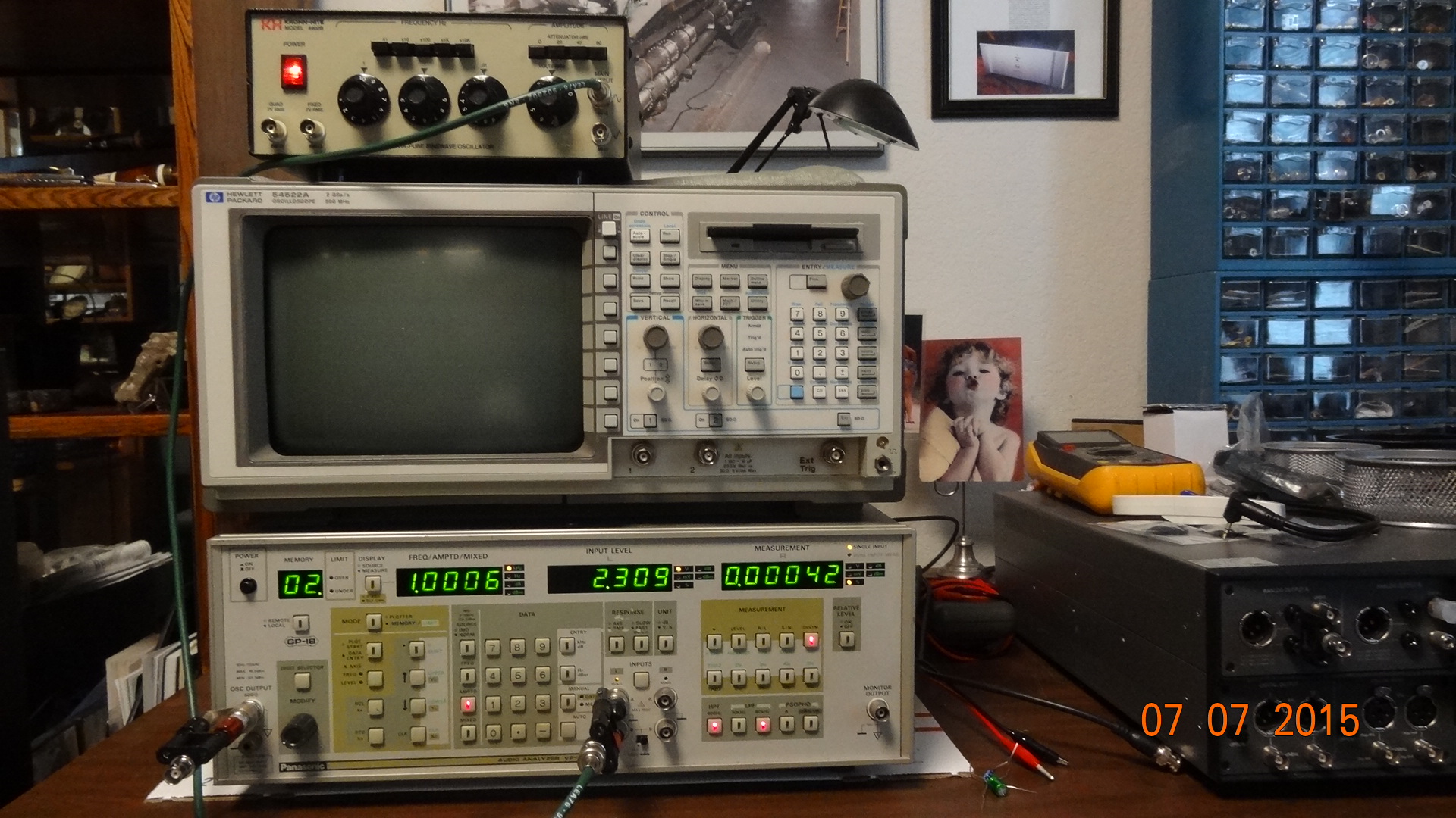

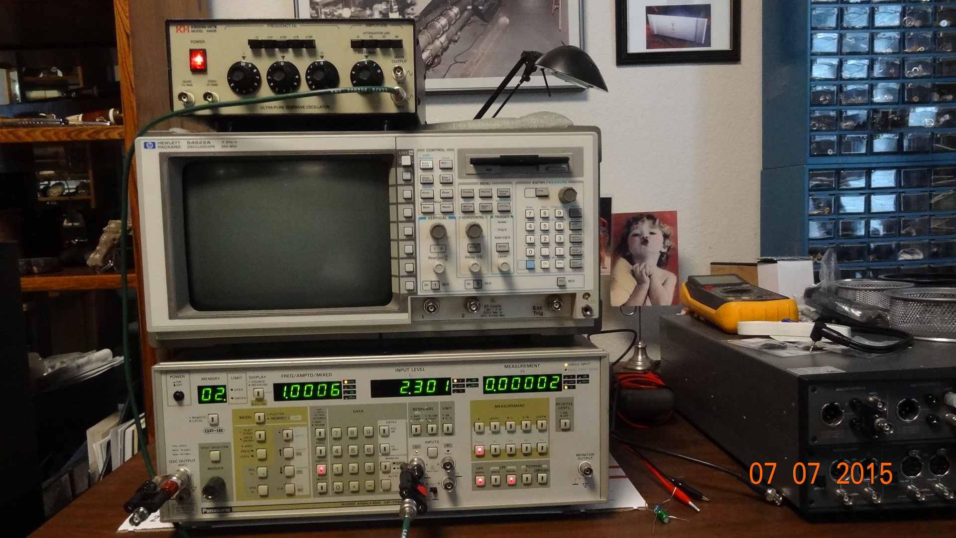

If the generator is truly floating ground wise it makes a big difference to the spurs generated. Grounding issues seem to be the biggest cause of FFT spurs. Next to that is ingress signals.
I don't know the Panasonic - whats the difference between the 0.00002% and the 0.00045 readings? - I'm guessing 0.00045% is THD+N 🙂
0.00002% is very good - the Panasoinc would make a good "Tracking Notch Filter" if used with its Monitor output and an ADC 🙂
