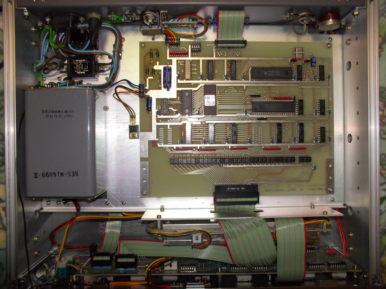

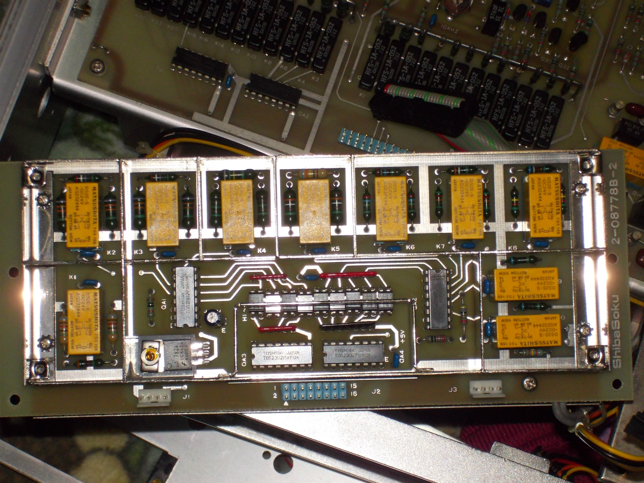

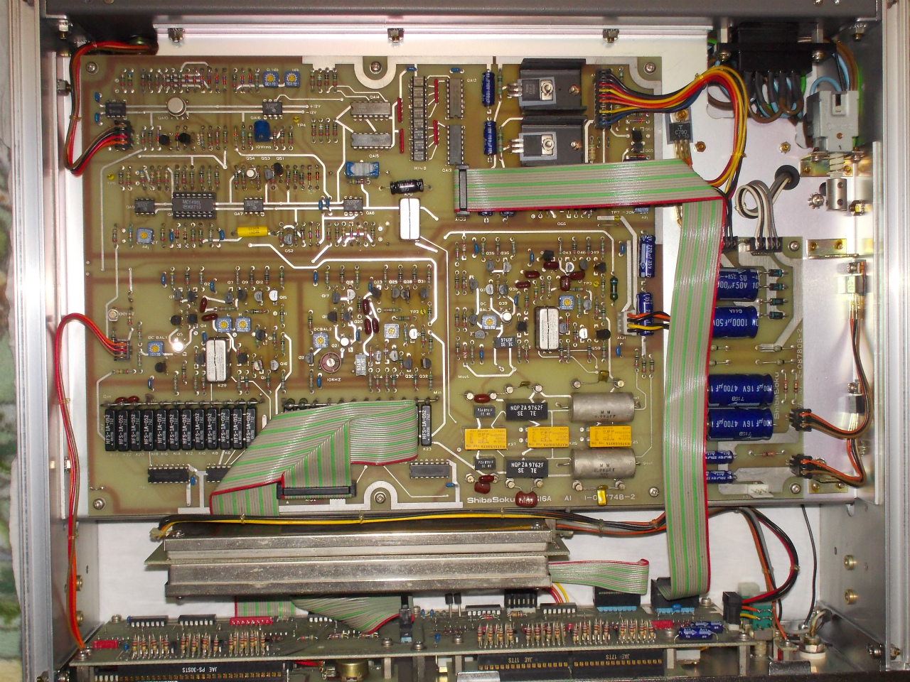

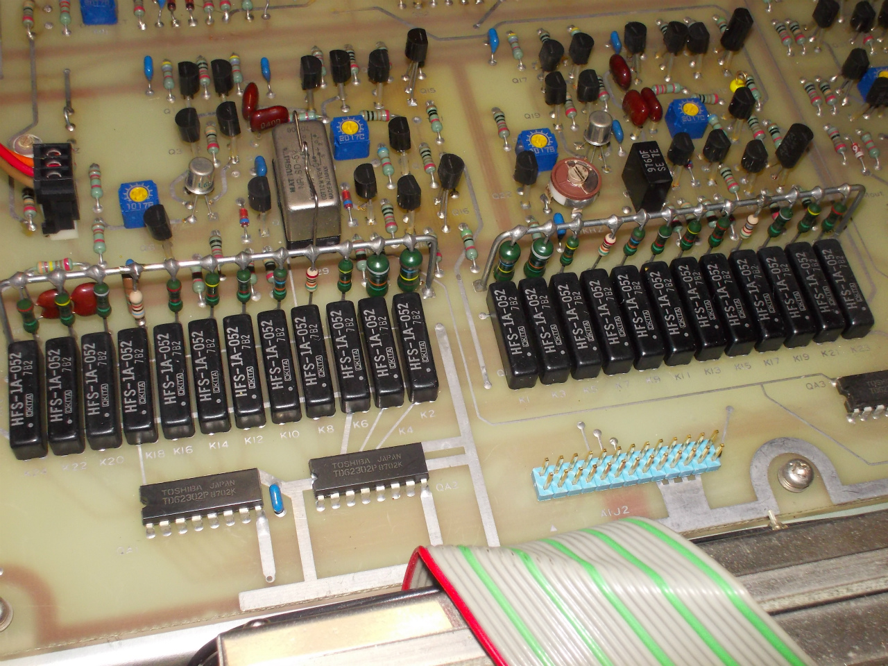

I got shibasoku AG16A.
4th picture is relay attenuator that is shielded can you can see in 1st picture.
bottom left relay is wrong orientation because I pulled from socket and set as it...
I do not own distortion analyzer so I will test with EMU 1616m.

Got to love those power transformers Shibasoku uses.

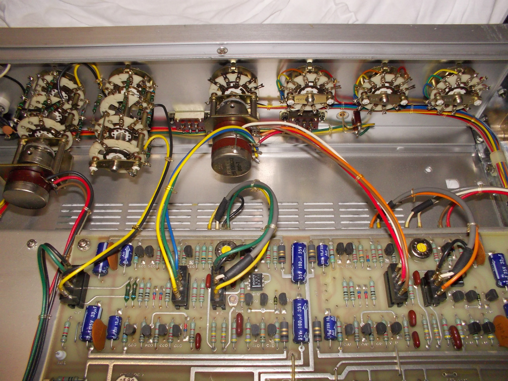

comparing his 590AR and my 590R, http://www.diyaudio.com/forums/equi...n-audio-range-oscillator-181.html#post3393158
they looks almost identical except minor changes.
trafo R:shielded tube amp like mount type AR:heavily shielded gray trafo?
LTP JFETs R:dual 2SK97 AR:single ???
compensations of two discrete opamps (relate to above jfets)
top left, neighbor to MC1495, socketted DIP reed relay
I partially traced the circuits and found they are consists of two all pass filters = phase shifter.
AGC circuit is complicated and bit hard to trace, also in AG16A.
