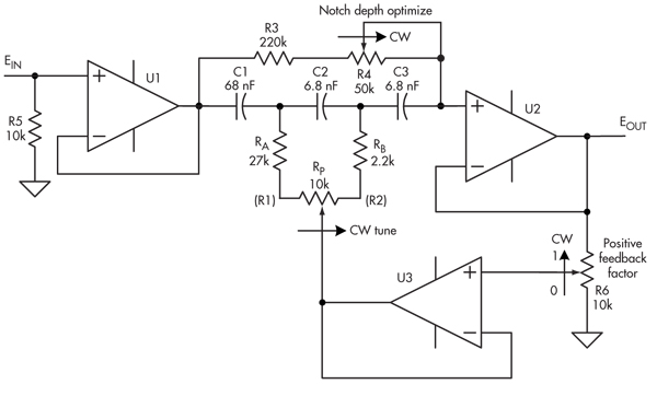

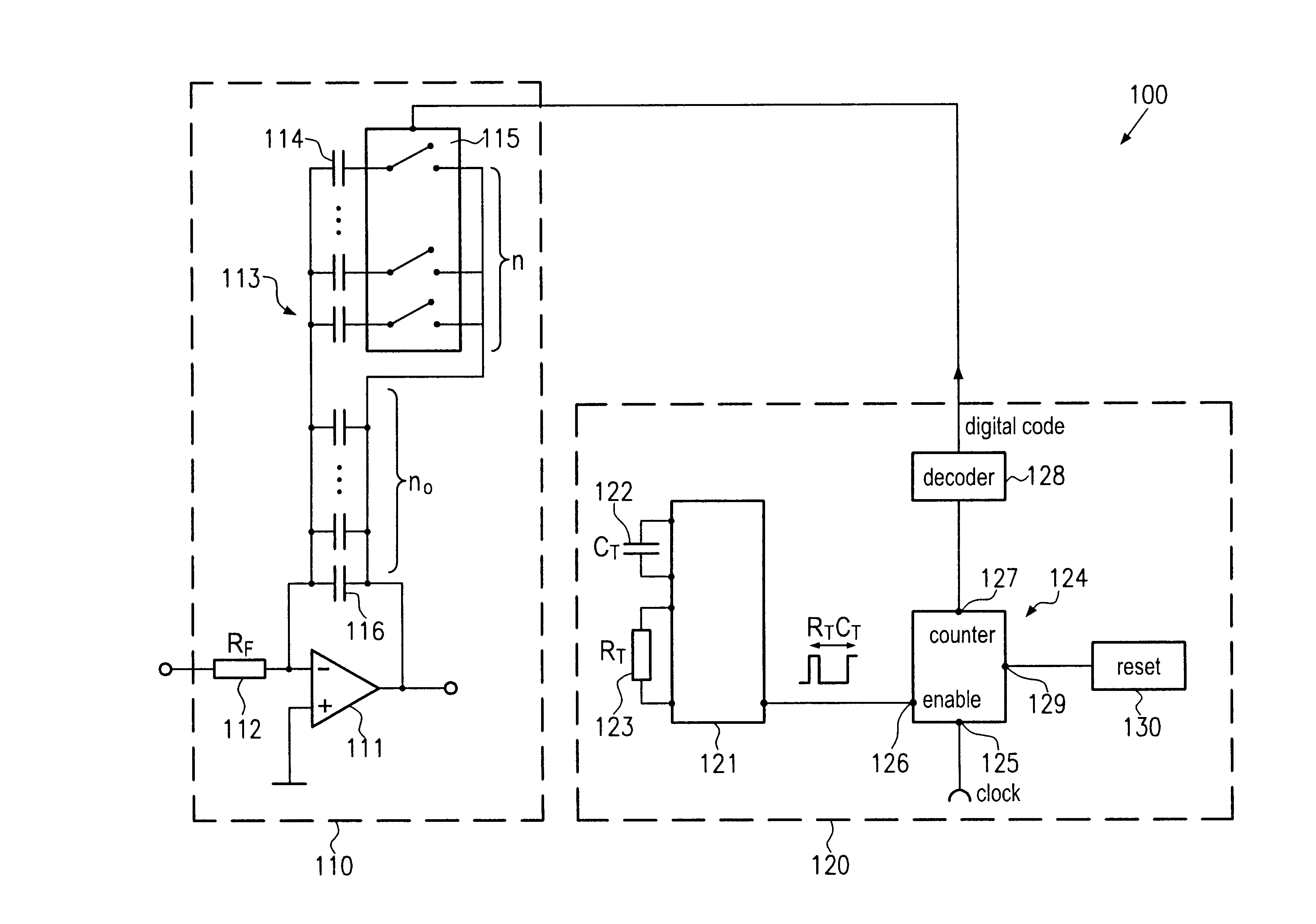

Auto Tune notch filter ?
Some ideas regarding variable freq notch filters and auto tune notch filter.... just the tip of the ice-berg though...
View attachment 25404-notch_filter_autotunes_for_audio_applications_pdf.pdf
For use with a variable freq oscillator/generator and a sound card/QA400 to make a complete distortion test set for any audio frequency.
THx-RNMarsh
THx-RNMarsh

The biggest thing in auto tuning is how to measure what needs to be measured to do the tuning. We already know what needs to be tuned.
For a TT they have to be balanced as well as frequency tuned. The frequency is the easy part. The measurement must not be intrusive. What are the tuned phases at the two T's?
How do the phase very with balance?

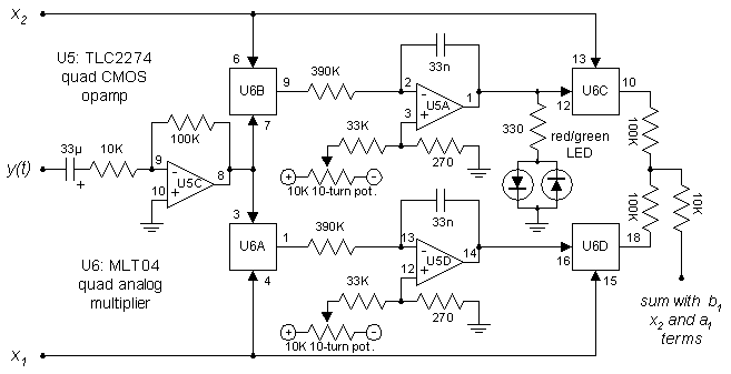

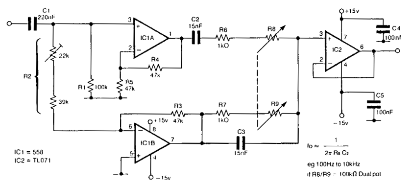

Maybe See this and the original --
http://www.williamsonic.com/statevariable/article.html or Google williamsonic.com
he uses this approach:
THx-RNMarsh
THx-RNMarsh
