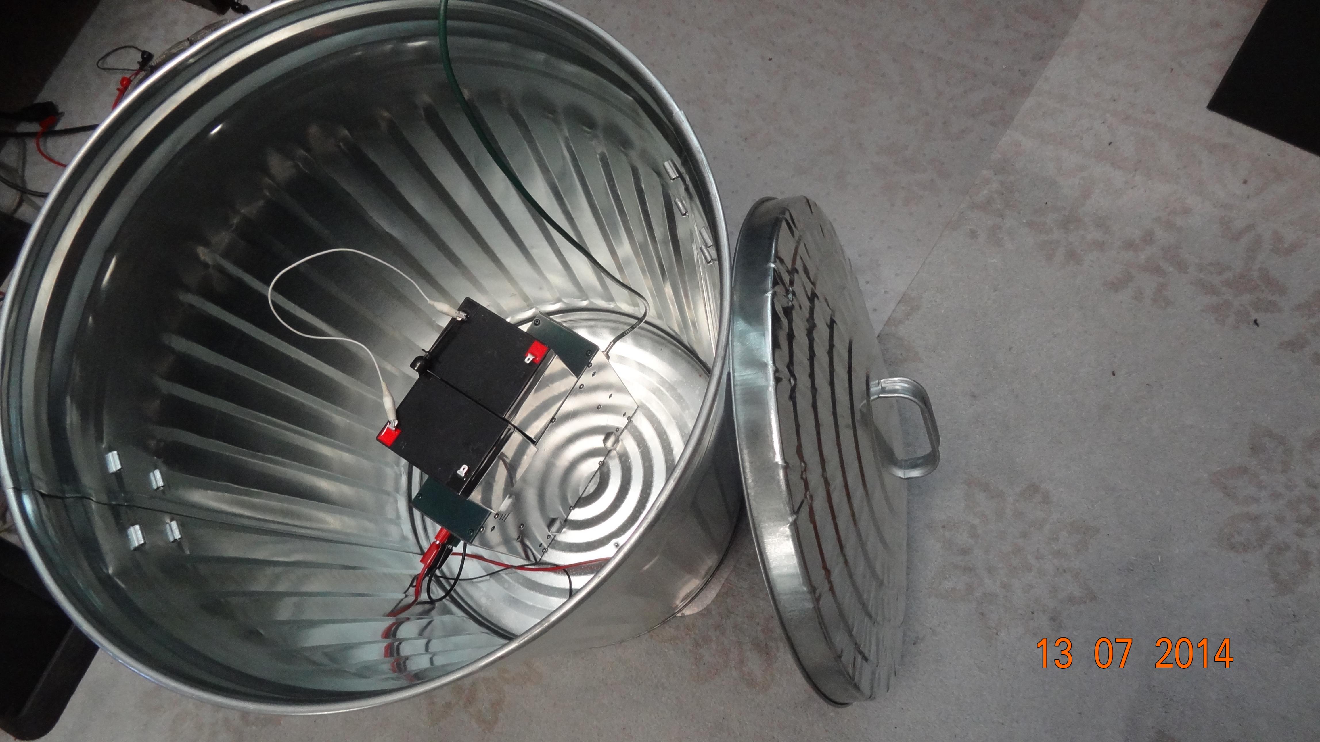

Double shielding.
Double shielding.
yes, what I called a box within a box.
Here is the outer "box" - with the inner box inside --> both the inner shielded box and the outer shielded box are grounded thru separate wires to the input of the A-P. The grounding of the inner box shield is from the coax shield common. The other is a wire going from the outer box (can) to input of the A-P.
THx-RNMarsh
Double shielding.
yes, but one must be made of steel for low freq EMI shielding.
-RM

I see some confusion on how shielding works here. It is actually a common problem and one of the reasons the EMI courses are popular even if expensive. I'm sure there are many watchers who would appreciate a quick introduction.
Magnetic shielding works differently from electrostatic shielding. With a magnetic field the goal is to provide a path around the shielded circuit that will shunt the external field so it doesn't pass through your device. John Curl's SOTA "piglet" preamp is a excellent example of simple implementation. It was a steel tube maybe 1/8" thick that the circuit was inside of. The steel was thick enough and magnetically soft enough that pretty much all the external field would concentrate in the steel and none would be inside. The core principle is that the magnetic shield is a pretty complete housing and with generous overlapping of seams. Welded seams can degrade the magnetic properties enough to degrade the shielding. If its magnetized the available flux before saturation gets used up and then it becomes transparent to the external field. Similar to a saturated cored inductor: the inductance drops to that which the coil would have without the core.
An electrostatic shield is used to create a constant electrostatic potential around the circuit at a known fixed potential to the internal circuit. it needs to be a conductive bubble around the circuit. Holes allow the external potential to affect what is inside. At RF the wavelengths matter as to the size of the holes. Long seams that are not electrically connected with an emi gasket can let in RF and are even used as antennas in some cases.
For this project a cake tin (steel) if big enough may work quite well. The walls will be thick enough to shunt a smaller field and have enough overlap to be continuous.
A sheet of steel will do very little since the wavelengths are long and will easily wrap around a panel. The RF absorber can help reduce RF radiation close to a source but won't do much for audio frequency radiation.

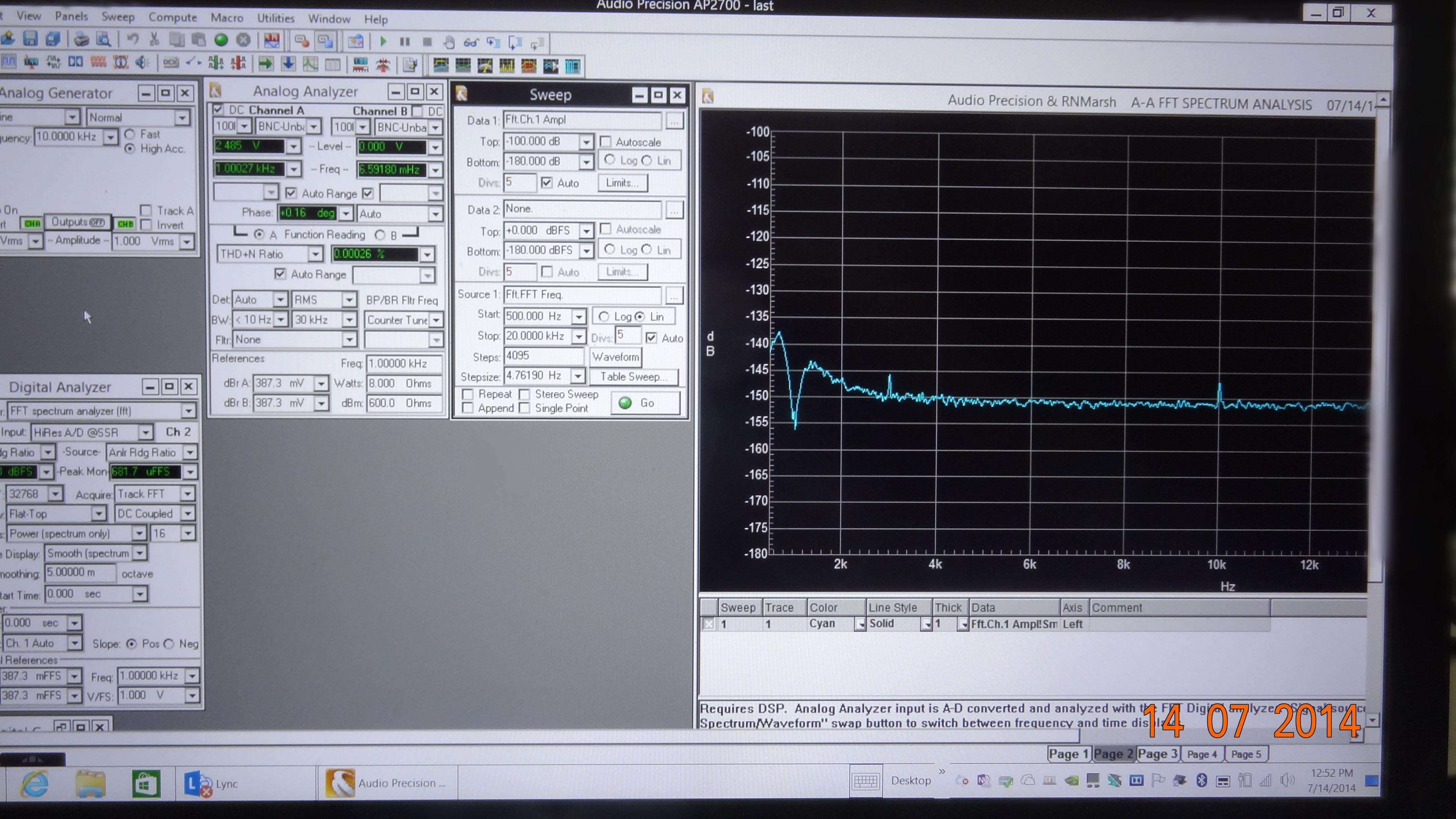

It measured -146dB

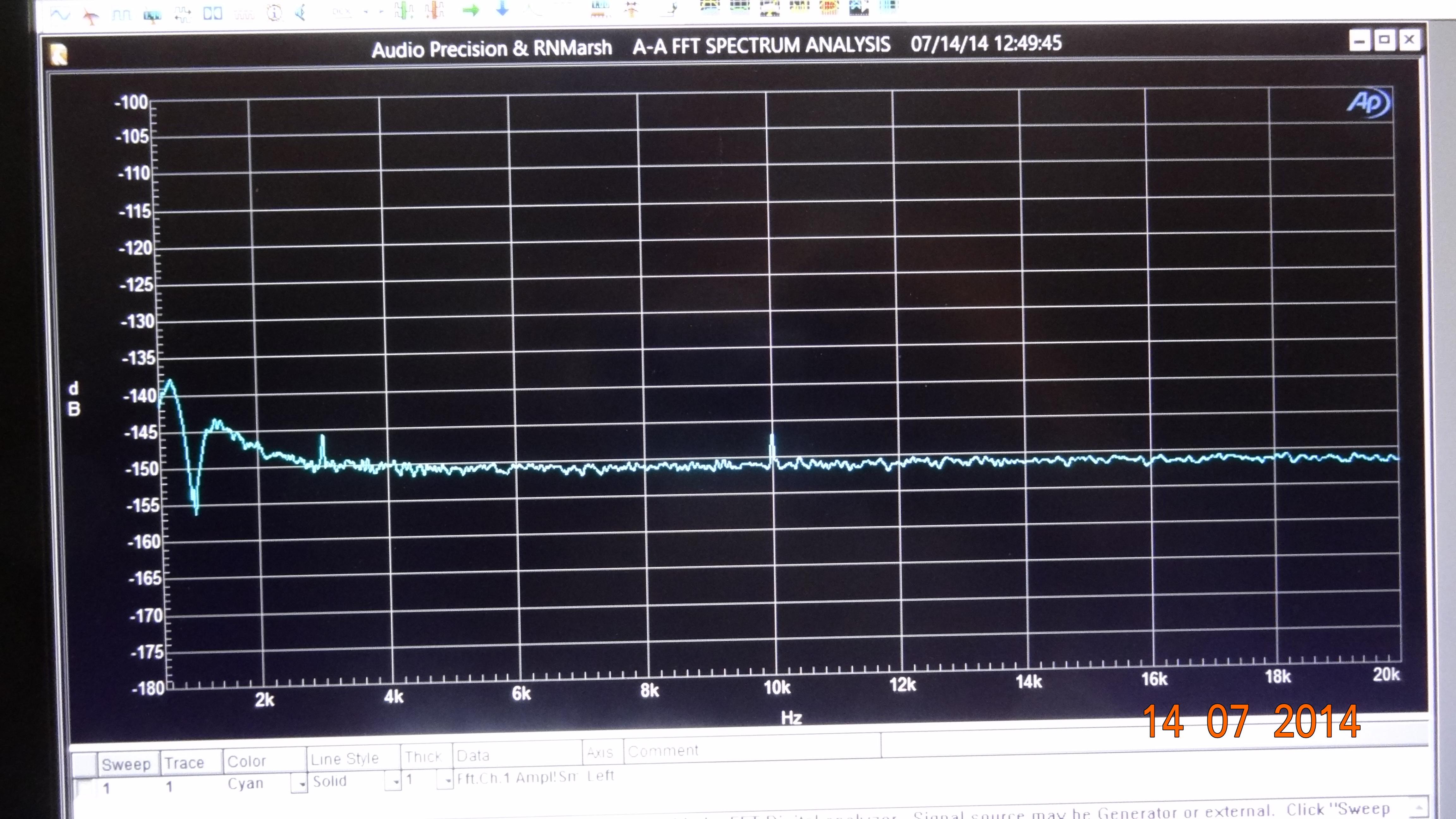

Now that the EMI/RFI is cleared up from the measurement system.......
Here is the true (according to A-P 2722) level of harmonics of a 1KHz signal from the osc/generator that David has designed;
David.... YOU designed this. You did the study and figured the best way and did the hard work. Yes, many here at DIY contributed input and help in various ways. That doesnt make it part their design... help is help. It is your design/work and you went thru all the permutations and sorted out what would be the best way. A 2 year effort deserves a big round of applause. Now here 's the fruit of your labor:
THx and I really mean THX, Richard Marsh
I think I am going to put a couple isolated BNC and three binding posts on this Can shield. And, a ground post to the can. And keep it.
I can always carry junk in it when not being used as an EMI shield. 🙂

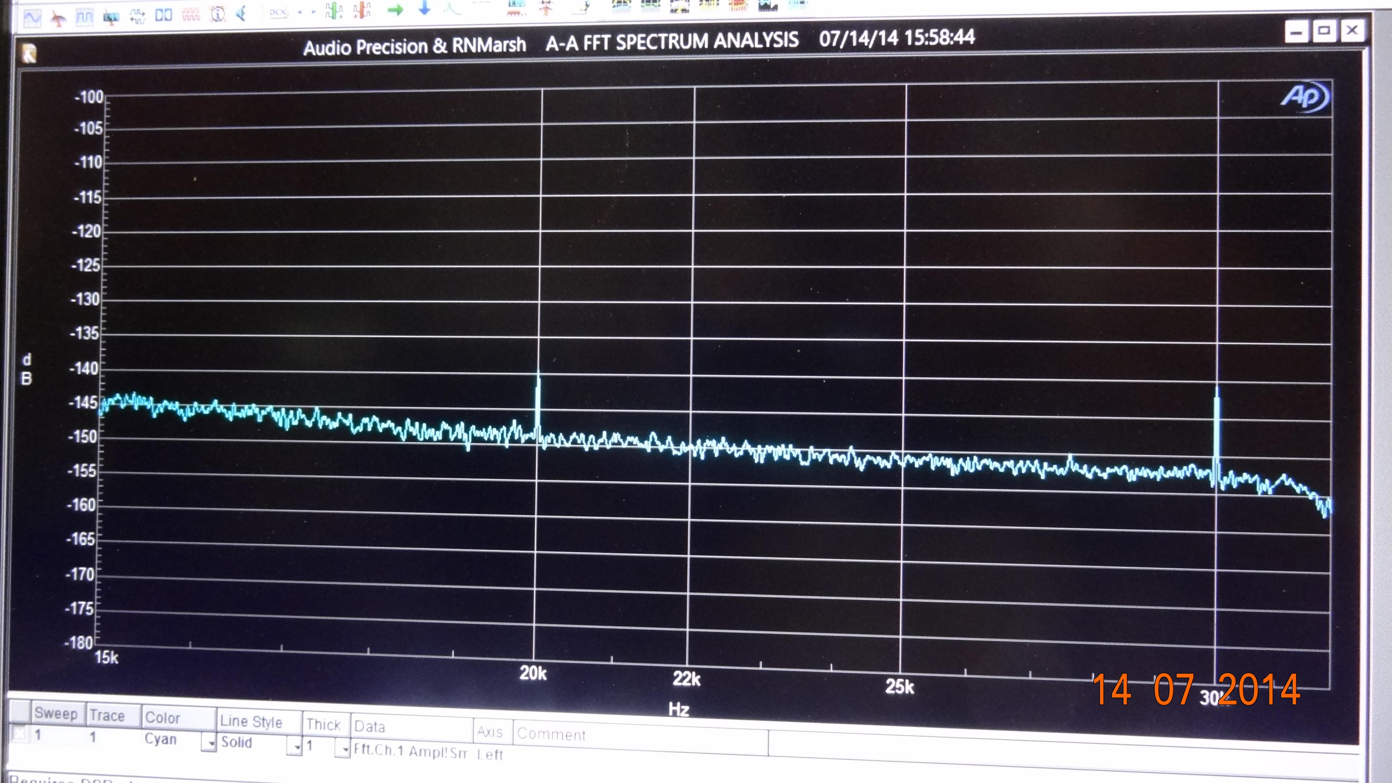

In looking at higher and lower freqs --- The highest distortion is at 10Hz... 2H about -120 and 3h about -130. At higher freqs the level is about -140 to -145db range for 2h and 3H.
I didnt normallize the level to 1.0v as I would have to go thru a pot (potential for distortion and more hum pickup). But you might drop these numbers at least 6dB if we are measuring at 1v input level.
That 10Khz 'harmonic' at -145dB doesnt seem to be a harmonic of the gen... it is there at any freq..... maybe a clock running inside the osc/gen?
I'll check again the higher freqs for distortion above 10KHz soon. maybe tonight.
THx-RNMarsh
THx-RNMarsh
THx-RNMarsh
I don't know if this is relevant or not but it looks like you have the AP's generator set to 10Khz.
THx-RNMarsh
The internal oscillator is set at 10K from your screen shot, that is what is showing in the FFT. It is crosstalk inside the AP. Not from the oscillator. Yes the panel says the output is off, that doesn't mean the oscillator is off.
Richard, are you measuring David's oscillator distortion or AD797 based AP front end distortion?
