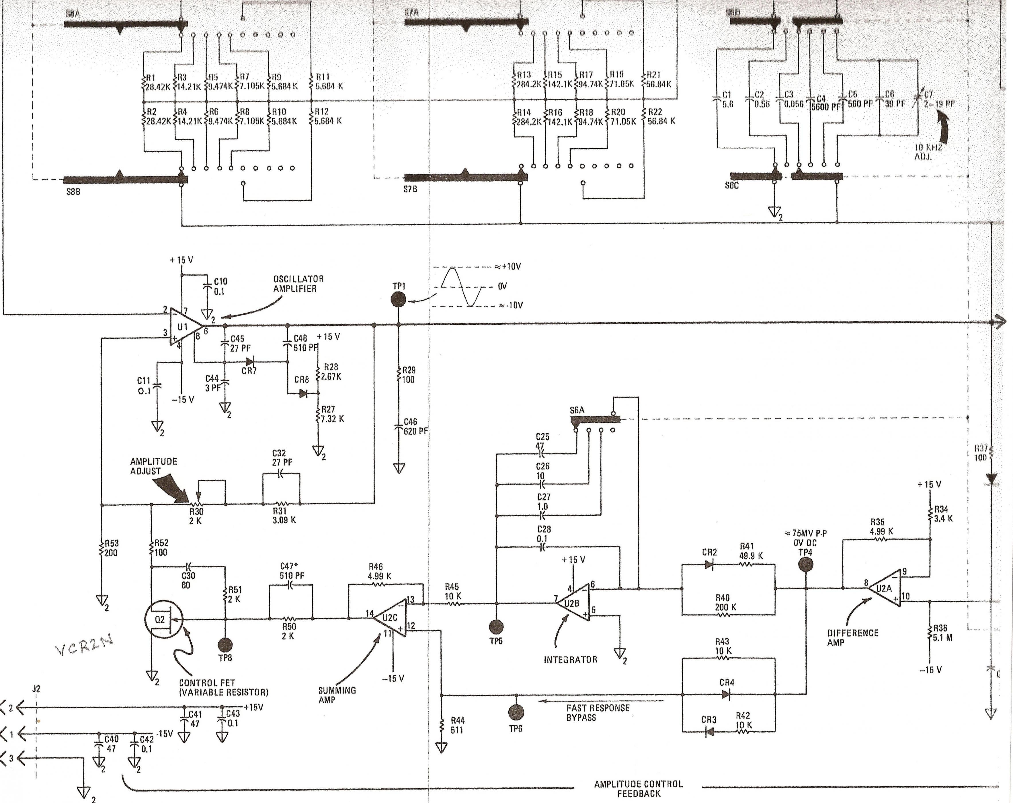

Maybe a cap across R51 or R100 would address the frequency issue , compensating for something. Does cascoding work for FET's used as VCRs? It would open up more ways to control and linearize things if it would work.
I tried a crude simulation and it does seem to work but I'm not sure how well and I don't trust simulations for that.

@Richard Marsh -- my experience is that two multi-turn trimmers are not needed for R50 and R51 -- leaving one of them as-is and reducing the value of the other by a few hundred ohms and then putting one trimmer in series in order to swing the balance ratio of the two resistors above and below exact match will accomplish the same goals. I agree on the trimmer for R30 -- good idea.
The balance between R50 and R51 does not change the AGC input level at the JFET gate, they are not independent; rather their ratio only affects the feedback 2nd H cancellation. I found that optimizing the 2nd H reduction at 1kHz tended to make the 2nd at 10kHz worse and vice-versa, so selecting a value that optimizes both and living with the compromised result is to me a good strategy for the HP 339A.
Yes, you can do it that way, too. It depends how far down you want to get the harmonics. The 3H is weak and only shows up at >10Khz. It can be further reduced but using a lower value than 2K. The lower the better - as long as the opamp can drive it OK. So replacing both of the 2K values with 1K trimmer helps. Then adjust for harmonic null.

yes, there are some small phase shift going on which cause the distortion null to shift away. It can be tried with a variable C trimmer at the appropriate place while watching the thd meter.

@Demian -- keeping the JFET channel modulation low requires very low signal levels at the drain. Some N/P complementary circuit to linearize the total channel resistance and get rid of the shunt resistor might be more useful. I don't trust simulation for this stuff and just haven't had the time to get back around to the oscillators I have in house suitable for messing with.
@Richard -- I left the 339 as-was except for the trimmer on the reduced R50 (or was it R51? -- which ever was most accessible) for THD -- did not want to dig into it further until I was done with the mods to the Heath IG-18s -- then I just drifted away from coming back to see about improving the notch filter. Perhaps the oscillator section could be even better, as you and David found, by using an LT1468.

A common topology for oscillators is to include a jFET (Q2) control element. With these topologies, THD can be greatly reduced (esp. 2H) by adding 50% feedback from gate to drain. But, just placing twoequal value resistors as shown in the attachment (R50,51) doesnt reduce all the 2nd harmonic possible to reduce. Also, the series R50 with the gate creates some weak 3rd at >10Khz.
Further to THD reduction, just setting the gain control pot. (R30) to a +/- 20v p-p spec. doesnt guarantee lowest THD, either.
So, after replacing the oscillator amplifier (U1) with a lower noise and lower THD opamp (such as, the LT1486) I replace R50,51 and R30 with multi-turn trimmers and adjust them for lowest THD. First the R30 for a THD null. Then R51 for 2H at 100-1KHz and then R50 for lowest H3 at 10Khz. Keep doing this as they all interact and I get an additional 15-20dB reduction in distortion.
This has also been done on certain K-Hite osc models which use this topology with equallly good reductions. Note also that U2C output Z must be low and constant at all freq to get best results over large freq range; U2C output Z is in series with R50 and if its Zo changes, so will the harmonic null tuning.

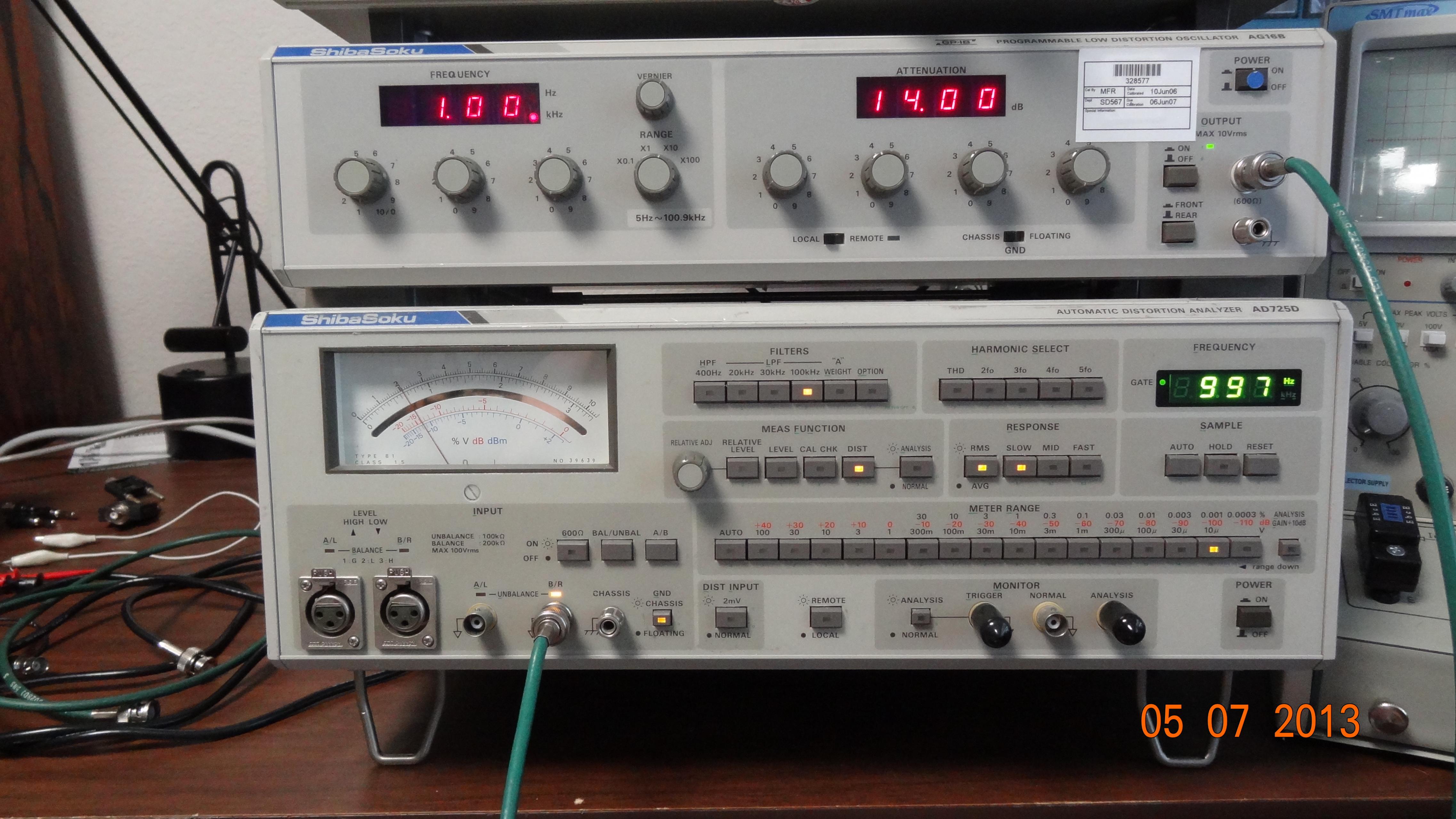

The THD+N of this second 339A runs .0008% (400-80KHz filtering) to 10KHz. The first 339A I was able to get below the noise level of the AD725 analyser but over a limited frequency range [ estimated to be -160dB). One additional area that helps me get so low is the coupling caps. I changed them all to bipolar type, placed back-to-back of highest quality and 105C rating.
The K-H 4400A uses similar topology and my notes say the 'tuned' THD is .0001% to .00025% (1-10KHz). However, the newer K-H 4402B departs for a better control circuitry and I can get THD of .00005 and .0001% from it. They both used the same osc opamp.
[I didnt record the THD+N on them.] I have tried many opamps and the 1468 always works best.

We can compare our progress with AP 2722 model - their THD+N spec is for 1KHz with a 22KHz BW and higher output level (2 volts): Both generator and analyzer are -112dB + 1 uV (typical -115).

Take a look at the 339 oscillator schematic I put up, you will see a cap (C47) across R50. This is probably for that HF harmonic reduction function. I will put a variable C in place of C47 and see what I can do with it to reduce THD at higher freqs.
