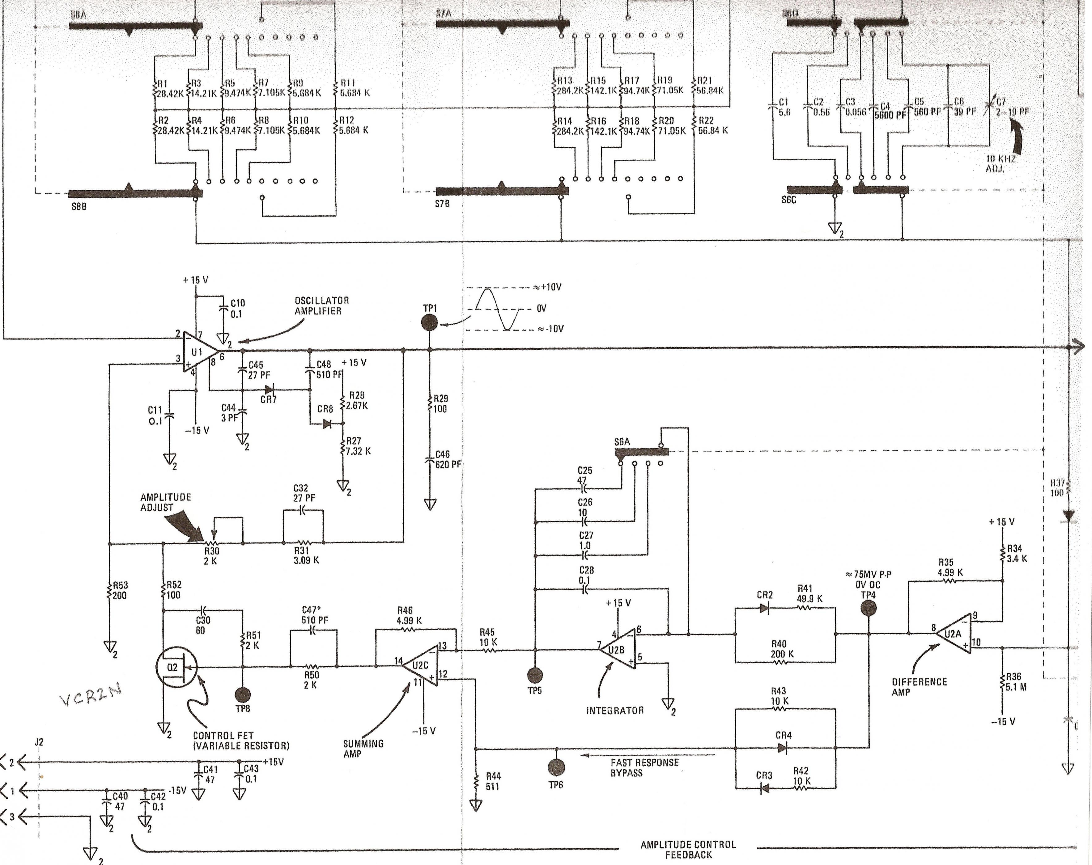

Hi Guys,
Where in an SVO is the best place to inject an external oscillator for frequency locking and at what attenuation?
Any suggestions on method of coupling? I want to include this in revision 2 of my SVO. There was some mention of "If injected in the right place." some time ago I think by Ed.

The best results come from adding it to the AGC summing junction. That should be two low pass filters away from the output. It takes very little to lock the system. The closer the frequency the less lock drive. I used transformer isolation to keep the grounds from adding hum loops. A shielded transformer would be even better but I used a cheap little thing.
"injection locking relies on non-linear interaction" Perhaps you can explain this more and why its important? It seems to work on really linear systems very well.
I think mean the summing junction of the inverter stage. Is this correct?
Of course this is also where the AGC is injected.

A common topology for oscillators is to include a jFET (Q2) control element. With these topologies, THD can be greatly reduced (esp. 2H) by adding 50% feedback from gate to drain. But, just placing twoequal value resistors as shown in the attachment (R50,51) doesnt reduce all the 2nd harmonic possible to reduce. Also, the series R50 with the gate creates some weak 3rd at >10Khz.
Further to THD reduction, just setting the gain control pot. (R30) to a +/- 20v p-p spec. doesnt guarantee lowest THD, either.
So, after replacing the oscillator amplifier (U1) with a lower noise and lower THD opamp (such as, the LT1486) I replace R50,51 and R30 with multi-turn trimmers and adjust them for lowest THD. First the R30 for a THD null. Then R51 for 2H at 100-1KHz and then R50 for lowest H3 at 10Khz. Keep doing this as they all interact and I get an additional 15-20dB reduction in distortion.
This has also been done on certain K-Hite osc models which use this topology with equallly good reductions. Note also that U2C output Z must be low and constant at all freq to get best results over large freq range; U2C output Z is in series with R50 and if its Zo changes, so will the harmonic null tuning.
Thx-RNMarsh
Thx-RNMarsh

@Richard Marsh -- my experience is that two multi-turn trimmers are not needed for R50 and R51 -- leaving one of them as-is and reducing the value of the other by a few hundred ohms and then putting one trimmer in series in order to swing the balance ratio of the two resistors above and below exact match will accomplish the same goals. I agree on the trimmer for R30 -- good idea.
The balance between R50 and R51 does not change the AGC input level at the JFET gate, they are not independent; rather their ratio only affects the feedback 2nd H cancellation. I found that optimizing the 2nd H reduction at 1kHz tended to make the 2nd at 10kHz worse and vice-versa, so selecting a value that optimizes both and living with the compromised result is to me a good strategy for the HP 339A.
