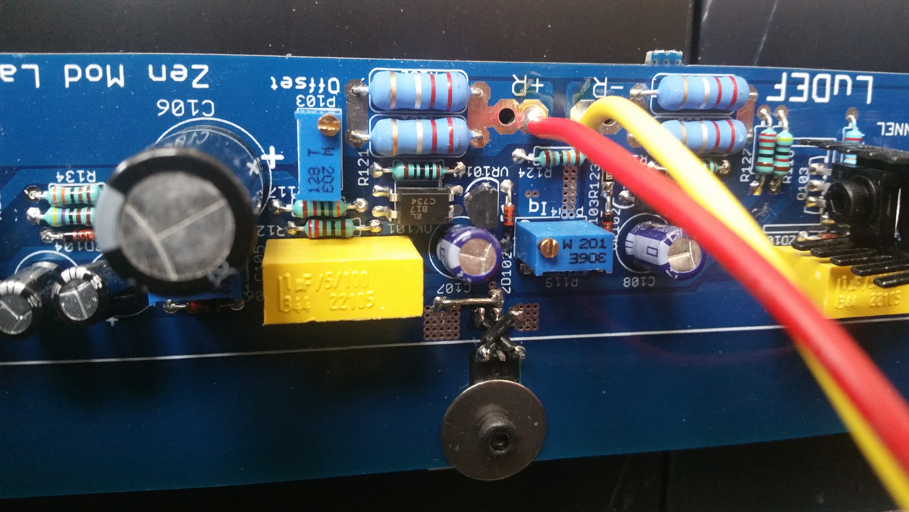

Thanks to Papa and Will (and Zenmod!) I've got a ZenMod LuDEF amp up and running!
The LU1014 is snuggled under the round metal washer. 🙂

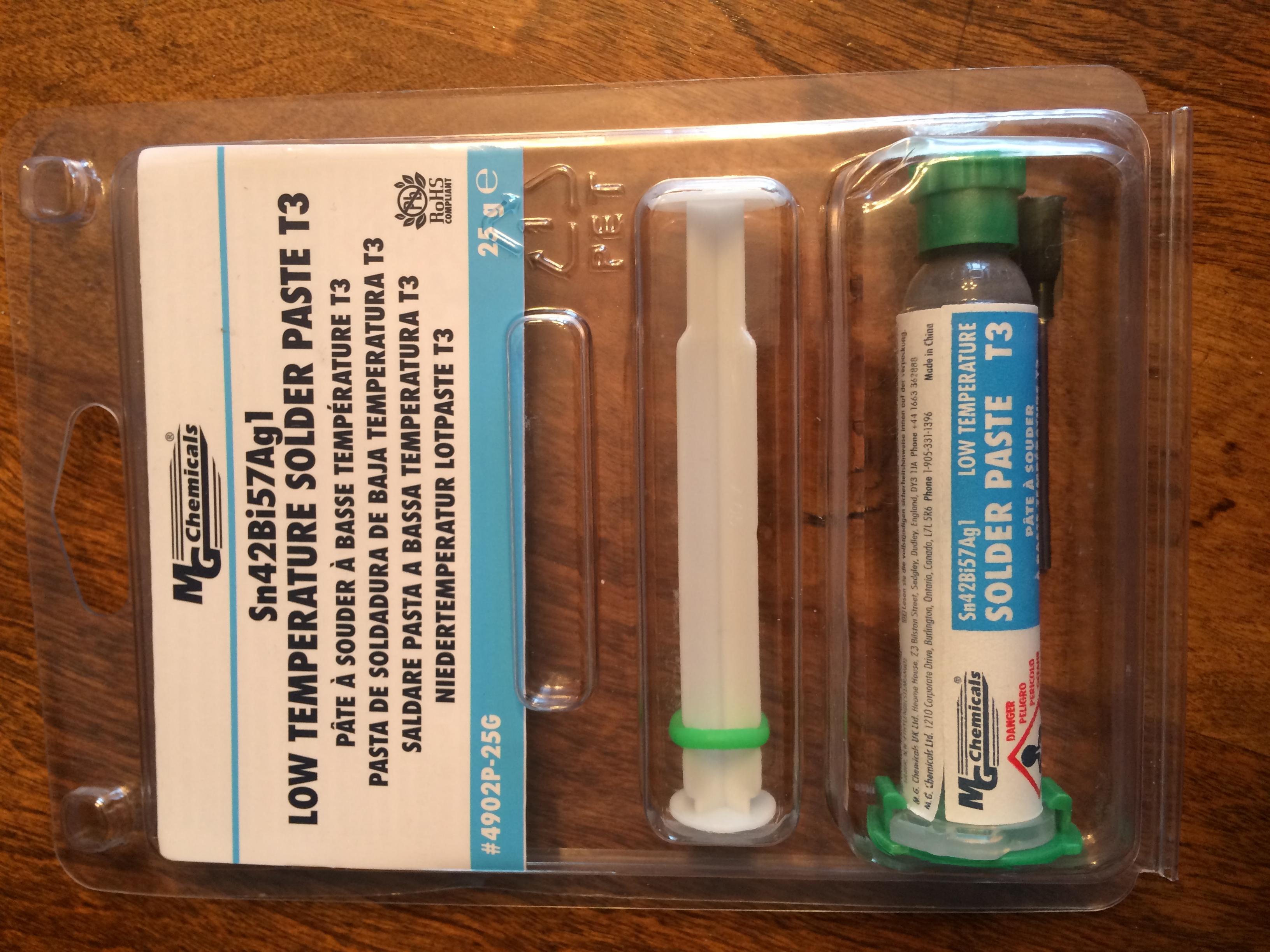

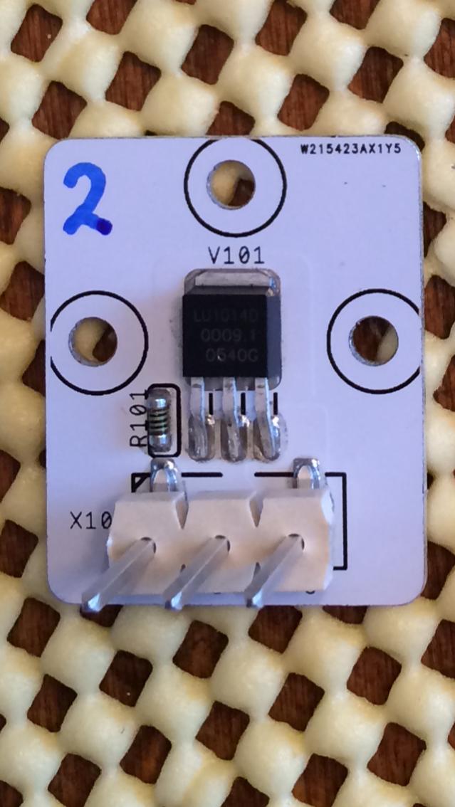

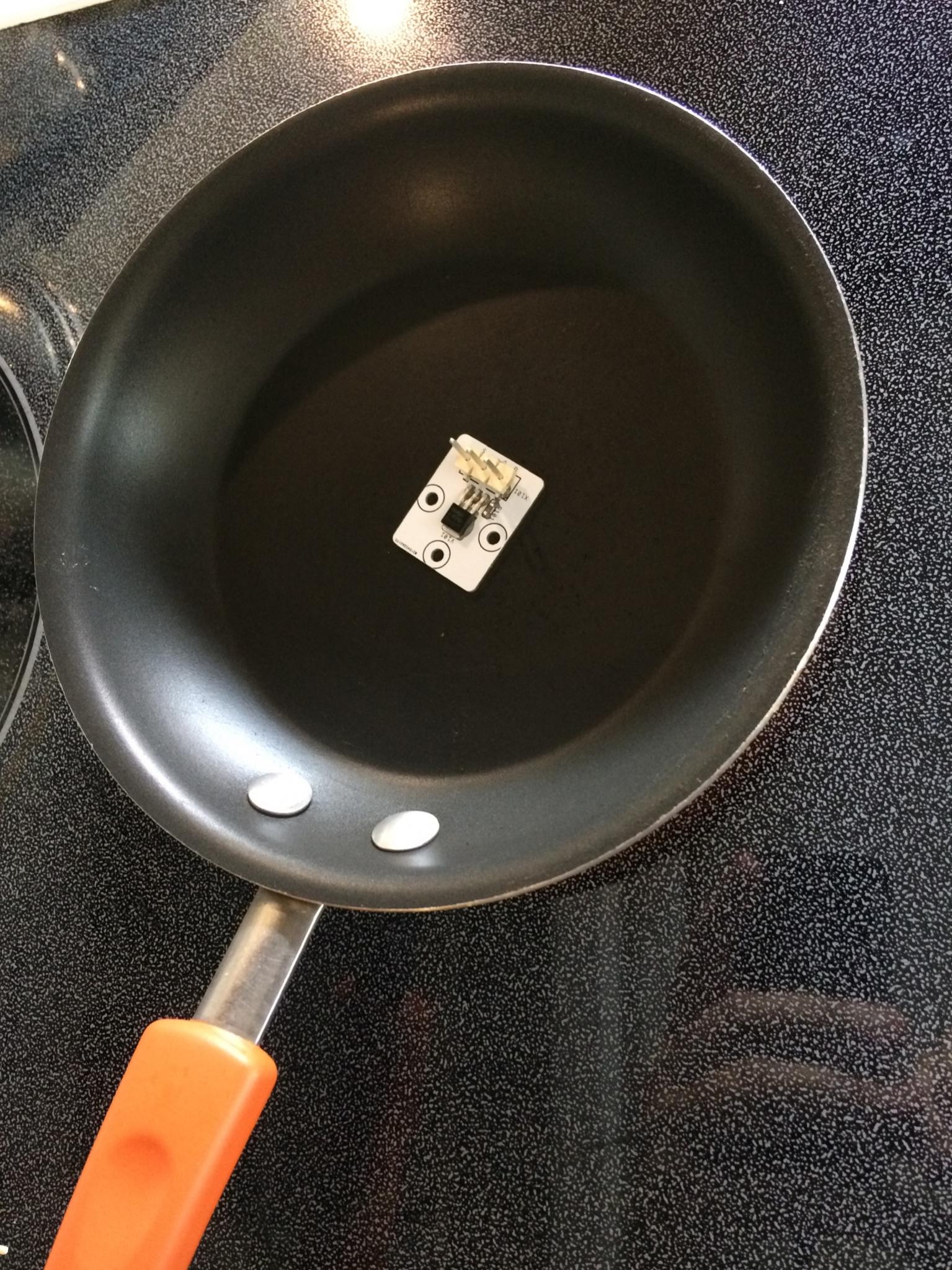

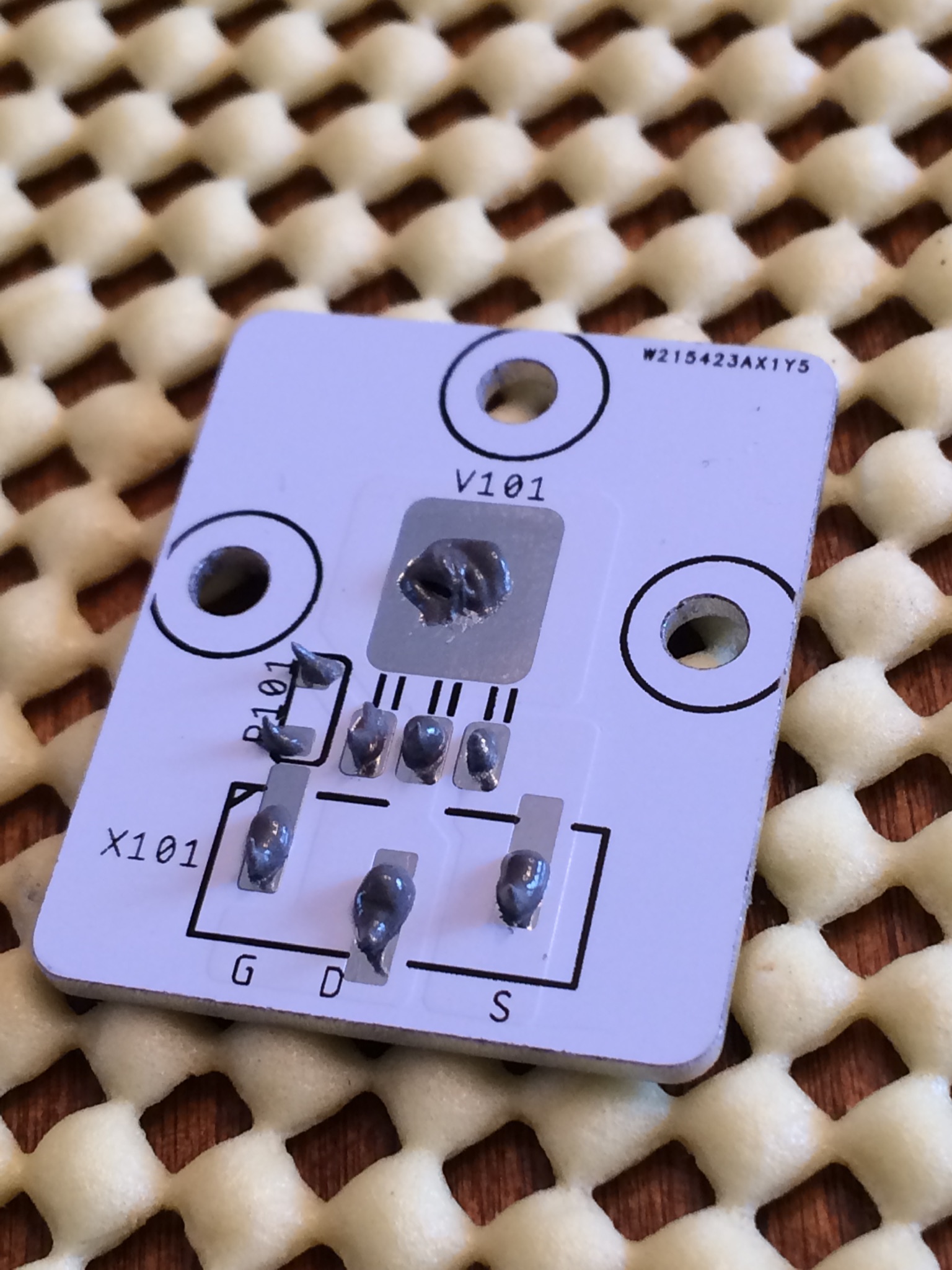

Hi
Well today I decided to try soldering the LU1014D on the adapter...first time didn’t go well but now it’s very easy. I would say the hardest part is to apply the right quantity of soldier paste to the adapter.
Solder paste I bought, goes very well;
Applying the paste...
Cooking a little (medium heat) not for long. Once you see the solder spreading under the LU1014 you’re almost done.
Final results pic.
So go ahead, have fun !
