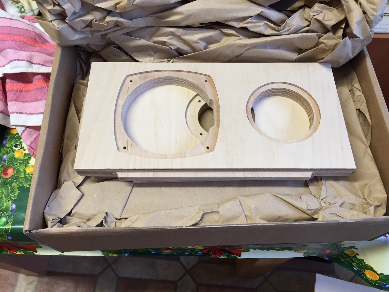

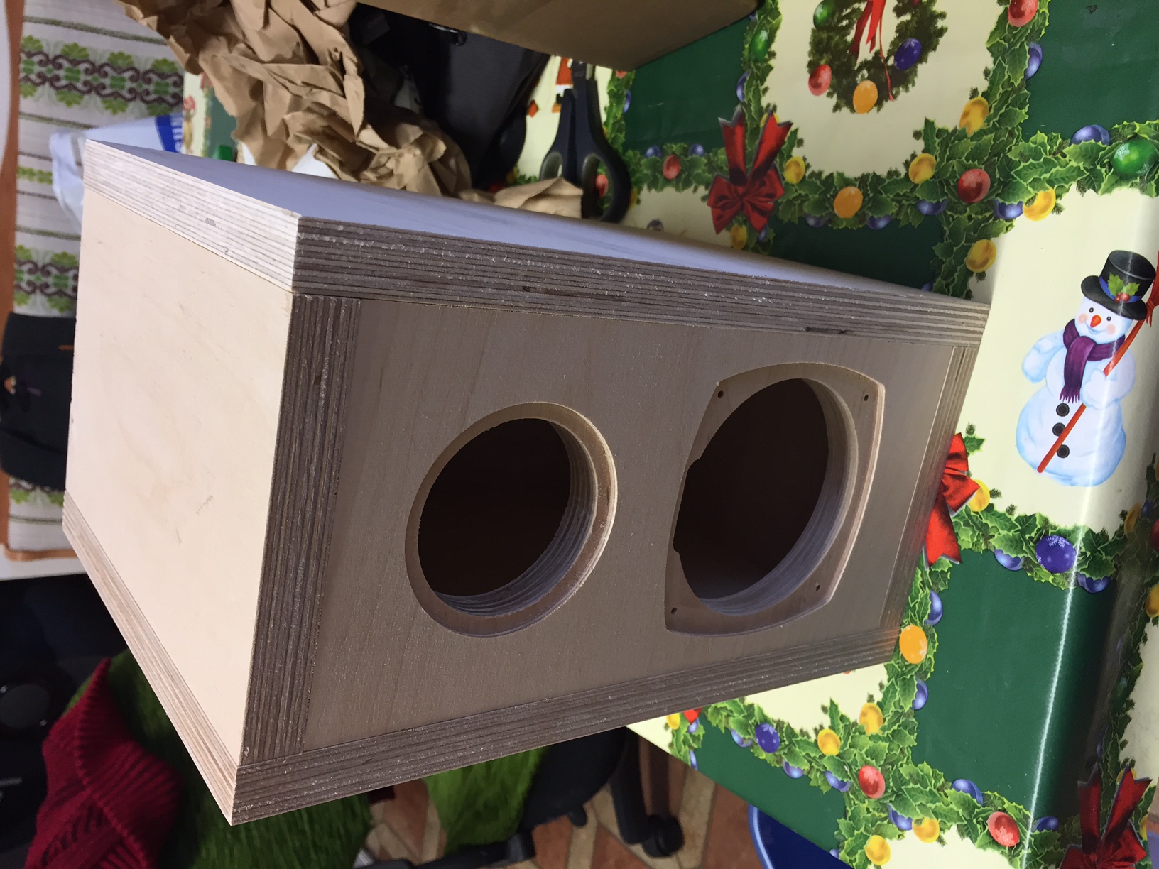

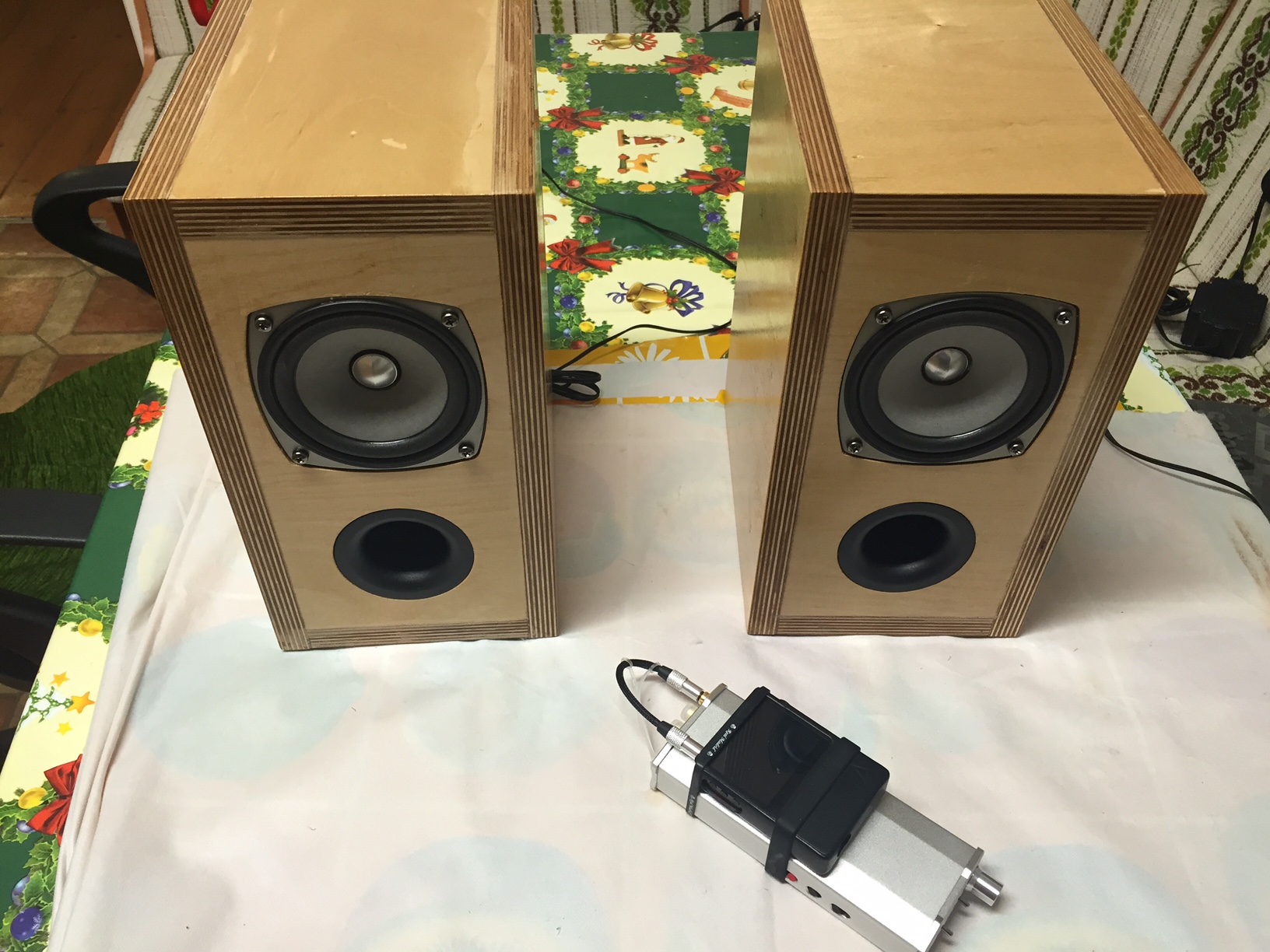

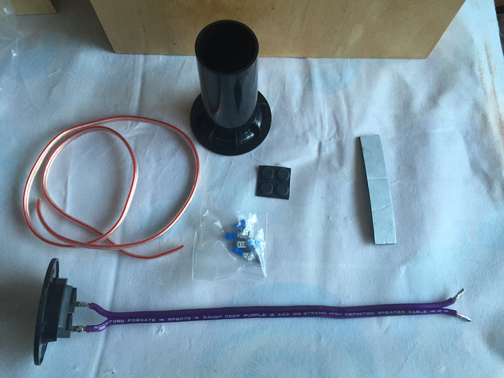

Fostex FF105WK bassreflex
I just finished my kit.
I enjoyed building very much.
The most time I spend by searching how to install damping inside. Picture should help me.
Sound is Excellent and natural. I was listen with open mouth. It plays 3D. The space is the best I heard. As there are no speakers-just music in the air. The bass is less, but is there some! Who needs more, so must use subwoofer. I have old active Creative subwoofer with integrated amp 2x8 watt. So I connected it. I can now mute subwoofer as I need and I do it so. Some old metal songs need more bass, so I just volume up the subwoofer. Warning - this speaker is directional. Off axe I miss trebles. The best is, when center of speaker is in height of my ears. So I will add stand. Super is, that speakers play music at ultra low volumes still perfect. It is very important, because I have them in office to O2DAC. I love it.
I will add some photos.

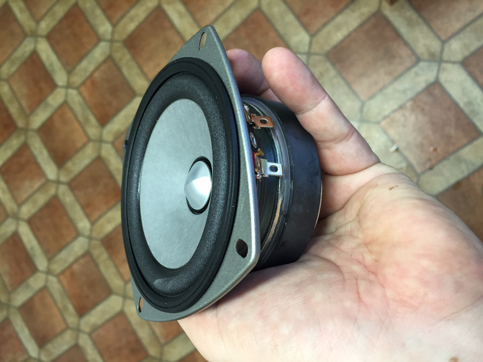

I just got some FF105WK's and they have a zinger of a 10dB narrow peak at 7.5kHz. The IR really has some ringing as a result. Sounds much better way off axis but on axis is kind of brutal. A nice looking and well built driver though.
