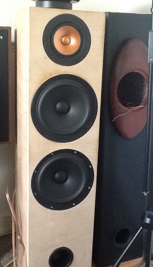

Playing with Fast myself at the moment, got distracted from building 3 way SB Acoustic, thought why not. Used my testing/abortion enclosure.
Requires a lot of work though, more volume for the woods, around 11 litres for the MA 10.3, testing experimenting with active crossing between 200 - 300 prefer the higher end at the moment.
Not sure yet to build proper box yet........ Fun though.

That is a darn nice looking box for testing. You must have pretty high standards for your "proper" speaker boxes. What are you using for woofers with the A10? My FAST setups have typically used 200Hz to 350Hz XO and I prefer the higher 350Hz. It really relieves the full range from moving much at all and really lowers harmonic distortion. I have found that in the sub 400Hz range even cheap $5 to $10 buyout woofers, in sufficient quantity, can sound good and measure very well.
You ain't seen the inside,I just cut the baffle off and try again. Shell is only cheap 12mm ply. Woofs are SB 23nrx ......for the price superb.
