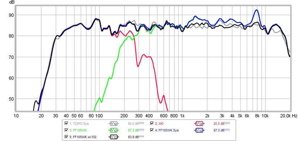

The FF105WK is indeed live sounding. Here is how it meausures in my FAST (XO at 225Hz) - a sealed spiral Nautaloss TL. The blue is without EQ and black is with EQ, to my ears sounds much more balanced. The EQ also got rid of the 7.5kHz ringing.

Very cool !🙂The FF105WK is indeed live sounding. Here is how it meausures in my FAST (XO at 225Hz) - a sealed spiral Nautaloss TL. The blue is without EQ and black is with EQ, to my ears sounds much more balanced. The EQ also got rid of the 7.5kHz ringing.

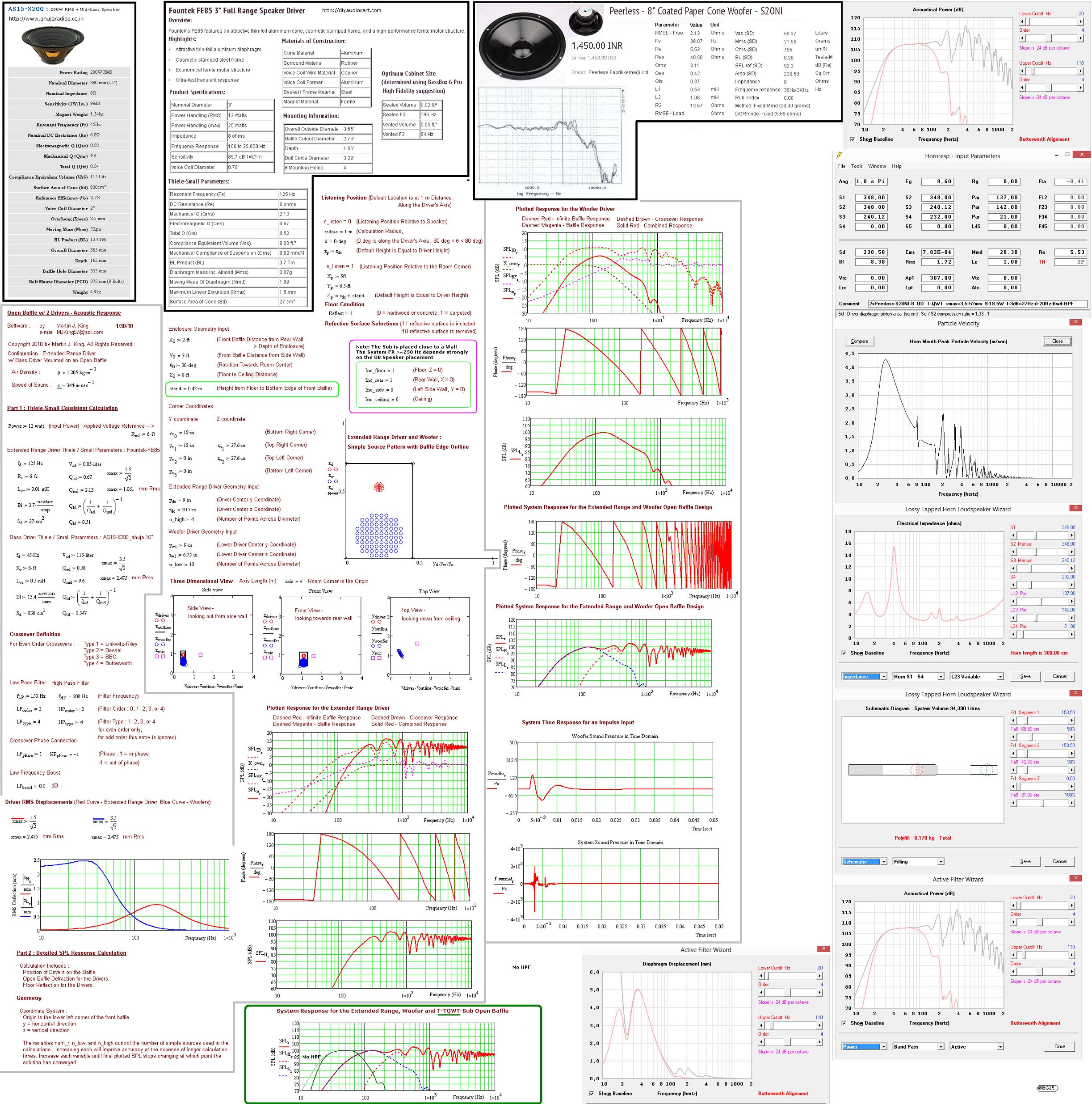

Hi All,
Here is an OB+Sub System attempt using Drivers from the mentioned Retailers in India.
The System BW and possible SPL is IMO OK for listening to Music..

Hi eljoantonyn,
No it's a 2.1 System where the size of the OB is ~W=46 cm x H=~70cm placed 42 cm above the floor.
Use a 12 dB/octave FAST arrangement for the OB's.
The T-TQWT should be folded by making the Total H=~104 cm W=~25 cm and D=~49 cm.
Hearing Localization Cues in your Room from such a Sub is minimal.
Place (hide) anywhere (at the rear,side or in the front) where the Box isn't showing visual attention but of course never too close to an OB.
