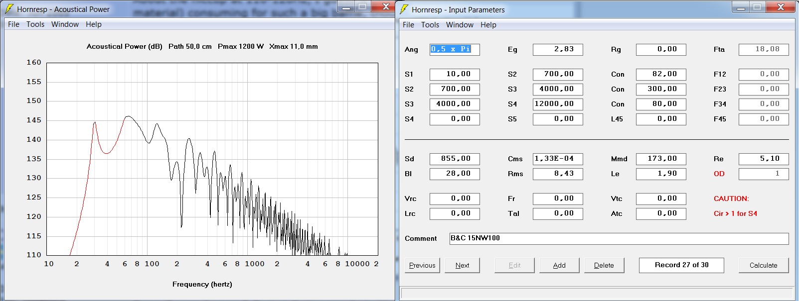

I've run some crude simulations in hornresp. They all show excursion-limited when I run Max SPL function. Even in many front loaded horns I've sim'ed (with sealed small rear chamber) are excursion-limited -- Xmax runs out before the thermal power limit.
So I'm sort of stunned seeing your BIB can take that much power.
Even if you choose 0,5 pi radiation angle in Hornresp, you will still not get the right response. I always guesstimate a last segment simulating the expansion one gets from the corner and all the way out to the outer edge of the actual box.
It will usually be something like 3000 cm2 to 15000 cm and 60 - 80 cm long section. With this section added, the simulated response will be much more similar to actual measured response.
