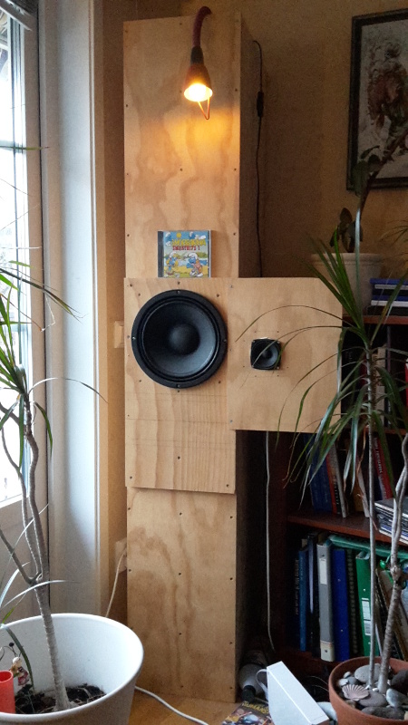

I am using B&C 10PS26 10 inch pro-drivers in BIBs with a Faital Pro 3 inch FL driver in a "FAST" system. Passive 6 dB/octave filters.
It sounds very powerful, clean and dynamic. Meshugga is a real treat on this system.
I can run my QSC RMX1450 to near clipping without any bad sound from the speakers, but the music can be heard several blocks away and everything in my house is pulsating with the very powerful bass.
The sound is very physical with a natural timbre to large instruments.
The best property is that similar to many large hornspeakers, it does not change character when turning down the volume. The bass is very effortless, clean and dynamic even at very low volume. Perfect for late night listening when my kids are sleeping.

hi Circlomanen - that B&C 10ps26 looks very capable and is bargain priced in the US - what are your BIB dimensions?
(I'm looking at 10fw64 for a little Karlson -- know anything about that one?) http://www.parts-express.com/bc-10fw64-10-professional-woofer-8-ohm--294-5930
Whoa! Must be awesome! Even 4" drivers sound big in BIBs the 10" must sound incredibly relaxed.
A 10PS26 pro driver in a BIB would indeed sound very big. How big is the BIB? Which Faital Pro driver is used for the tops? I like the 3FE22 and 3FE25.

At the moment I am driving my BIB with a single end 3 watt transconductance Triadtron amp.
Yes the bass is almighty powerful. I don't need a dedicated sub. I have a pretty decent response down to about 27 Hz and i can hear stuff in my house rattling at 22 Hz.
I have run 500 watt of bass (bridged QSC RMX1450) low-passed at 80 Hz into one of these, and it was painfully loud. The bass was clean, very big lifelike and dynamic. My whole house pulsates with the music and paintings jumped down from the walls.
They are 31 x 46 x 182 cm. Everything is built of 18 mm plywood and the baffle is two layers for a total of 36 mm.
The Faital Pro is 3FE20 (older version of 3FE22 with Nd magnets)
Cheer SPL is not everything, and I would not keep them despite my wifes protests if they did not deliver. I have built a large MLTL with Beyma 12P80Nd, but they don't come close. They sound so dull and lifeless compared to my BIBs that i have not found the time to build a stereo pair yet.
I do have two BIBs though, and i will keep them.
I can't really imagine building another pair of speaker for bass in any foreseeable future.
Build BIBs!
